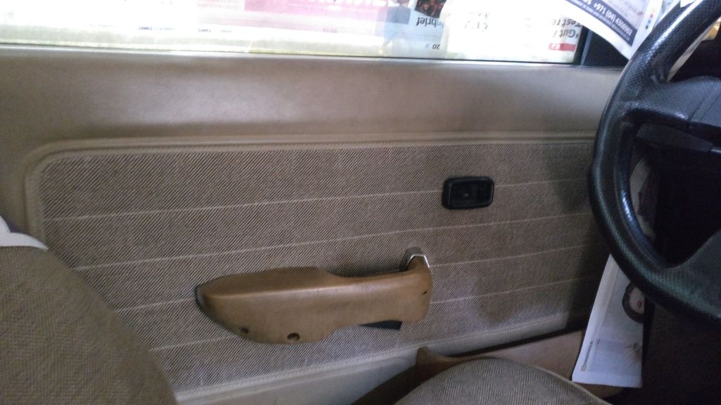

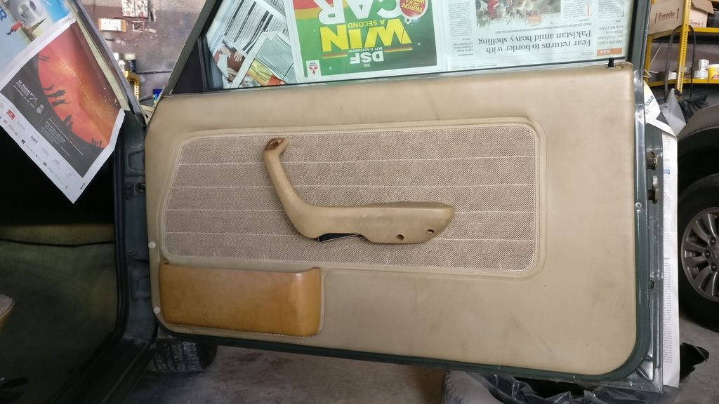

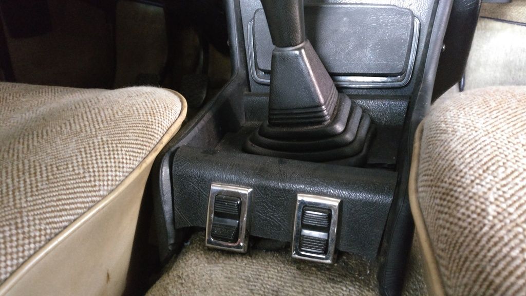

I thought I'll contribute this is how mine has been done.
