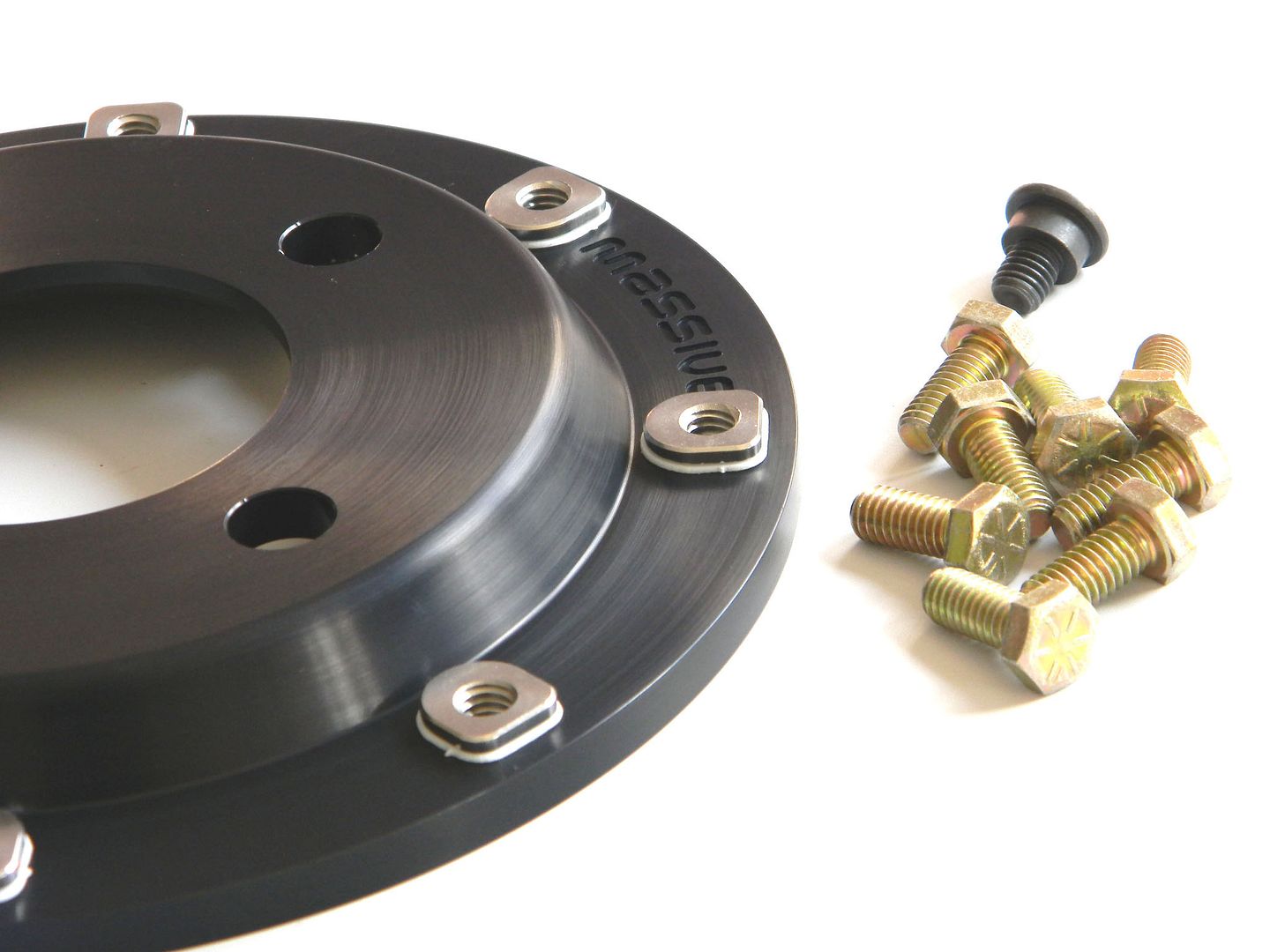

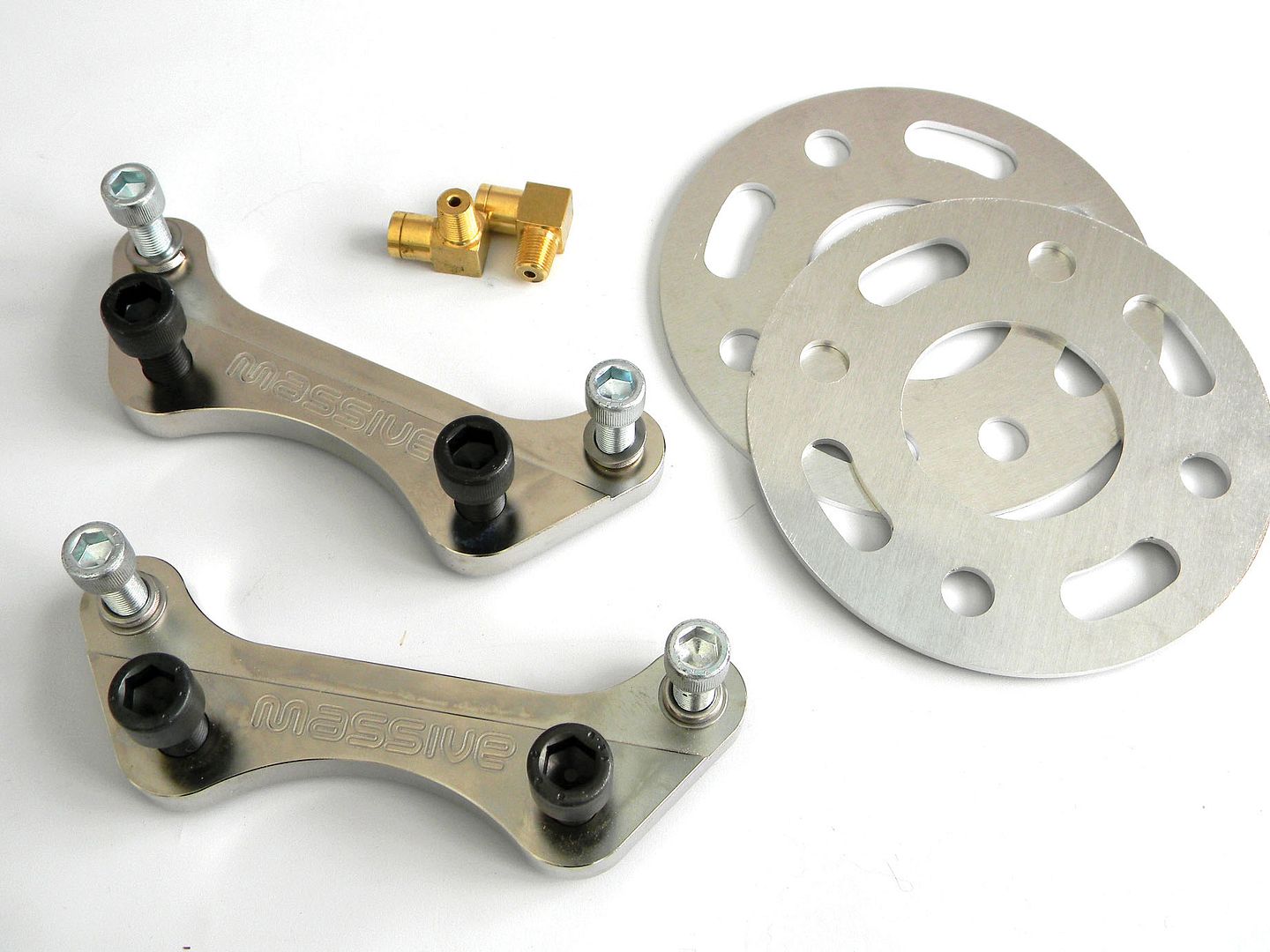

Just a quick incursion into this e30 brake thread. The 280x22mm kit shown in the first post is basically a VW Corrado G60 disc which had the 65mm center bore machined to 66mm. Plus Dynapro calipers and caliper adapters. You will need a thin 1/16" (1.5mm) thick wheel spacer as the VW hats are 1mm thinner at the hat (bell) an the portruding rotor hub might be too wide for many wheels. Kit fits 15" BMW/BBS wheels. VW rotors can be had for cheap.
If you want to go all out, you can also get two-piece floating 300x22mm, 300x32mm as well as 332x32mm discs on your e30...
