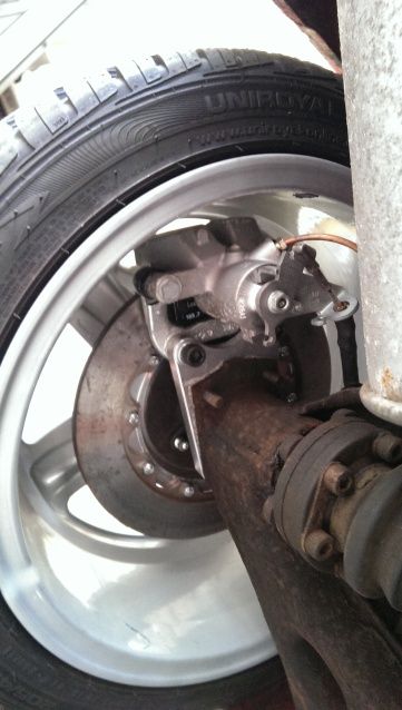

Ok, but if I were to go that route then I would still have the rear drum brakes. Is there a simple way to convert to rear disc brakes without having to change the rear trailing arms? It'll likely be difficult for me to find a set of those trailing arms here in Canada.nas80 wrote:People chop in the center part of the e30 axle. Check propan's thread in the owners section.
Jason put an e12 axle in using the arms and ended up meaning that the track was a lot wider. So he put custom arches on.
Good luck and welcome
Re: E28 rear end swap and 5 lug front suspension questions
I have a an e21 here that had drums type of rear arm which has been converted to disk. The caliper has a handbrake function. It's a fairly simple design

So you have an adapter that bolts into the trailing arm? Is that something you made or a kit available from somewhere?
It's just a flat piece of metal.

Details on the Caliper used?nas80 wrote:It's just a flat piece of metal.
Looks like it was off a vw? It's not my car.
