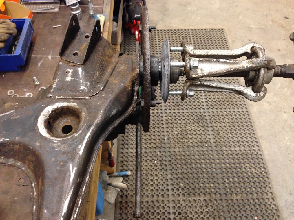

So got on with moving the bearing and driveflange over from the rusted trailing arm to the new one........
Rust holes in the old one:
Pulling off the flange:
Driving it out:
All out:
This is where the fun stopped. Stopped taking photos too it seems.. Turns our my new trailing arm is different to my old one! The outward facing bearing is larger than the inward facing bearing :(
Bloody annoying - never picked up on that there are different types.

Bummer! Didn't know that either but it appears that all 320's as well as the 323i have a different setup with two different bearings indeed.

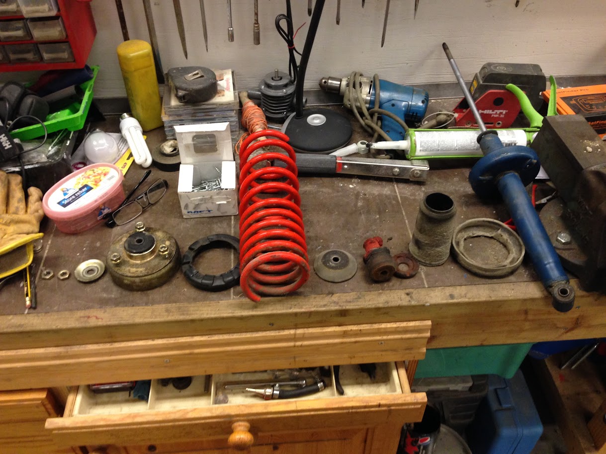

Front struts with new shocks, springs, rubbers and top mounts assembled:
After everything is fitted there seems to be a little play in the top mounts - normal?
Posts: 25866
Re: 1978 318 Pastellblau - Norway
Post by Jeroen » Fri Jan 09, 2015 10:02 am
Nope, there should be no freeplay on the top mounts as they will produce a loud metal to metal knocking sound once installed. You need to check what the cause is: wrongly installed or freeplay on the bearing. Where did you get the top mounts from?

Ahhh they sell Meyle I see. Sadly that is the cheapest Chinese cr@p available on the market today so that may be your issue.

Crap. Yes they are meyle. Didn't know they weren't good quality.. The bmw ones where so expensive here (€190 for a pair) so I got these. Guess I'll take another look at the ones I have and see how bad they are..
Posts: 25866
Post by Jeroen » Fri Jan 09, 2015 11:58 am
If the old ones aren't dried out to bits and there's no freeplay on those bearings perhaps these are better. But check out what the actual cause is, first!
