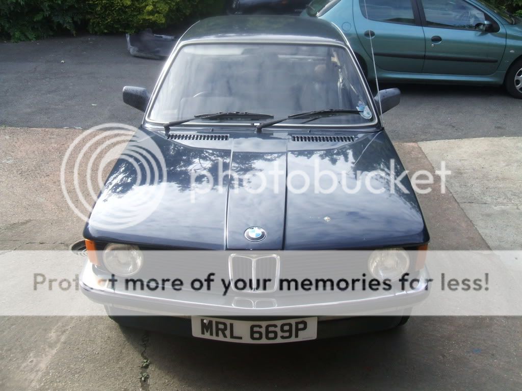

Currently being prepared for Classic Rallying. Lots to do still, and lots to learn!!

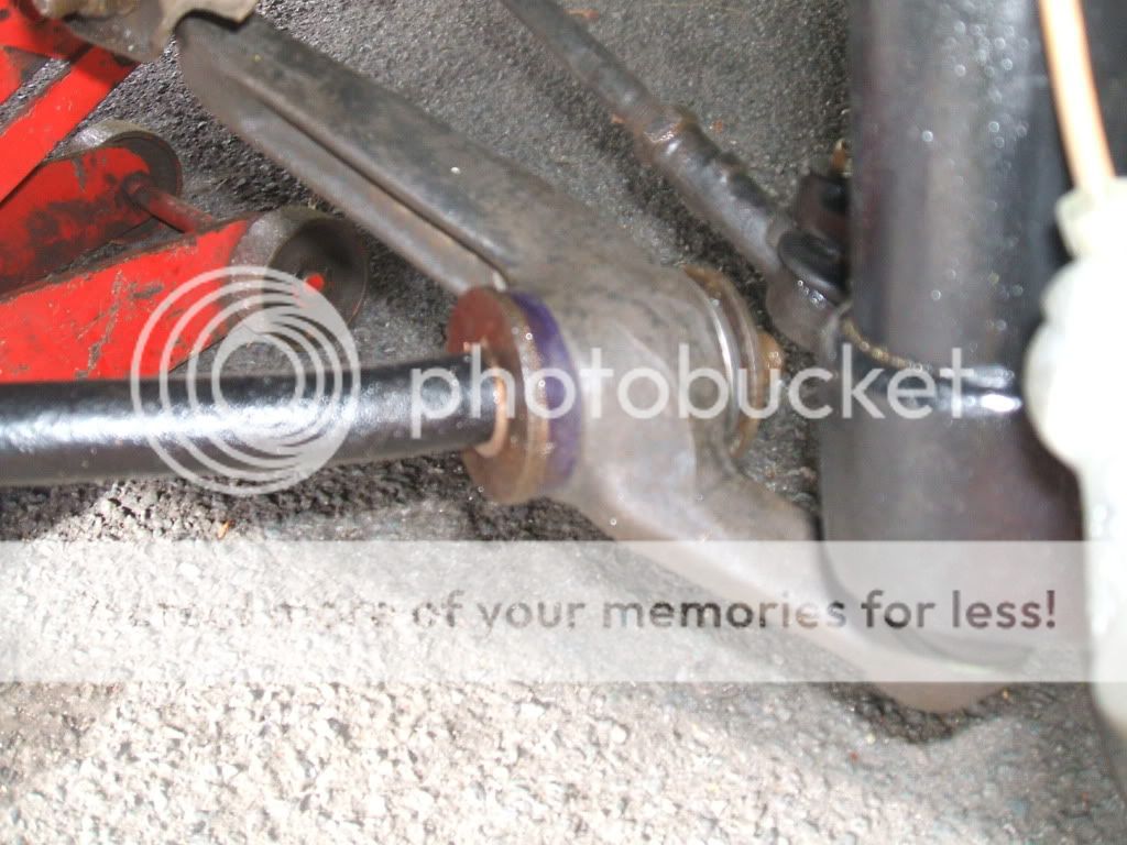

Front suspension. Bilstein sports. Poly bushes. Quick rack. 323i vented discs. Uprated springs.

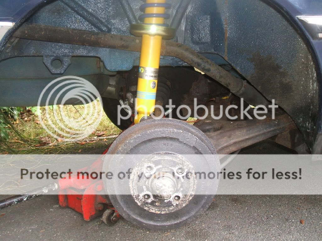

Rear Bilstein Sports 2 1/4" springs. Polybushes. Solid beam mounts

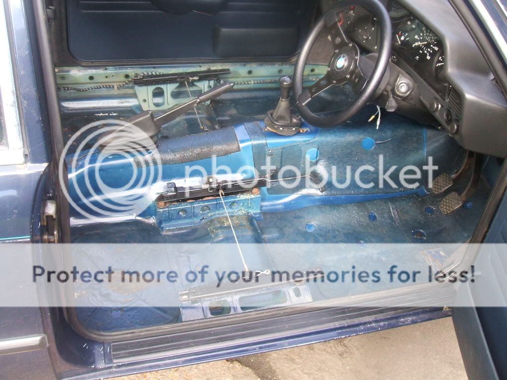

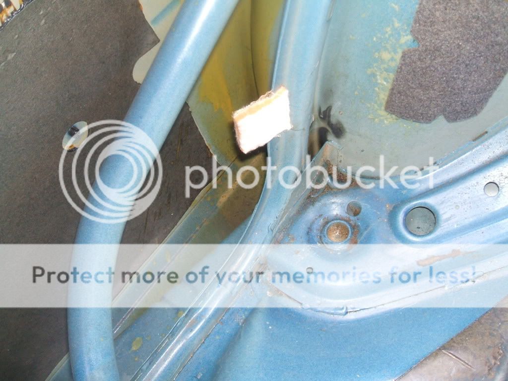

Fuel and brake lines inside. It's a nice clean strong shell. Looks like it was rustproofed from new.

Corbeau GTS seats on E21 runners. A right pain to fit at the correct height.

do you have to run a roll cage?
Don't have to, no. I'm pricing a Saftey Devices rear cage with a removeable diagonal at the moment. That will have to wait until I've sorted the suspension and a thousand and one other jobs.

Markw wrote:Image
why are your bushings purple? wich brand are they? are they new?

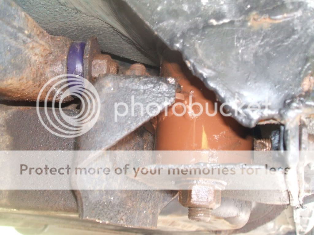

Bushes on the rear trailing arms are off the shelf Superflex ones. Rear beam mounts are homemade from nylon, so have some 'give'. (Not much!)
There seems to be bugger all available for the front though, so I've had to turn these from bar material supplied by Superflex. It's bloody expensive and there's lots of waste. Outer TCA/ roll bar mounts are stock new BMW parts with machined up Superflex material to fill the 'void'. You can't really make these too solid as there needs to be some compliance because of the geometry of the front end. Inner TCAs are also machined from bar stock.
