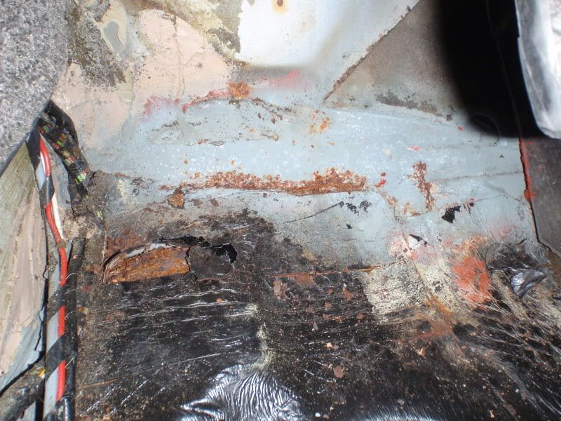

Fast forward to May 8th 2011

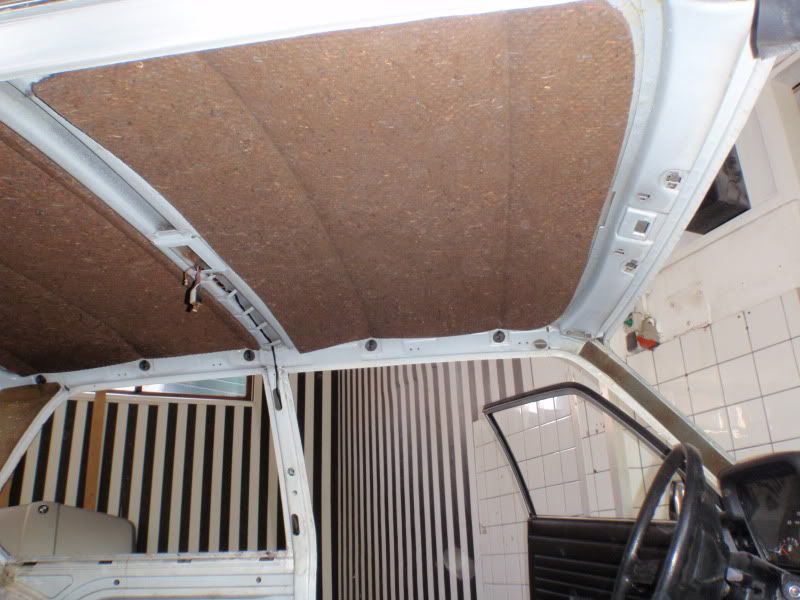

I took out the complete interior exept for the dash. So out with the seats, rooflining, carpet and doorcards. As far as I can see right now:
- Solid wheelhouses at the rear
- Solid floor, except for one spot in the front
- Two cover sills, just welded over the rust :hammer
- Lots of bad repairs, some still just zinc sprayed :hammer
- Bad paintjob and restoration, I even found some masking tape painted Polaris :hammer
- Even the vinyl A style covers have been painted :hammer :hammer

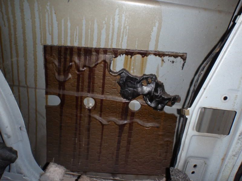

- Insolation carpet is wet due to the hole in the floor
- Massive loads of glue is used to put the insolation in
- The carpet has decolored
- I will cut off a perfectly good roof!

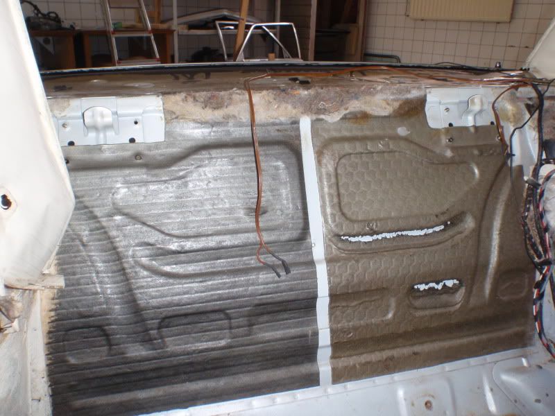

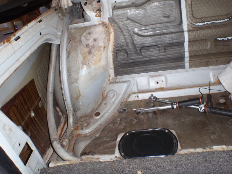

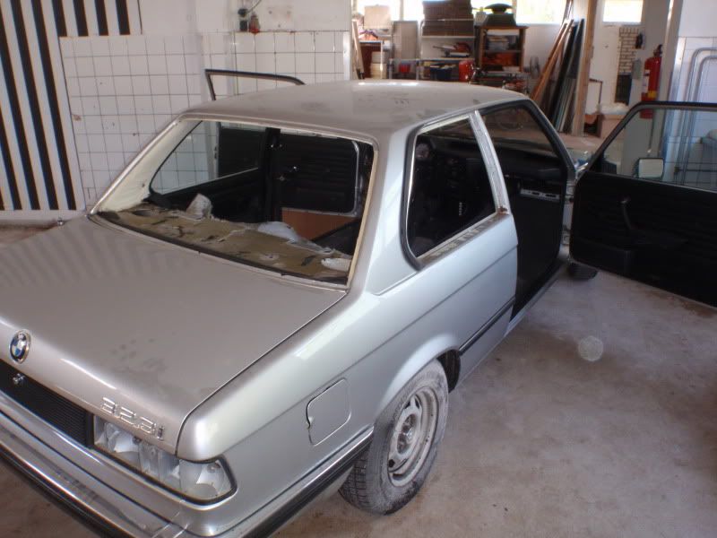

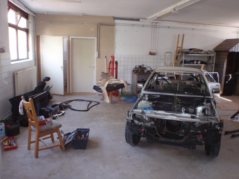

E21 without windows or interior:
Rear at the right

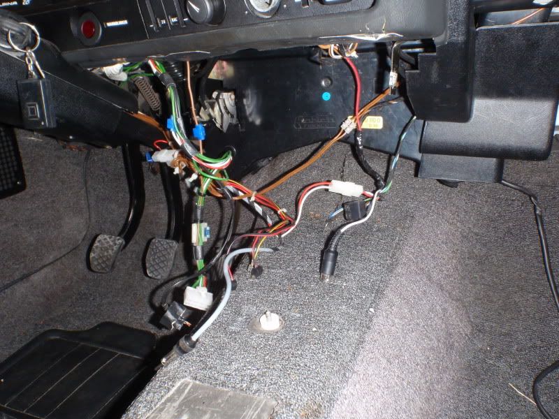

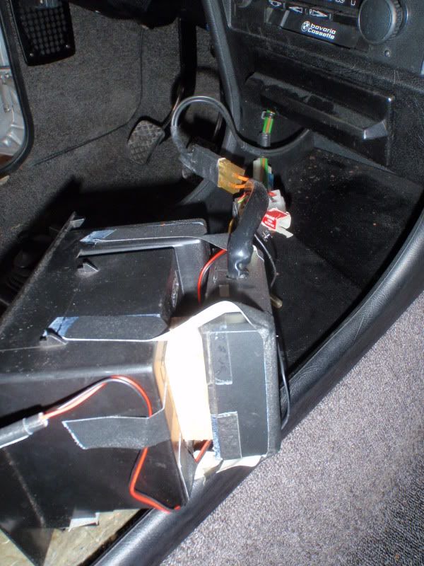

Radio, wit hall kinds of aftermarket alarm wiring and some wood?!?
Screwed up wiring harnass
Fainted carpet
Left rear panel, insolation made to hot…
Rear left, rust on the corner.

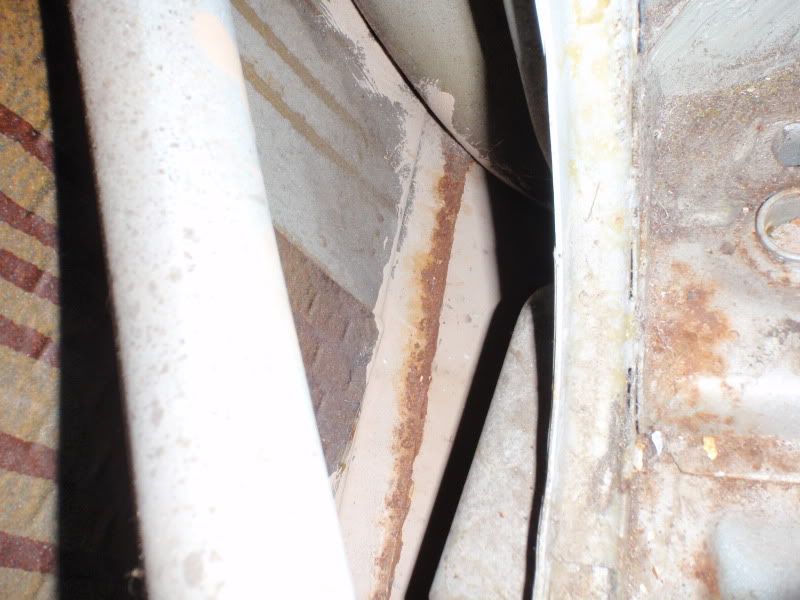

Repaired rustdamage, just in the zincspray, not even repaired correct.
Cutting edge behind the coversill rusts like hell. Thinking of just cutting it all out.
Beautifull roof: anyone?
Front left side. I’m afraid of what underneath the insulation.

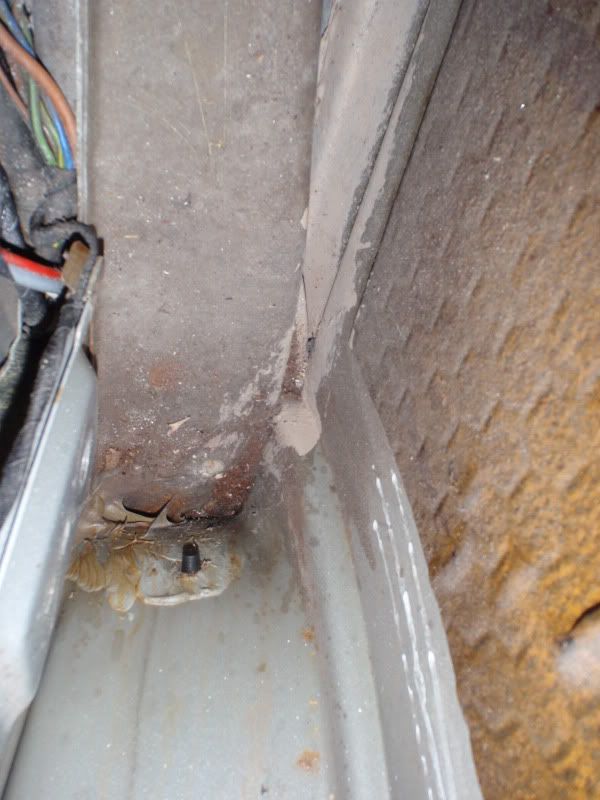

Upperside of the jacksupport, all rotten!
Very bad paint job. If you are a car painter and you work like this, then you have no honor in your job…

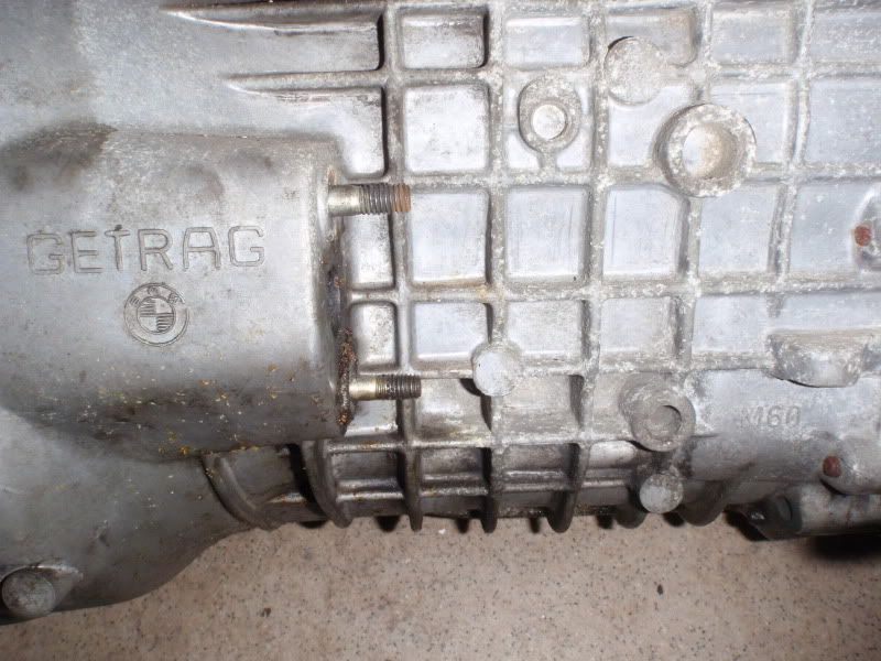

Re: Uwbuurman: 1978 323i polaris

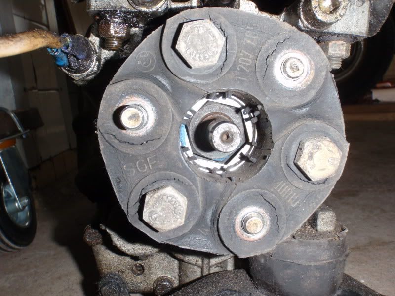

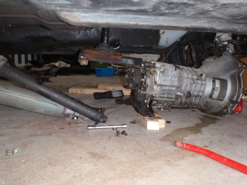

Took off the gearbox with driveshaft still attached
The disc is all worn out and needs to be replaced.

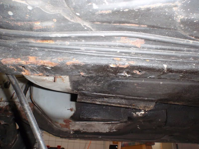

After taking of the driveshaft, the exhaust could be removed. And thet the fueltanks. I’ve just cutoff the lines.
Conclusions for the day:
- Rear wheelarches are repaired and already rotten again

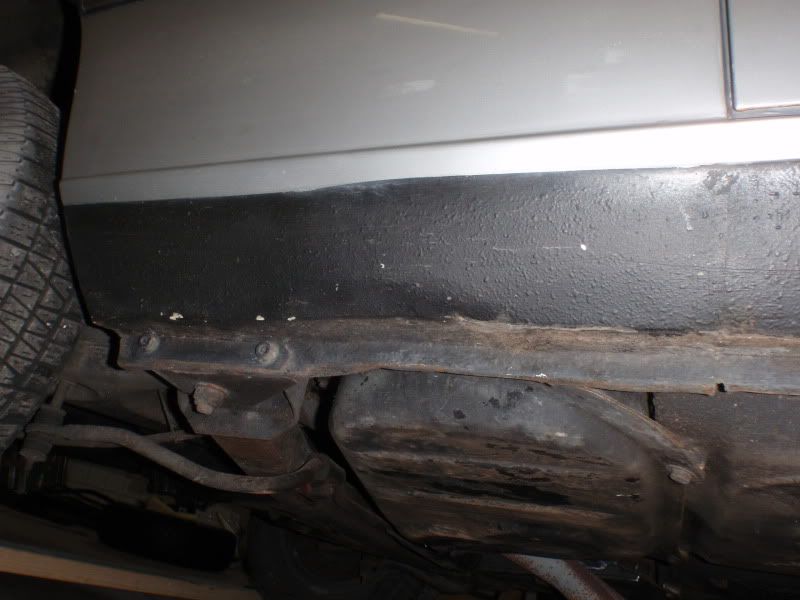

- Nice old dent in the right sill
- supportbeam left is severly damaged and probably needs replacing.
- hardydisc is shot
- supportbearing on driveshaft makes a lot of noise
- fuellines ar done for.
- dents in de the floor.
Work that needs tob e done soon: Take out the dash, powersteering, wiringharnass, wipers. And then the subframes and after that… hopefully she’ll be on the frame, so I can start on “rustoring” the bitch.
Some pic’s:

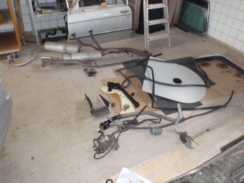

Fuel tanks
Dented outr sill ):
Two fuellines, one brake line, one dent

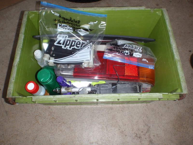

Stuff from the boot
BMW getrag M60 gearbox, in this case a doglegbox.
Labeling in progress
And for now the last pic.

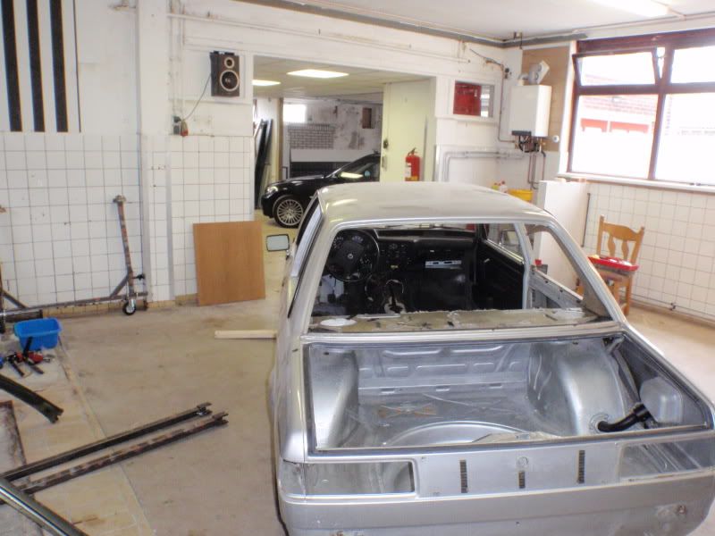

Posts: 19275

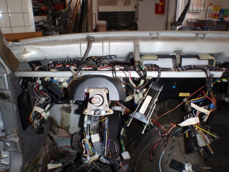

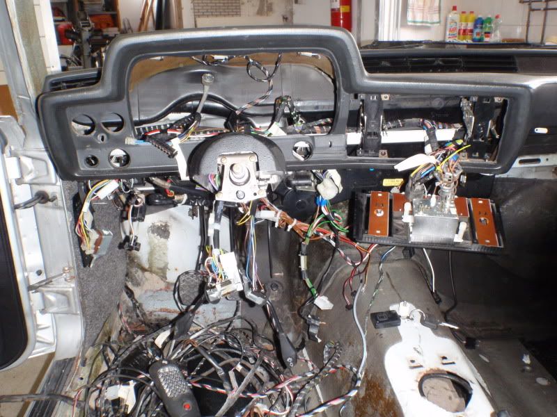

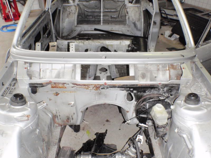

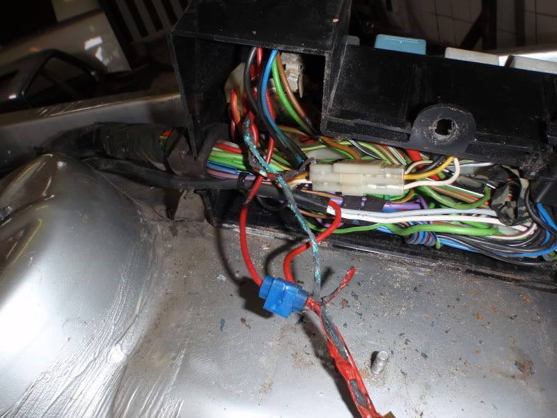

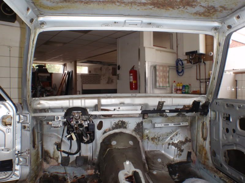

June 17th 2011, today I took out the das hand the complete wiringharnass. And other exploring trip back into 33 years of just f*** up an e21.
Dash was easy to remove. This one is full of cracks, but a “new” one is waiting.
Lots of wires
Dash removed, As it turns out, half of the wires dont belong in this wiring harnas. I see some wrong attached spreakerwires, some old alarm wires and a bunch of what ever the are wires. Some justed taped in, some with cable connetors and some soldered in. It’s a freakin’ mess!
And what do you get if you don’t kow electrics and just start fiddling aroud? You almost torch the damn car! Look and see whats underneed the fusebox.
Wiring out, heater out.
Tomorrow, the breaksystem and steeringcolumn will be taken out.

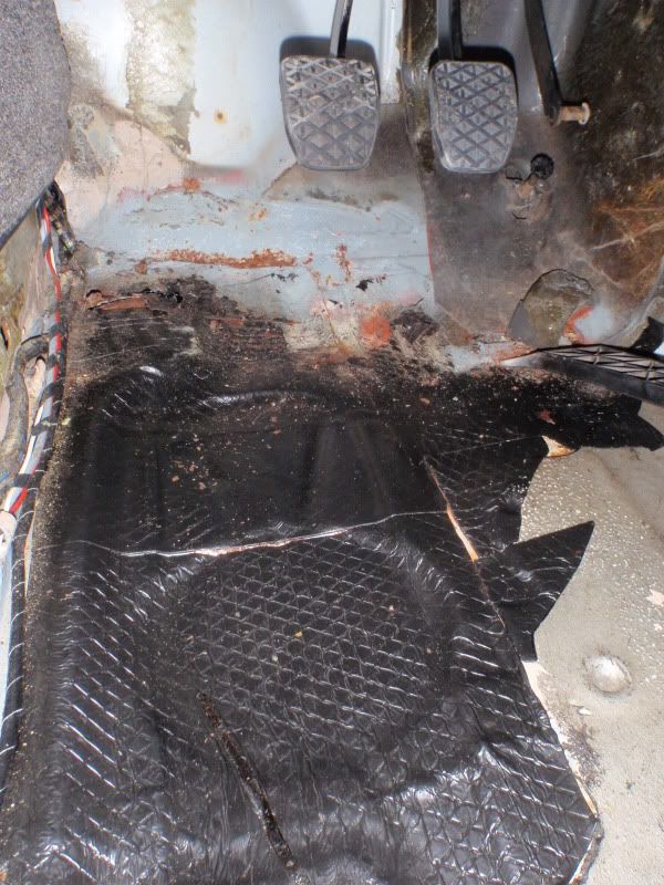

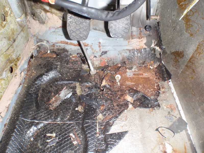

And here are the results from the floorpanel jury. RUSTED AND ROTTEN! Zero points.

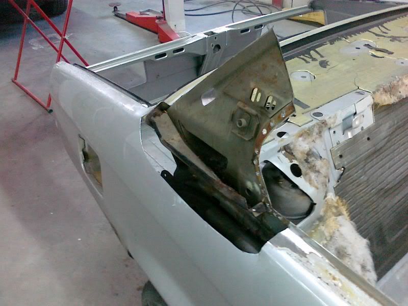

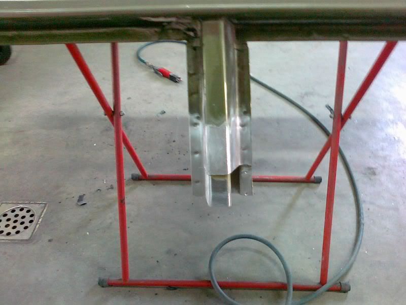

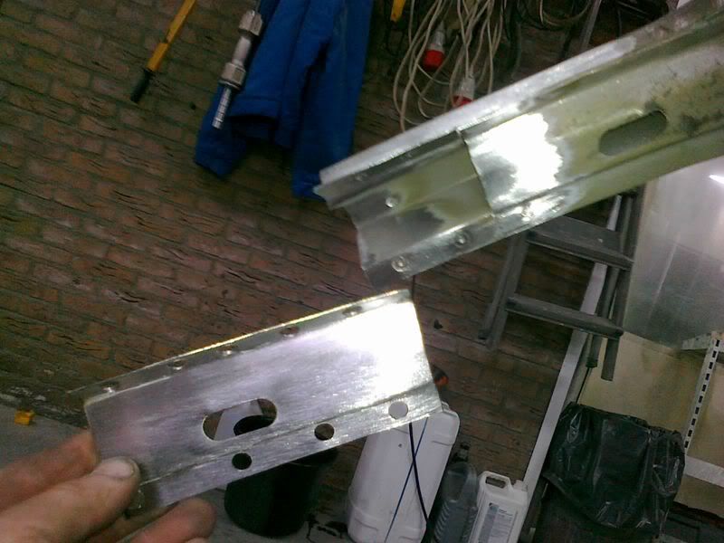

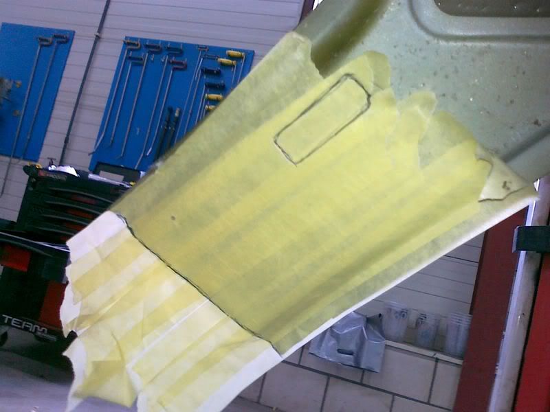

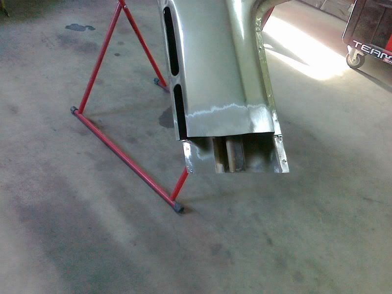

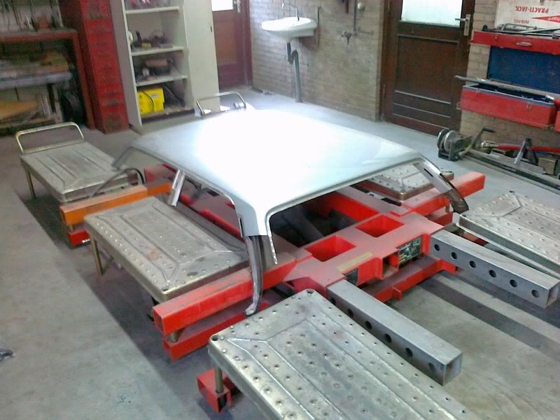

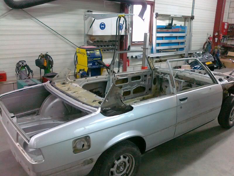

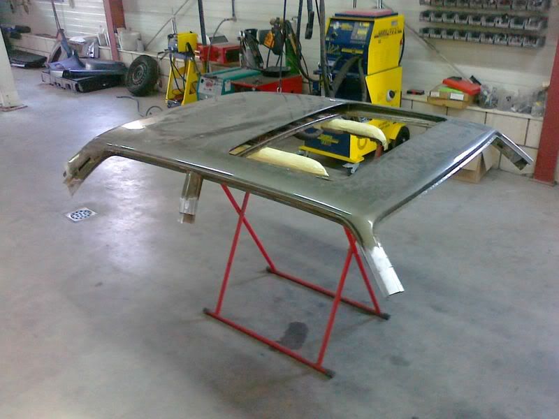

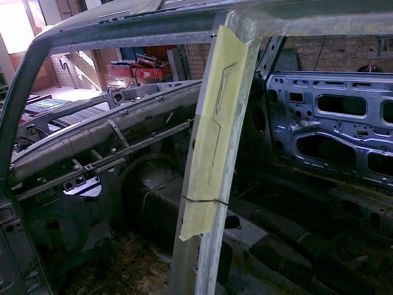

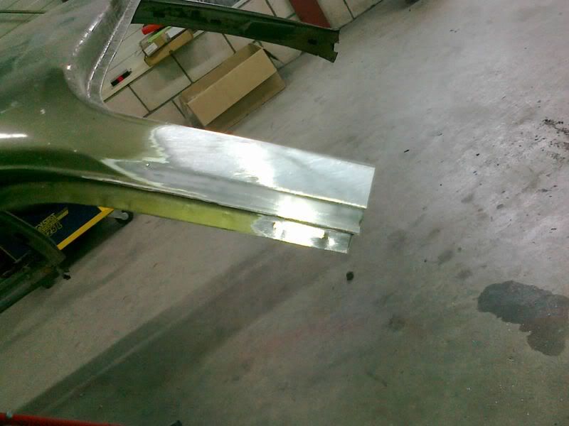

June 29th 2011: We started on doing a roof!:shake :shake :cheers
All pillars shortend
Made a litthe hatch for the inside
At the B-pillar the side panel covers it all, so here on the outside the little hatch
C-pillar prepped

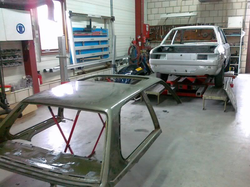

And the roof is ready. Tomorrow he car.

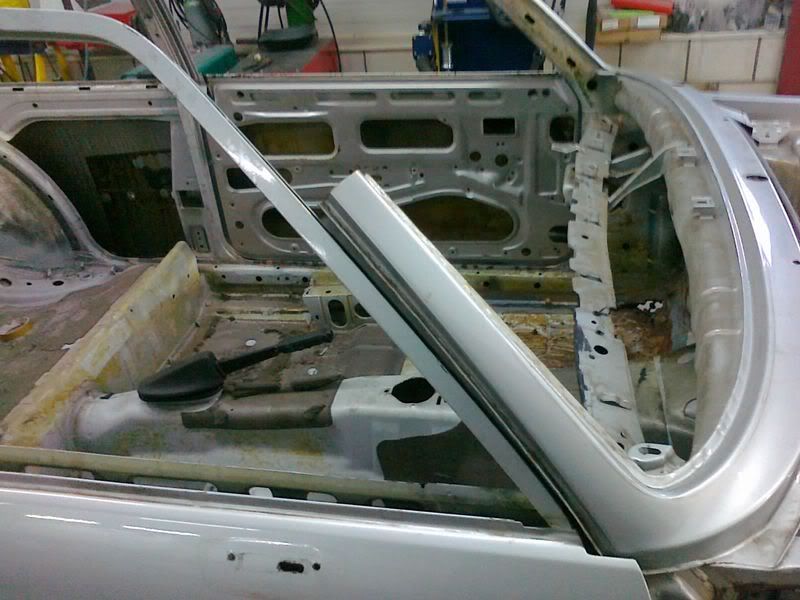

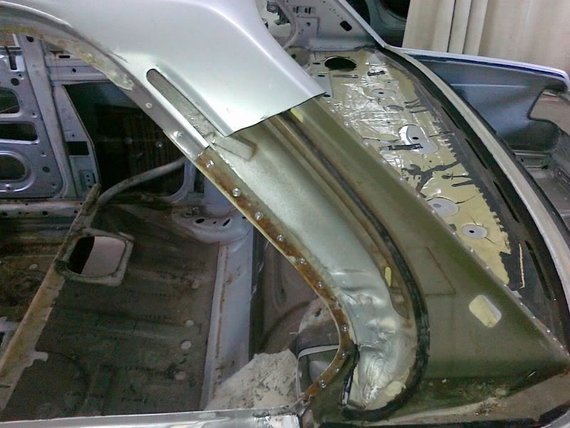

Posts: 19275

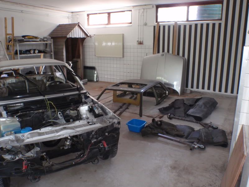

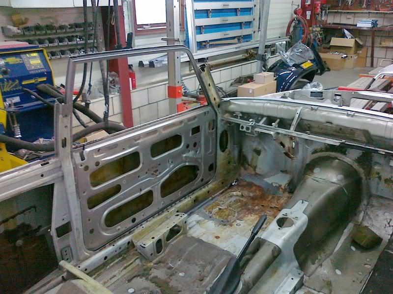

And my bimmer is a cabriolet!!!! :cheers

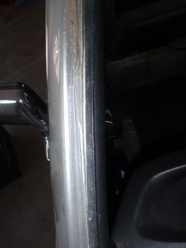

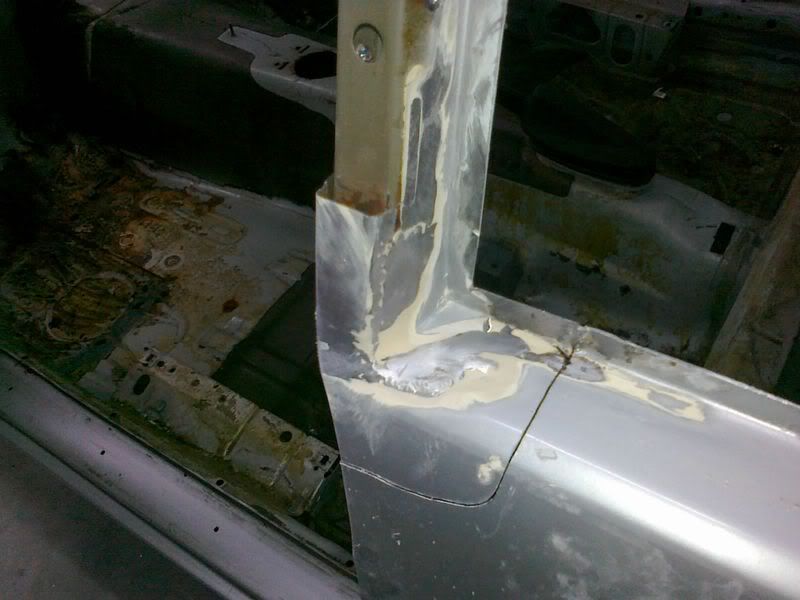

In search of rust we find lots of filler :nah :hammer
Pillars cut to size
This is how we take the measures
And how we transfer them on to the car
And it’s a cabrio
Roof for sale!!
Saturday we’ll continue
Readers who pay real good attention, have seen that more than only the roof will be changed… :innocent
