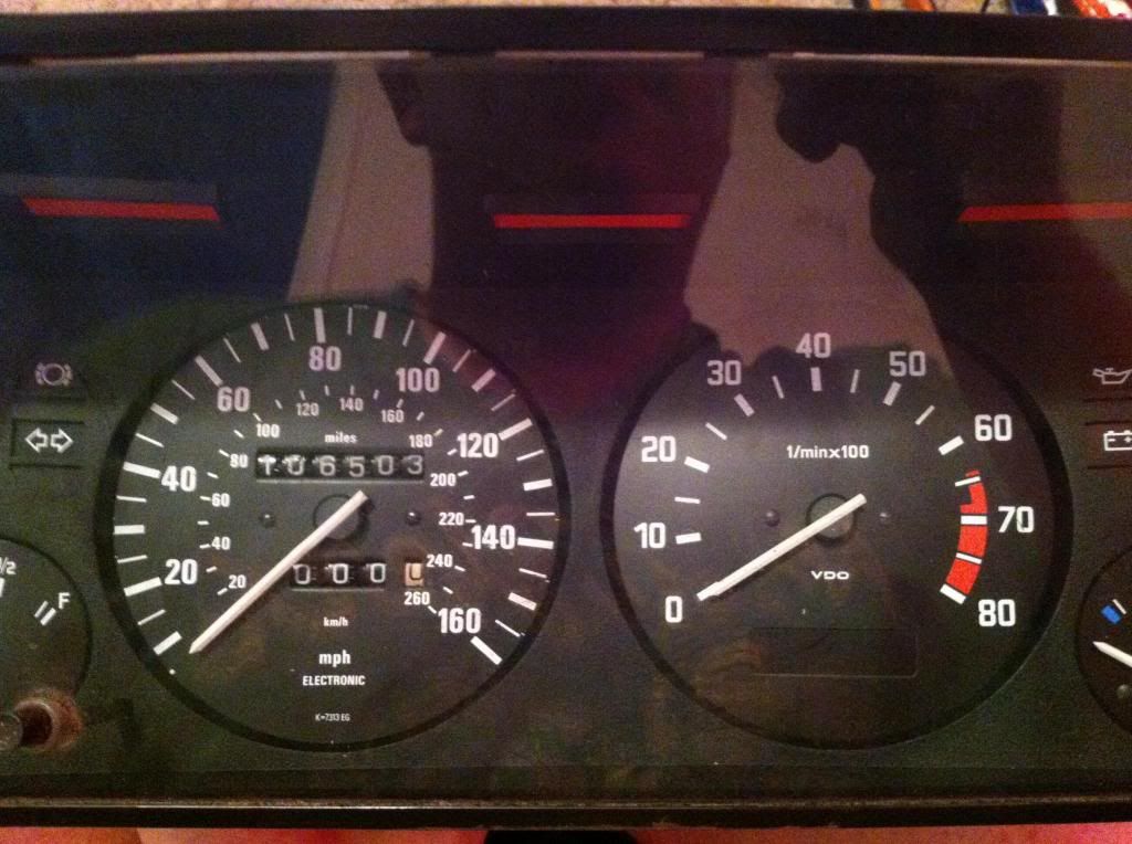

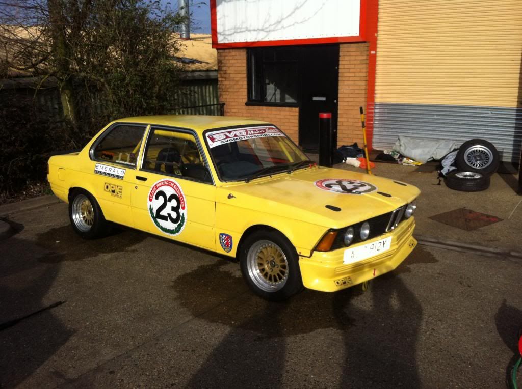

Not posted on my own thread for a little while, just before the castle combe meet the car got a yellow roof again:
And this weekend I started on the speedo mods, I think the E24 dial fits quite well (good enough for a race car anyway :thumbsup ):
Chopper wheel is being made for me, so will fit that when it arrives. Then it will just need to mount the E30 diff sensor and wire it all up.

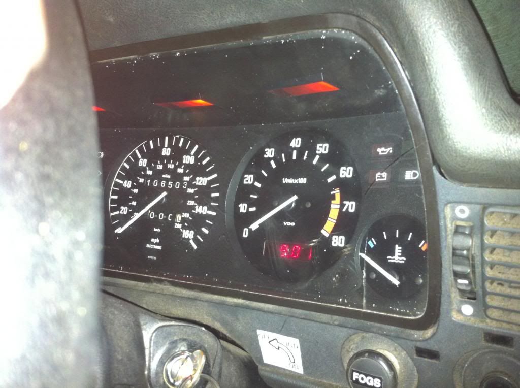

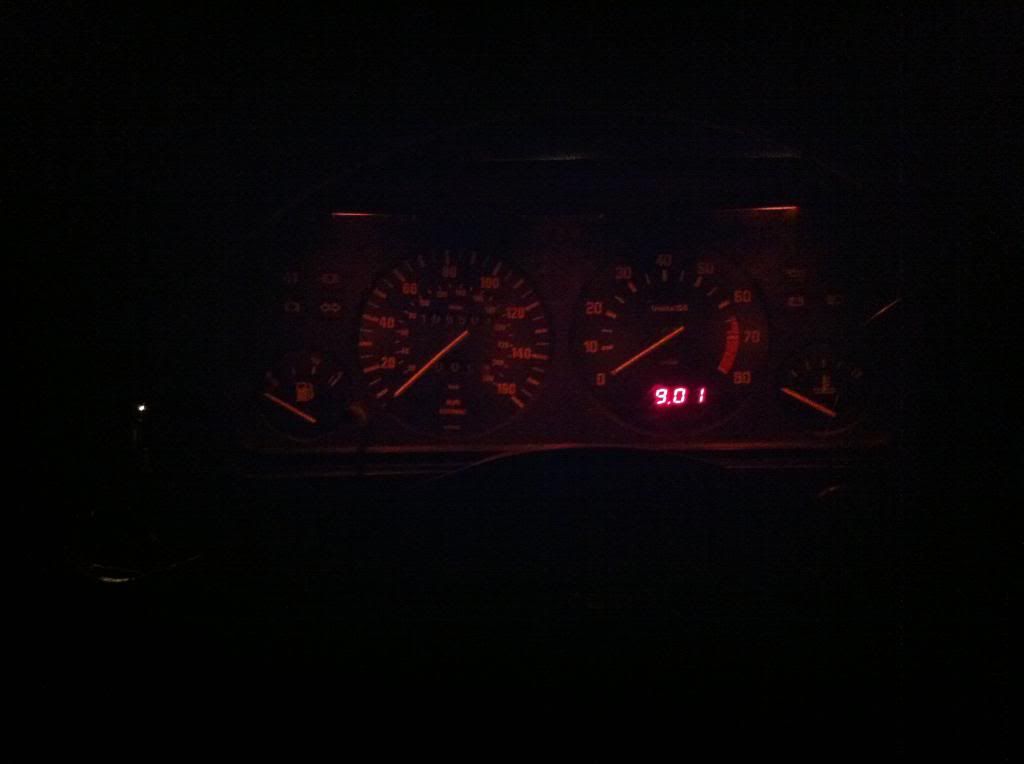

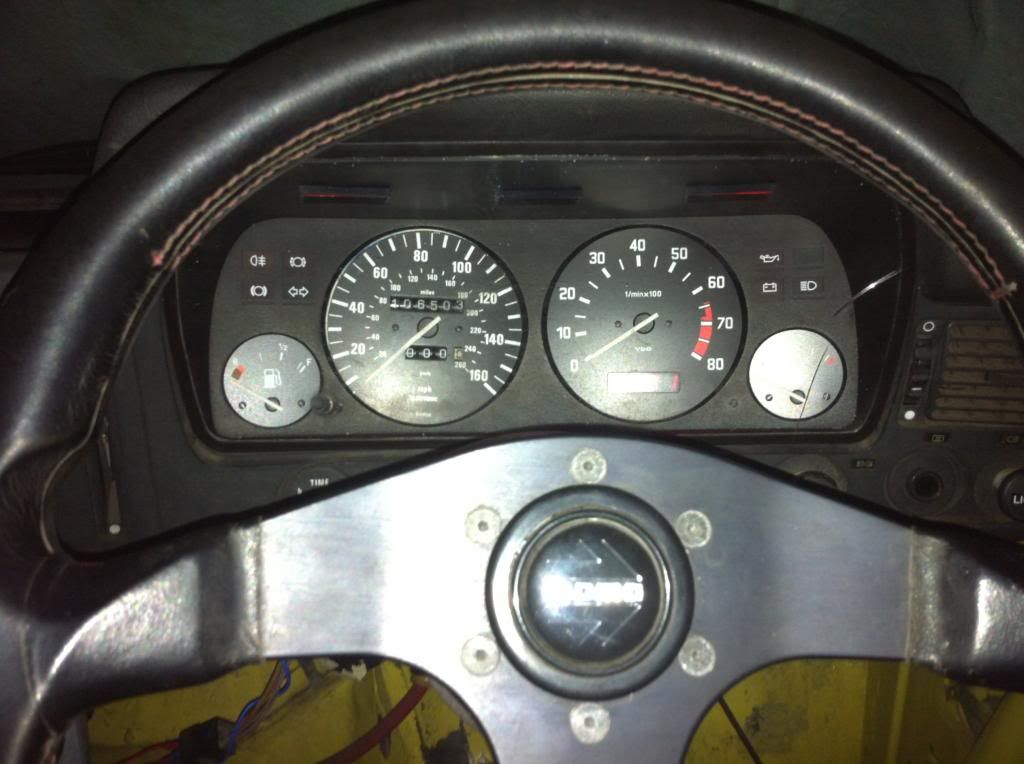

Its in the car and the binnacle is all wired up. Fixed my dash lights as well.
Its not quite perfectly straight or central in the hole and the trip meter is being pressed a bit too much so won't work yet.
Needs some fettling

Re: S54 Powered 323i - Duracel79 - England
Nice work Ben. Let's see the back of it? Getting it rock steady was the biggest challenge I'm keen to see how you fixed it in place.
It's so annoying that all it needs is to be 1mm more in diameter it'd go perfectly
