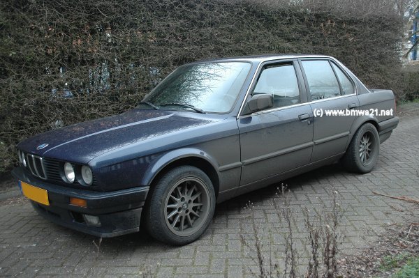

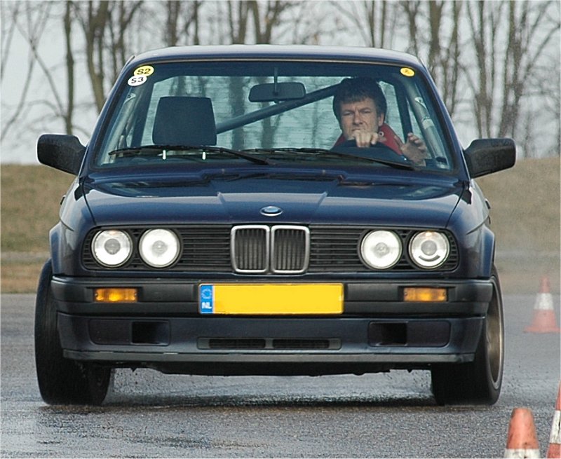

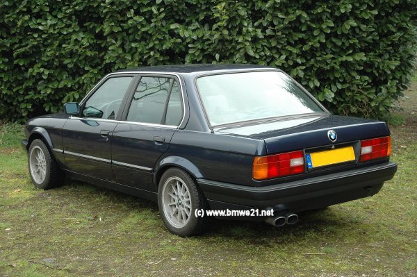

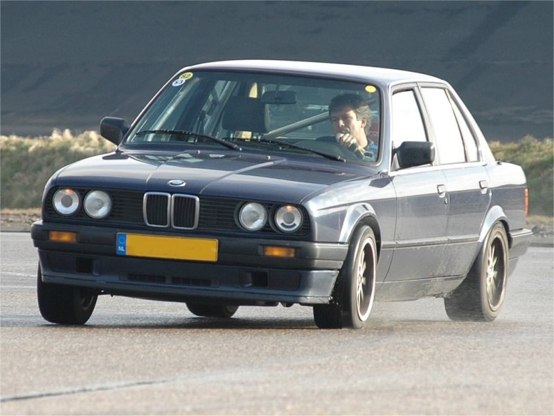

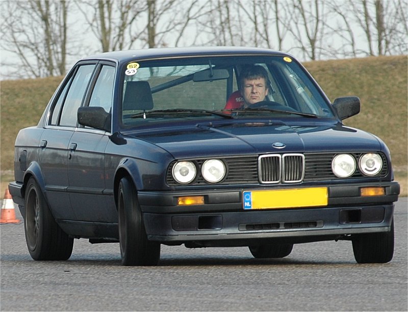

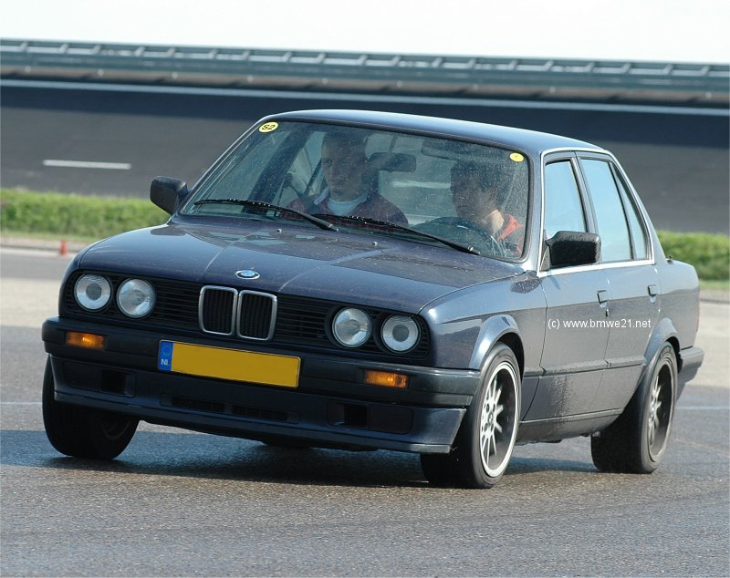

Let’s start off with a few pictures, first one was taken when I just bought the car, the 2nd one after its first shakedown… a drifting course on the national road authority test track on March 27, 05.
Well, as you can see it was not a real track car yet. First I wanted to sort out the engine and suspension and do some testing on western European tracks. Try to figure out the best ratio for a LSD. When the car went quite well for some time (and some track and drift days!) I decided to fit a roll cage, a race seat as well as a good steering wheel to go with it.

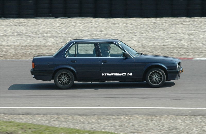

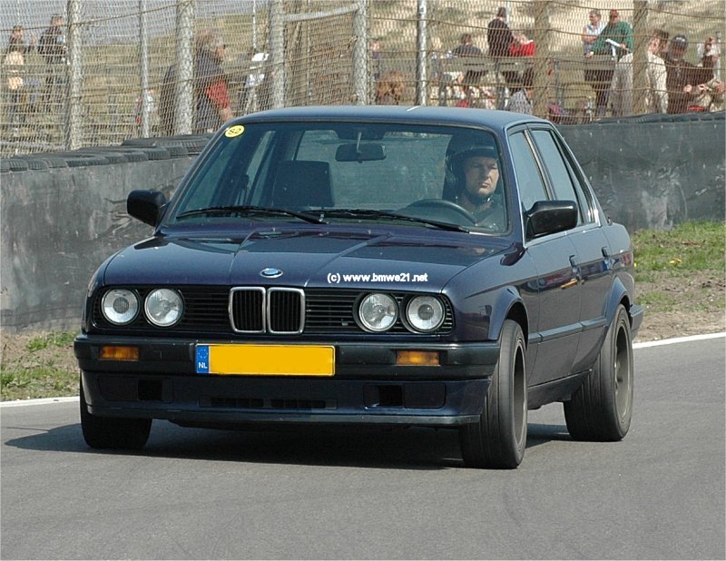

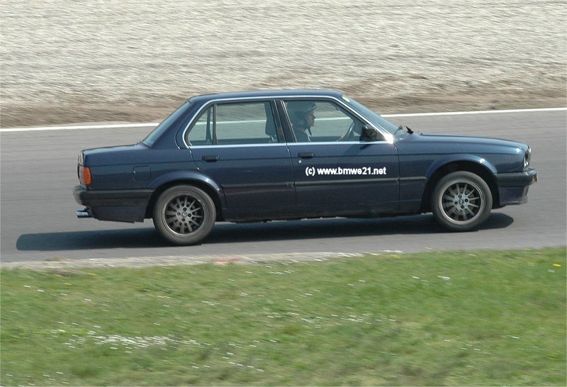

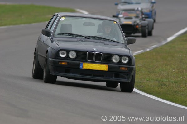

Zandvoort Clubspecial April 24, 05
Brakes... not bad but so-so cuz I had to stick to used OEM pads for the front, my Mintex pads were not in yet...
Roadholding & suspension... pretty good considering I am using a stock open diff. Diff ratio needs to be changed to adjust best to the Zandvoort & Zolder tracks. No understeer, sometimes a slight but controllable oversteer.
Engine… performed great, not the more or less standard overheating for M20 engines on the track and that without any additional measures other than the QH high flow water pump! Fuel mixture seems a but stoich around 4200 rpm, have to look into that.

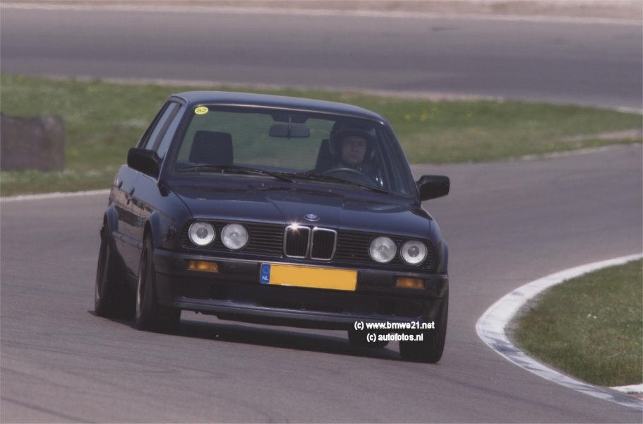

All 'n all a great day and the car just went and went... here’s a few pics taken by Nils and by www.autofotos.nl

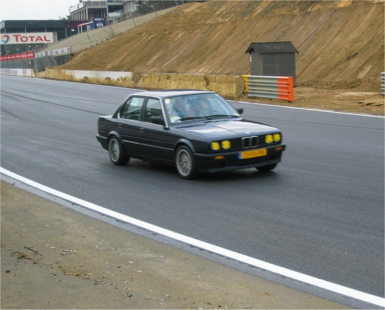

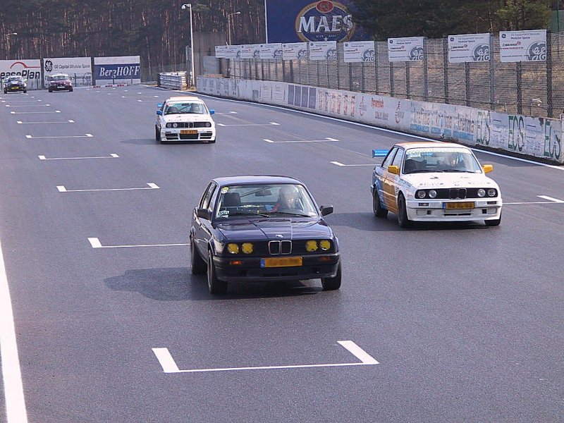

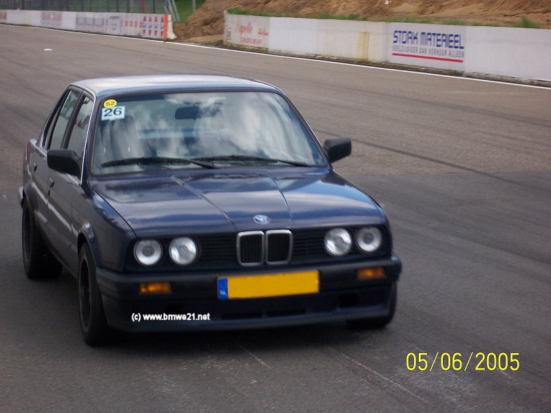

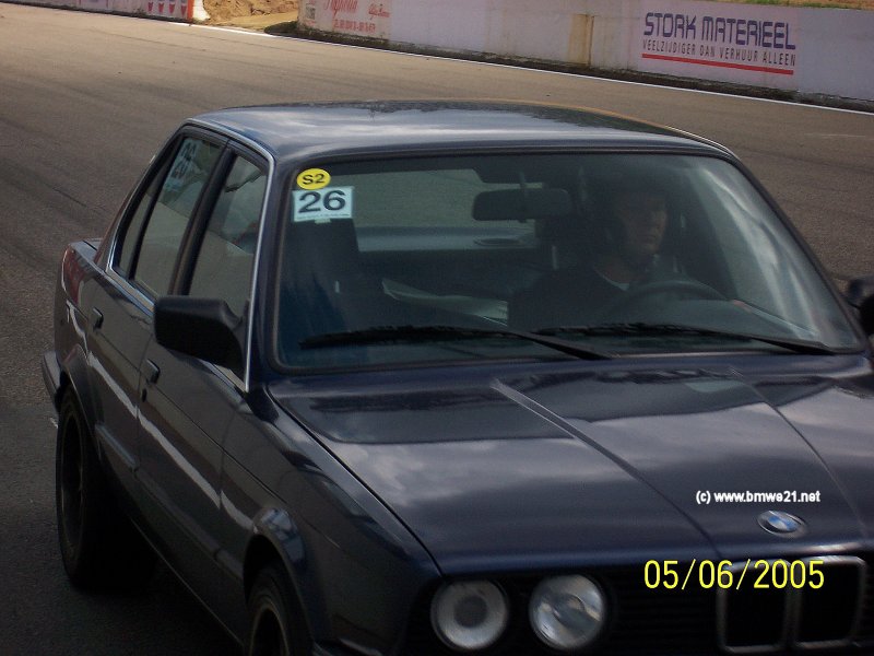

Zolder (B) trackday May 6, 05
Day started off with rain and a very slippery and wet track. Tried to lap but my Avon (rain!) tyres were horrible so went inside to wait for the track to dry. In the meanwhile we played with a E34 540i V8 with a 6 speed manual that was equipped with tyres that were up to the job.
After about 90 minutes the track was quite dry and stayed dry. The outside temperature was ideal at 15 degrees so no overheating problems for tires or engine. The Zolder track is known to be hard at the brakes and it was. Was still running on OEM pads since there was no time to replace the pads and brake them in. This week I will fit my new Mintex pads. Engine was good and fast… seems we’re almost there!
A few pics thanks to Arjan and Gerrit…

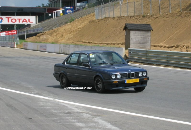

Spa-Francorchamps track weekend, July 23-24, 05
A week in advance I thought I had it all in perfect condition…. brakes rebuilt and pads ok, new tyres & new Koni springs. 2 days before the track weekend one of the new rear springs broke so I had to put in old M Technic rear springs, not enough time to get something else grrrrr. The car performed perfectly, ran fine, no temp problems, brakes were perfect and so were the tyres. Just these rear springs… way too soft of course. So you first had to turn the car in a bit to get the rear in position before the actual cornering began, otherwise I would just skid off. Besides that… perfect weekend and a great atmosphere.

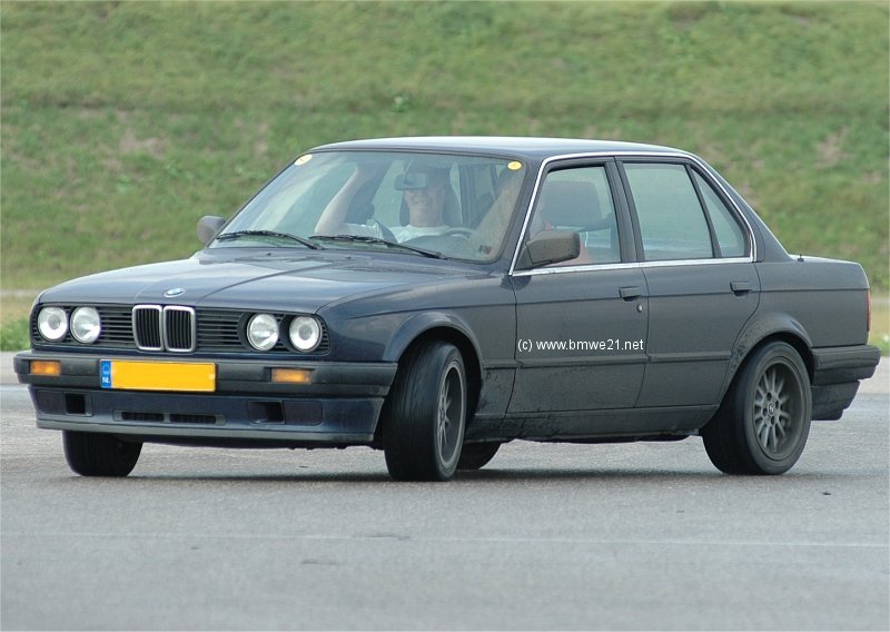

Another drift day, Lelystad, August 28, 05
Big fun! Really getting the hang of it now. Car was perfect again but by the end of the day it was not just the steering wheel at full lock, but the fan clutch as well. Had to quit about 15 minutes before the end of the day.

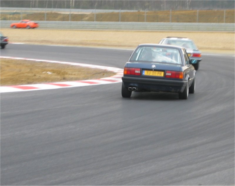

Zolder (B) trackday April 7, 06
With the track just ready from large mods over the winter including fresh tarmac, it was good to find out the track wasn’t as slippery as expected. The weather was great and I was able to do a lot of laps. Started off on slicks right away and that went fine and the car felt really well and was able to keep up with several of the competition cars… if only I was a better driver it would have been even better hahaha. No problems whatsoever… until I had a pair of really warped front rotors by the end of the day. That being the only ‘setback’ for this day means we are ready for more fun the next track day, planned for May 26.
