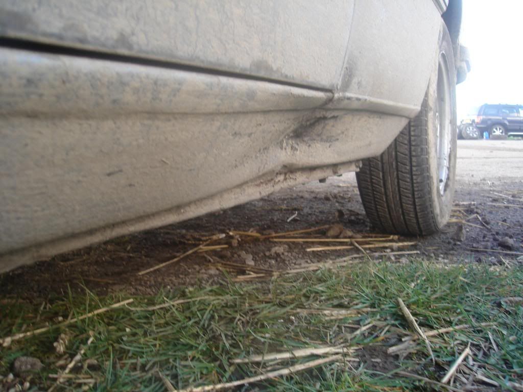

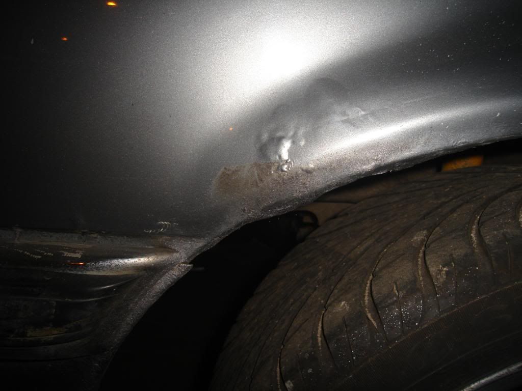

ive been a welding today. repaired the dint in my sill.
welds need a grind up tomorrow then i'll welly some filler in it.

Danny043
Posts: 758
Re: murrans 325i.
Post by Danny043 »
Oooh, keeps you busy! Good job on the sills, keep those pics coming :cheers

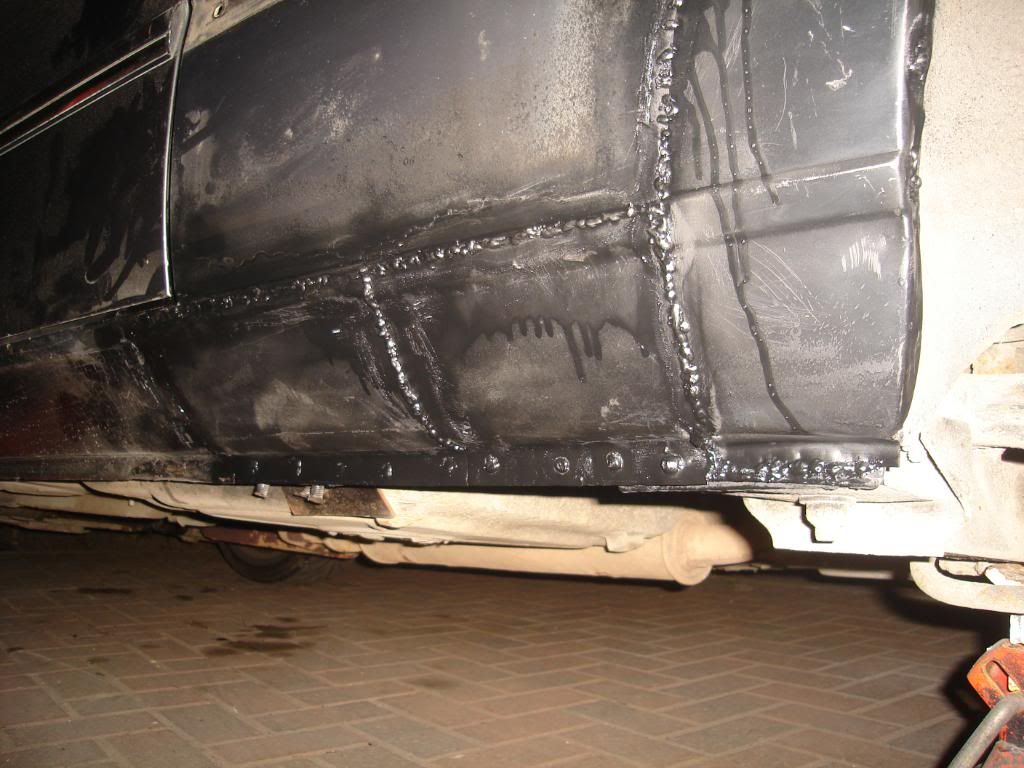

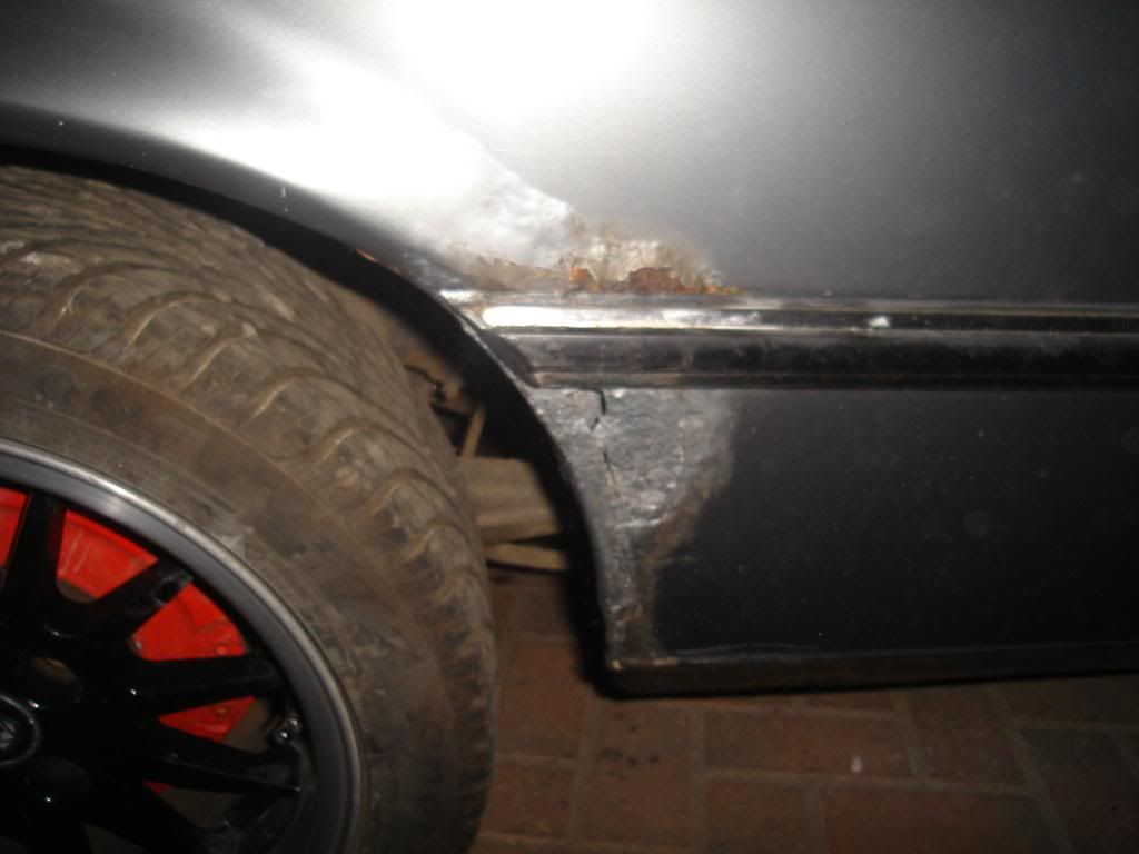

well had to do some family stuff today. but got on with it about 5ish. grindered the welds down and whacked some filler on it. rubbed it down, splashed some paint on it..... im quite impressed with the results. tho im hoping no-one reports me to the bodywork police! lol.

well ive been going for it yesterday afternoon!
need to do a bit of the sill today......

DrGonzoPOW
Posts: 990
Re: murrans 325i.
Post by DrGonzoPOW »
Top notch repairs there mate

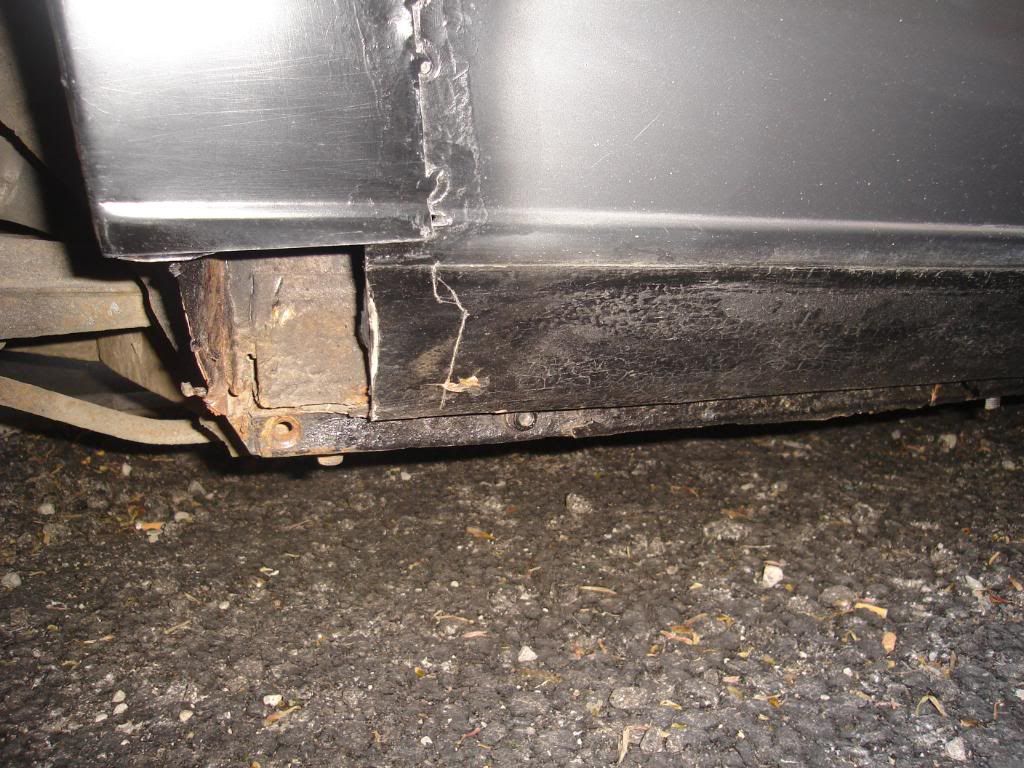

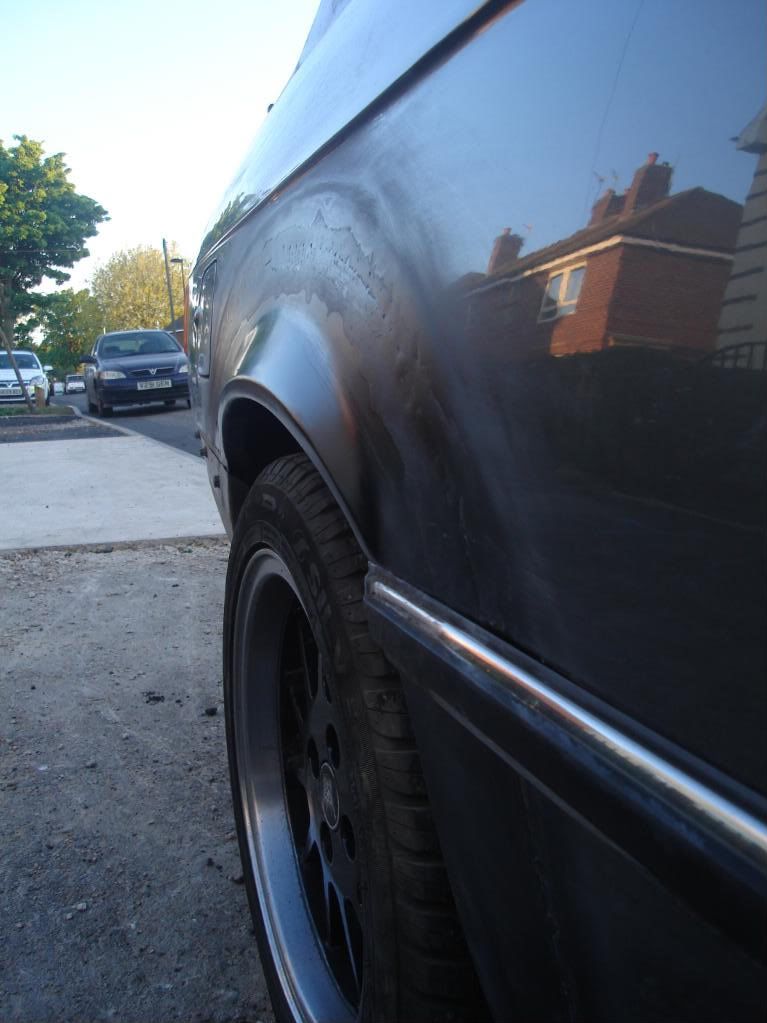

finished the bit on the sill, inner bit was holed on the inner box section bit aswell, but its all repaired now.
just need to stick a bit of filler in it.
guna post a pic up later.

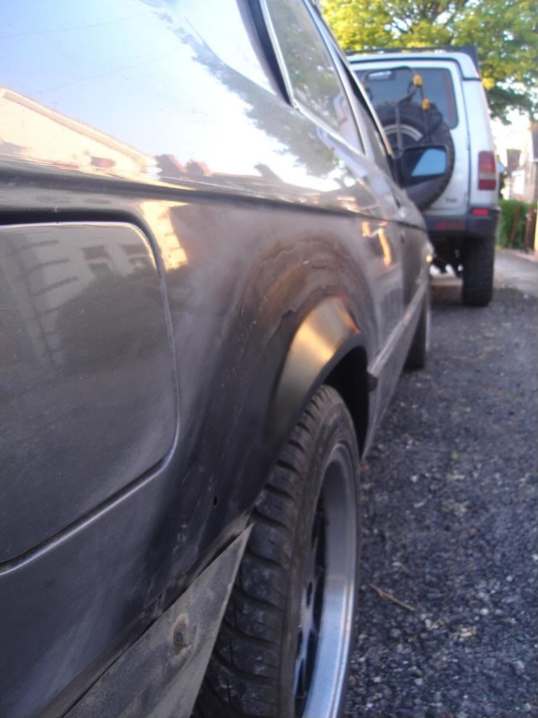

done that bit! (to the best of my ability anyway.)
on to the other bits another weekend!

MRE21
Posts: 119
Joined: Thu Sep 03, 2009 9:19 pm
My E21(s): Audi RSQ3 8U (Previously owned E21 320
Location: Kent
Re: murrans 325i.
Post by MRE21 »

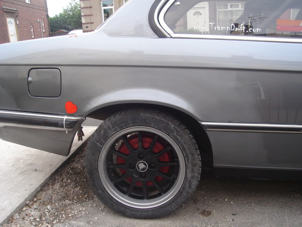

That's looking really good Murran! What will you do with the paint work on the rear quarter? Will you blend it in yourself? or a full respray? :thumbsup
