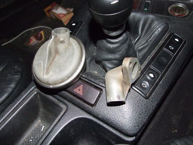

My sump is done
The idea was that the engineer would let me know when the bottom was chopped up so I could fit it on the engine and score along the oil pickup, but when I turned up he had already finished it. So I made a template to the size/shape of the sump and chopped up the pickup which is being welded today
