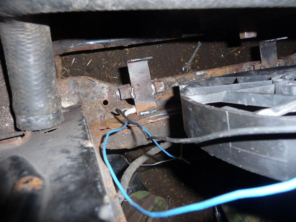

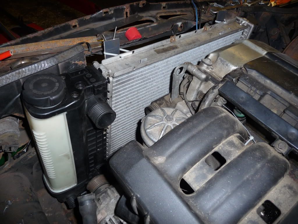

This week's progress. Radiator, radiator mounts, electric fan mounts and sorted the exhaust manifolds. It's involved some fabrication which is one of the things I most enjoy about these builds, though my welds aren't the tidiest they are certainly strong enough!
Radiator, radiator and electric fan mounts
E36 328i is a good fit, better than the smaller M42 radiator in fact. 323i radiators have the rad openings in the wrong place and with the 328i I know I've got more than enough cooling capacity. So I bought one and made some bottom mounts
I didn't fancy fixing the electric mounts on with the ties which go through the fins of the radiator, so I over engineered a metal brace doubling up as the top rad mounts and nicely secures the kenlowe fan.
Close, but fits lovely, zip ties are temporary until I find some bolts to secure the top of the rad.
