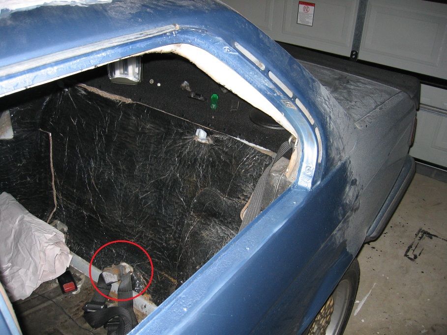

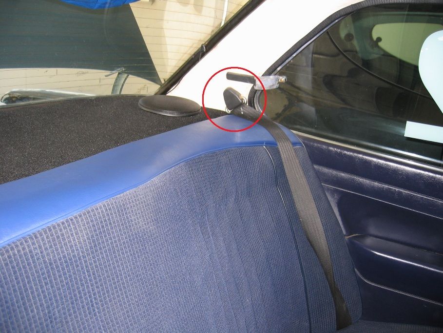

Pop out your back seat and have a look. Should be two botls and it'll be out. Feel under the head liner to see if you can feel the top one. Here's some photos for locating.

Re: rear seatbelt
Thank you very much this is very useful. Only i can't se on pictures where and how put the bigest part, where is belt is rallying.

Re: rear seatbelt
The belt rollup mechanisme is behind the backseat, next to the spring/damper tower. one more bold
Also there is also a bold at the bottom on the side of the car.
