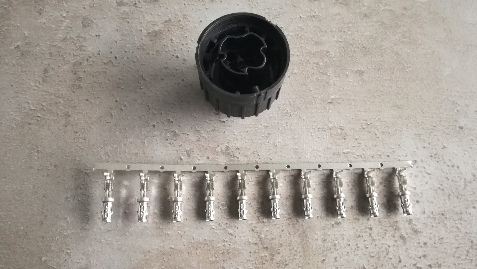

I've used this connector for the 5Wk9 MAF, got them from the bmw dealer:
61131392224 p/n connector
61131376204 p/n terminal

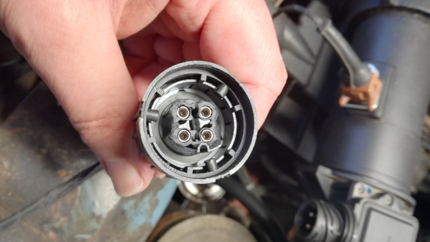

Connector needed a little rework to fit, but doable.
Terminals from a old PC power supply do fit the terminal pins on the maf nicely, with these terminals and leads i did the first tests:

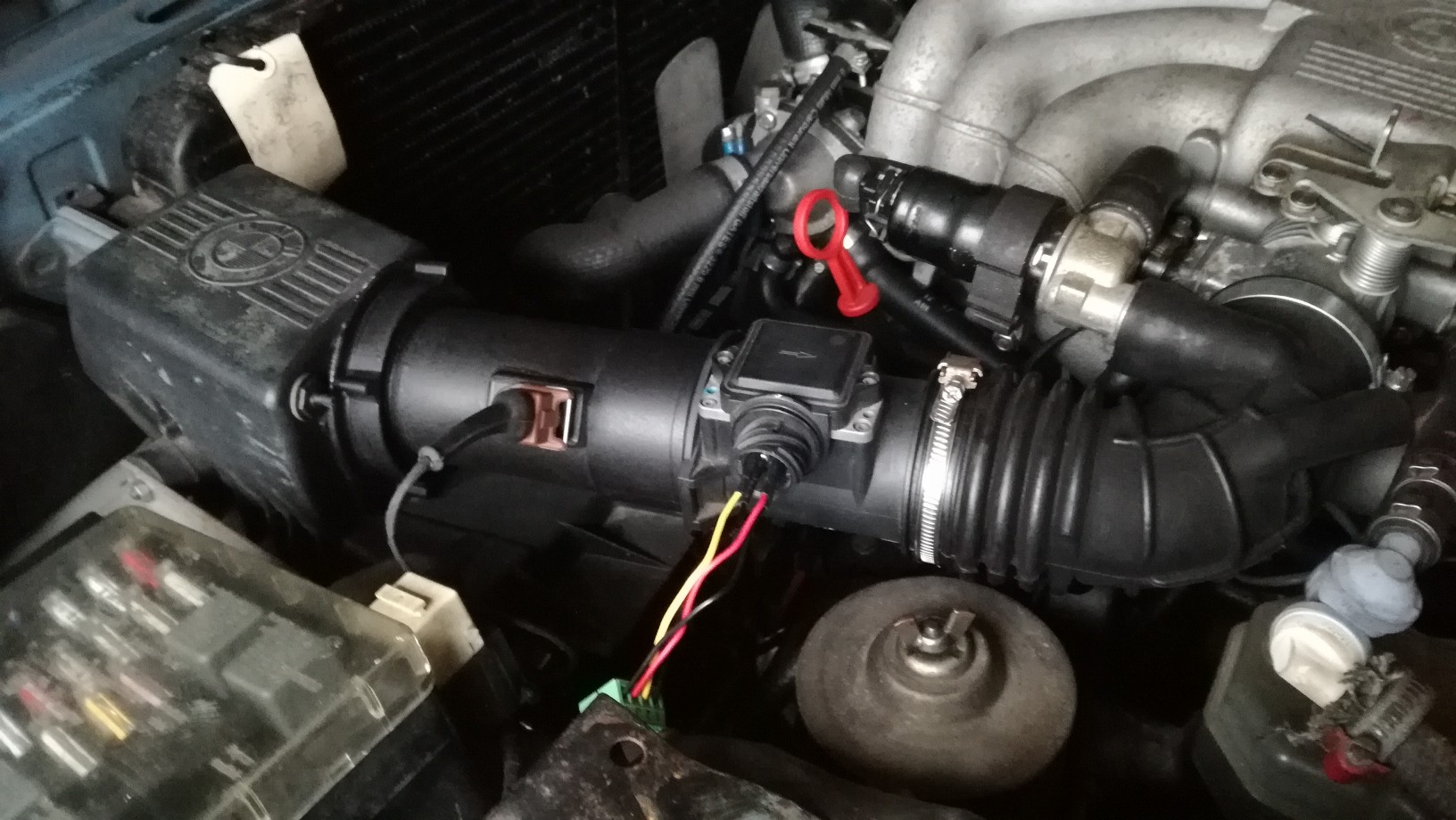

Connector and crimp terminals from the dealer:
Modified connector:
MAF and connector nicely installed:
