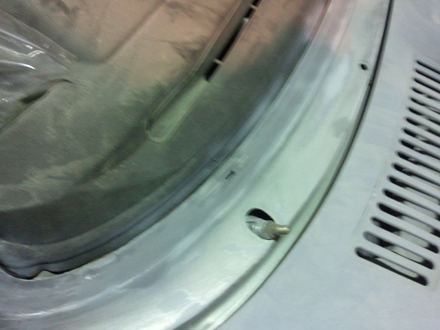

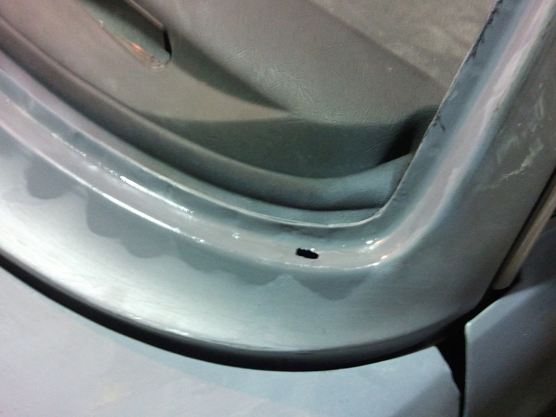

I snapped a couple of pics of the holes under the windscreen, phone rather than proper camera I'm afraid, also one of the front end of the car - lots of primer there ready to be flatted.
Small hole in the passenger side corner...
Small hole drivers side...

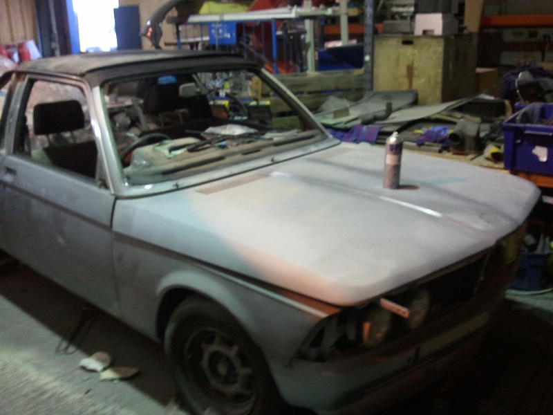

And the general view of the front end...
I've now taken off all the trim, plus the screen. Found a small dent in the bottom of the drivers door as I was leaving this afternoon so a bit more filling to do then it's time for high build primer. Need to work out where I can get some new canvas for the front of the roof and to recover the Baur panel.

JIm I believe those holes are to act as drains to stop water build up under the windscreen seal around the scuttle. looking good though

The passenger side one had a big rubbery rust blob over it, wasn't quite sure if it was an OEM hole or a rust creation. I can't remember if there was a hole in the slug screen surround - apart from the massive one I welded up!
Anyone else pulled a screen out recently and can comment??

My e30 m3 shell has those holes and it's never been used.

I'll have to poke something into the holes and see where it comes out - if it's into the scuttle to drain water away then it's good, if it's under the dash it needs filling!
If the windscreen surround just had a bit of surface rust then I have had some good luck!
