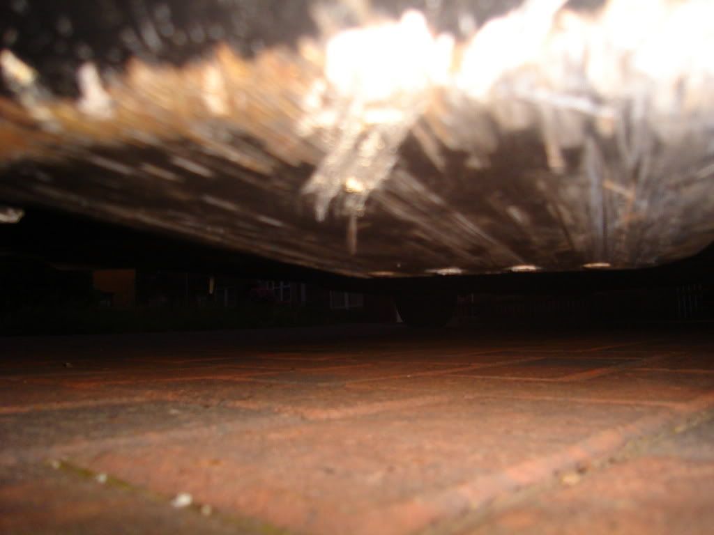

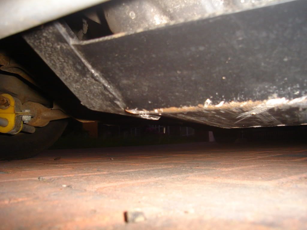

thought id take some pics of the now battered sumpguard!
:lol:
Posts: 30184
:P at least now you know for sure all your trouble wasn't for nothing!
BTW didn't check this thread for a looong time, great work mate!
Any upgrades to the rear sway bar as well?

Just think all those battle scars could've been on your sump! :shock:

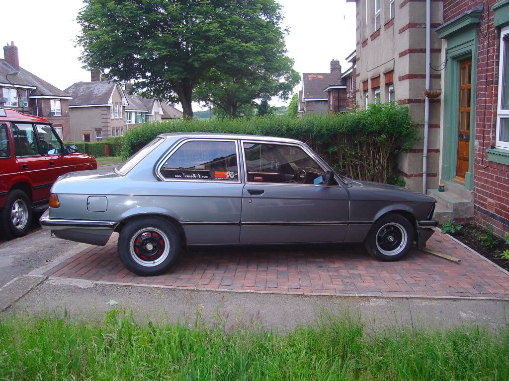

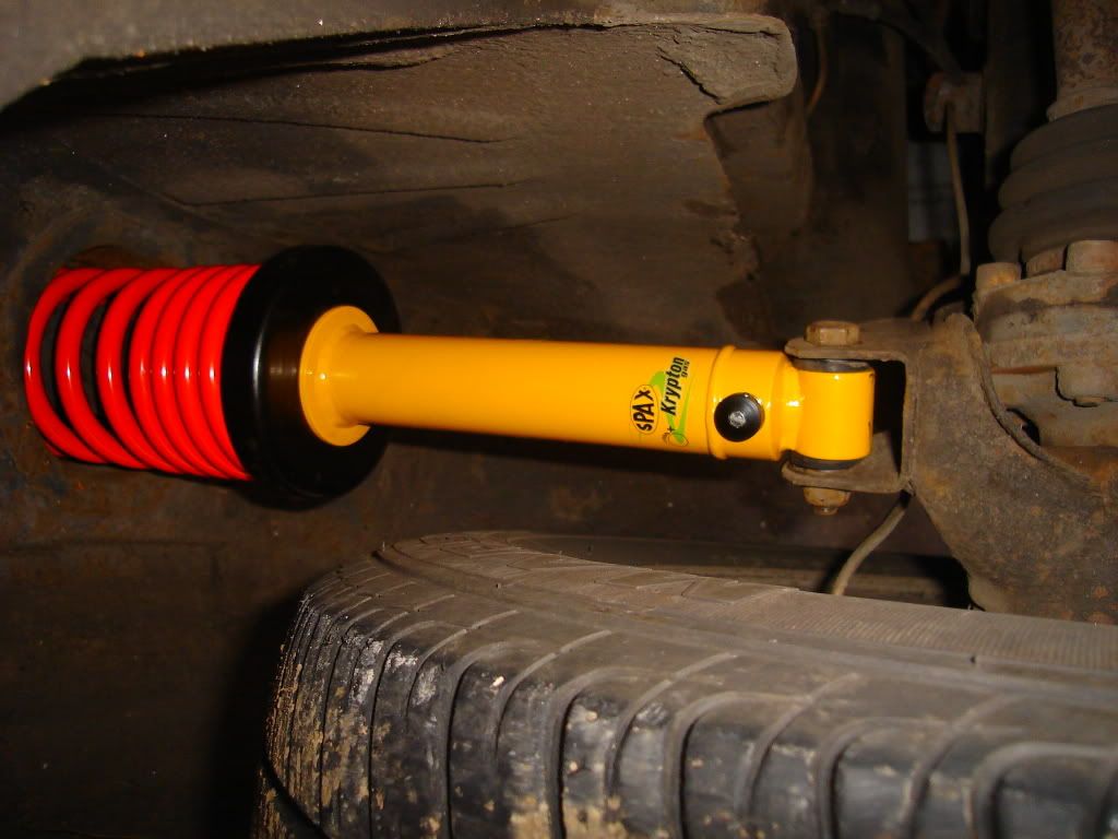

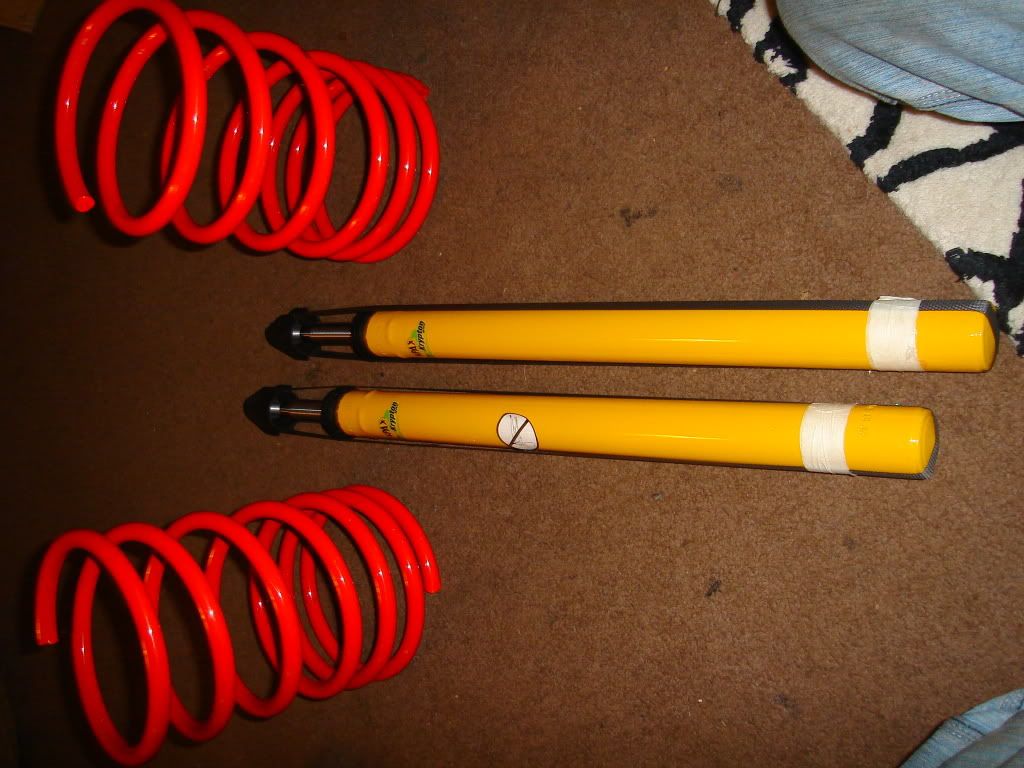

spax kit is here!
its so shiny! :lol:

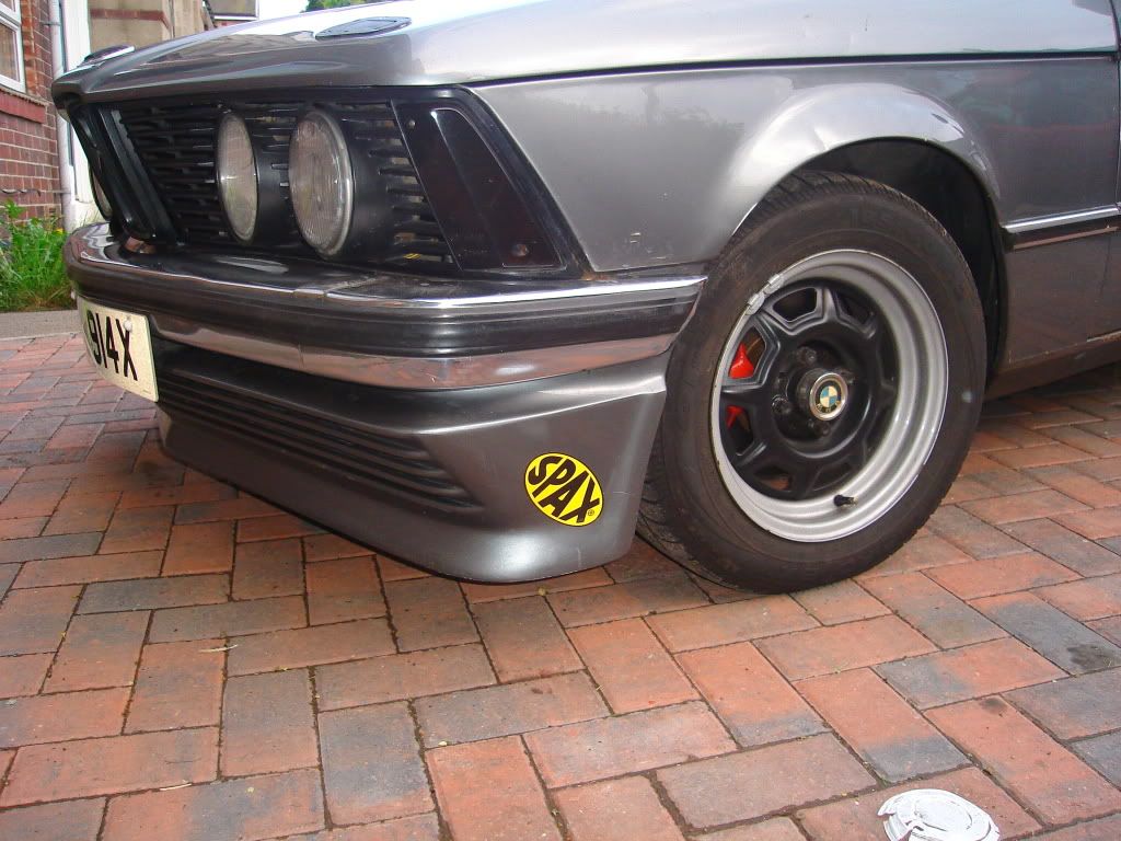

got the rears knock on in about an hour soon as i got home from work.....
the fronts will have to wait till saturday morning and access to a two poster ramp. :roll:
not too sure about spax's interpretation of -60mm........
looks a little 4x4 spec to me :?
soooooo many stickers! only "fitted" two atm.
:D
Did they send the right springs? :shock:
Very shiny bits though.... Ooh, stickers too! :wink:
I would hope things might settle but does have a hint of the Range Rover about it?

seems to be the right springs, it is stripped out and has no spare wheel/wheel well.....
grinder might be coming out on them i think. guna get the fronts on and see how it drives/sits. the front should be at the right height. so might just lop a coil off the rears i dunno yet.
