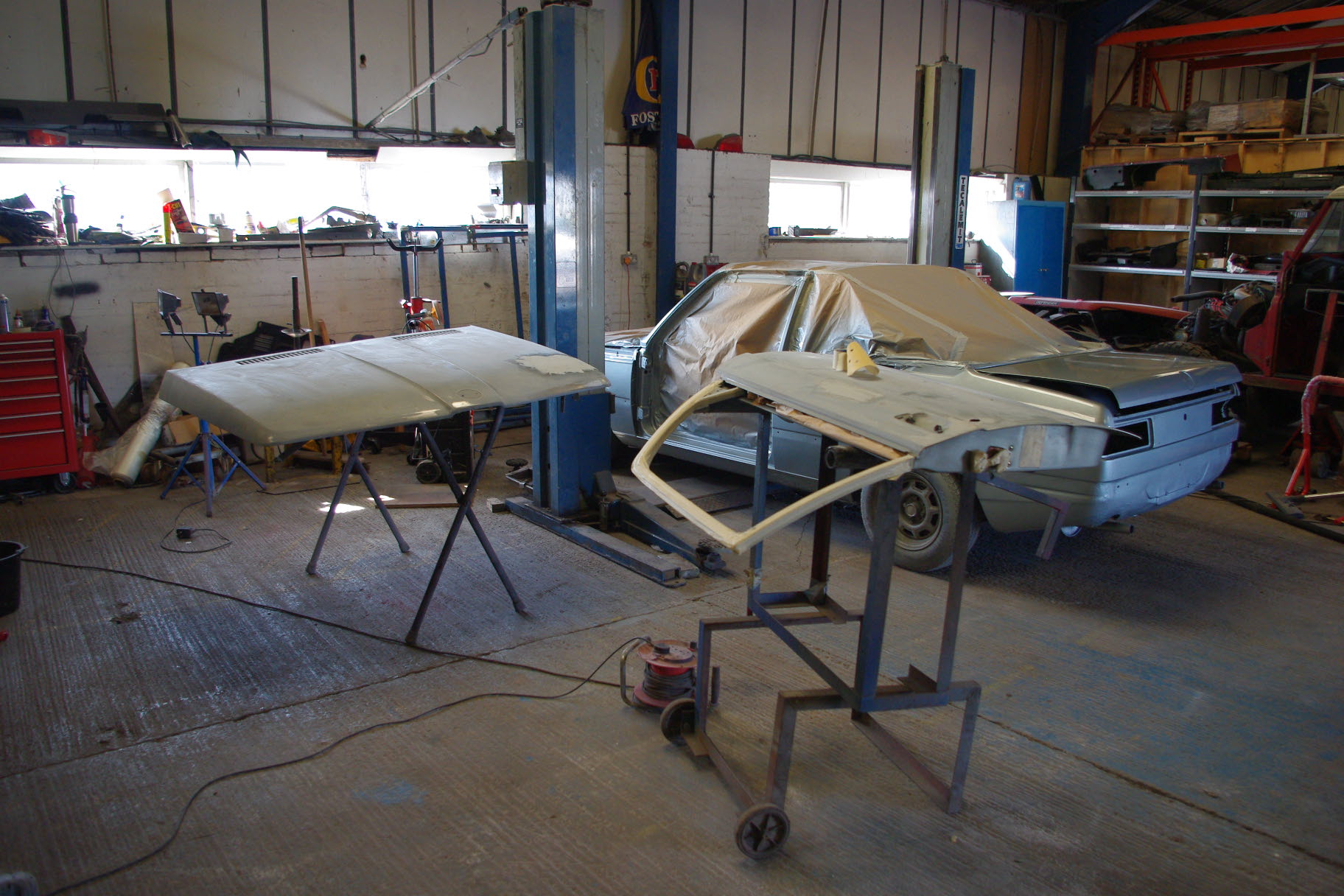

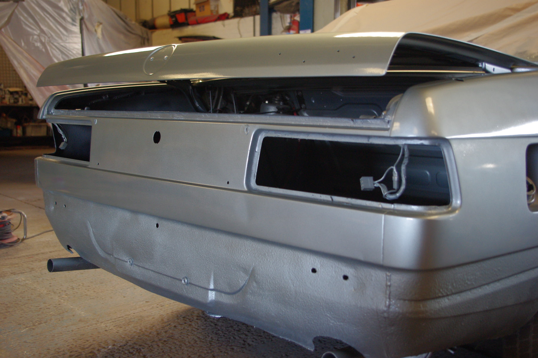

Re: Baur rebuildathon = updated thread

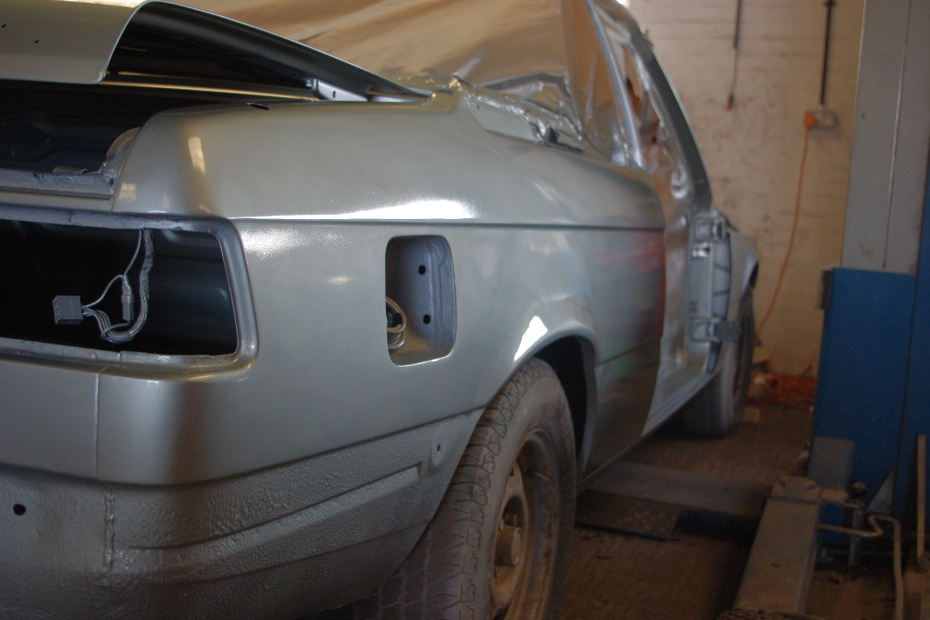

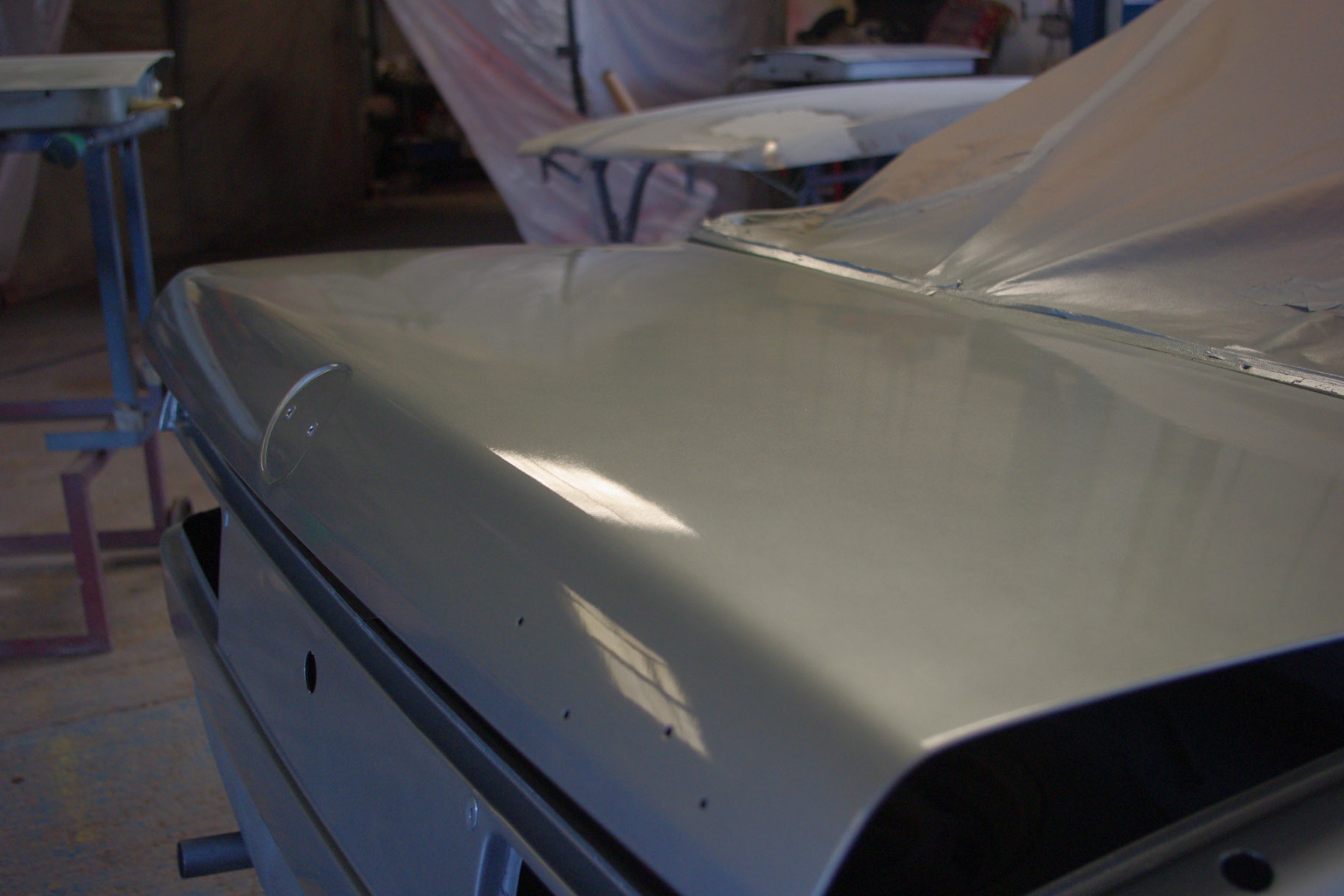

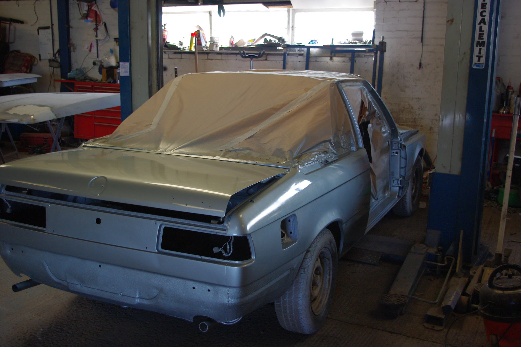

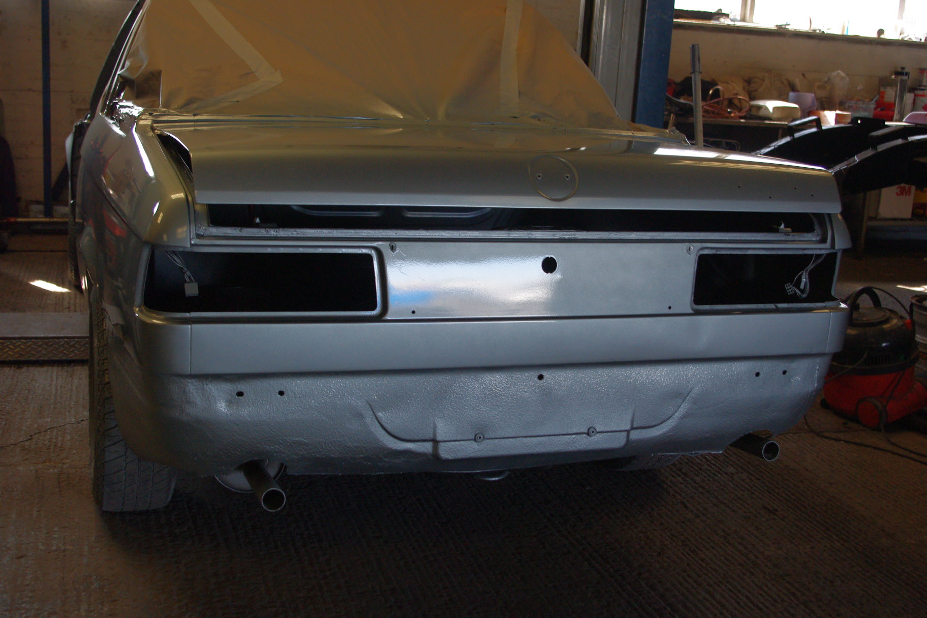

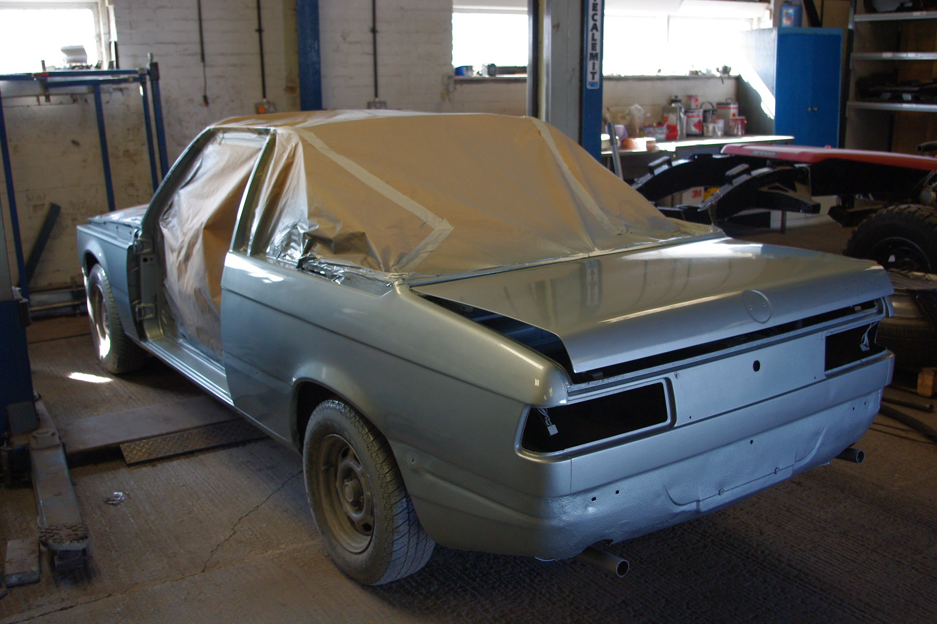

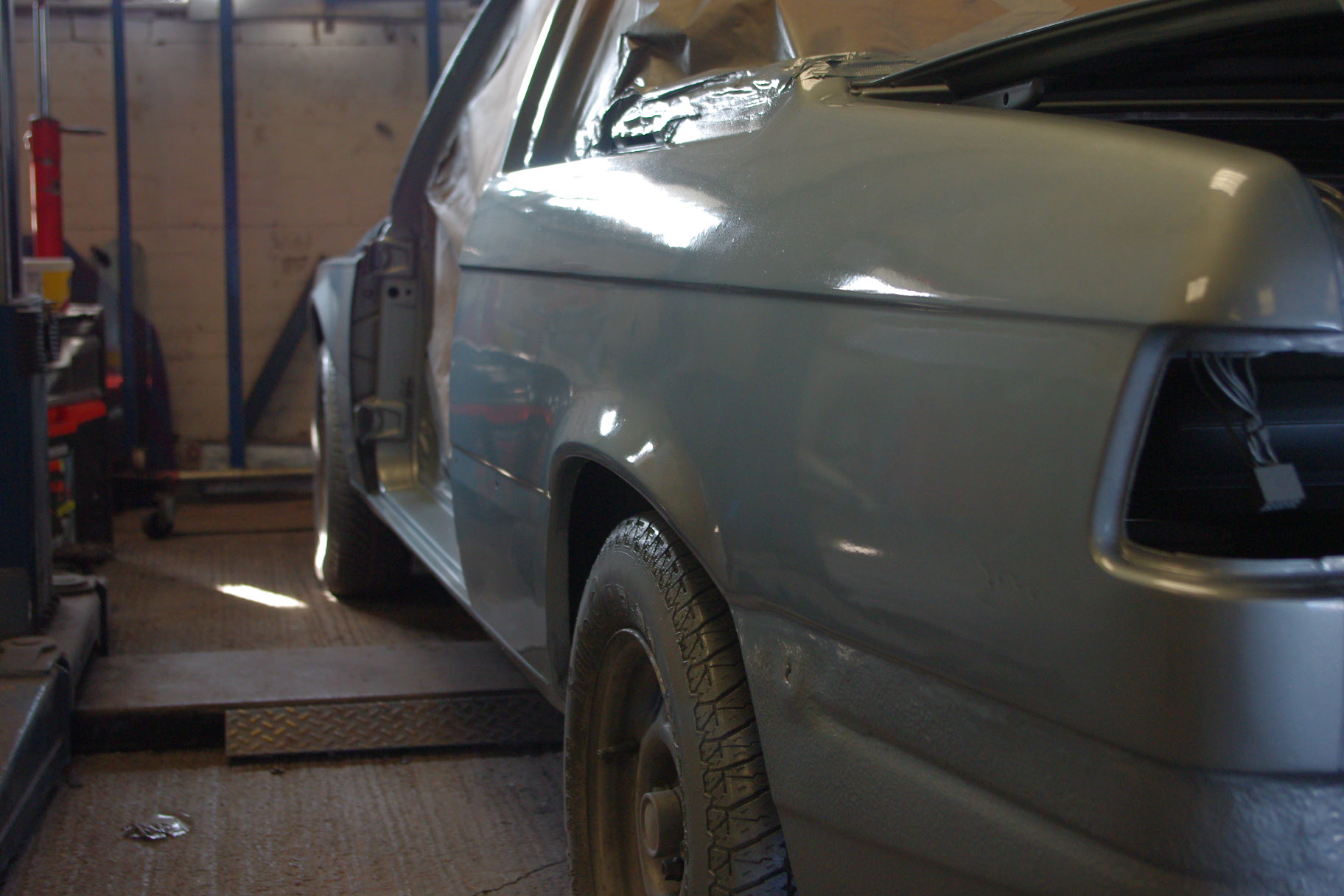

I have been madly busy with work, done a few bits but not much. I was at Wembley for football yesterday, while I was there Shaun texted me a picture. I have been and taken some better ones today...
Few bits of dust in the lacquer to buff out, doors and bonnet need painting, then reassemble and get on the road.
