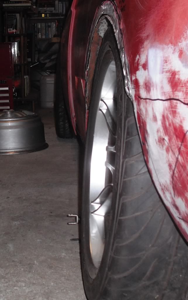

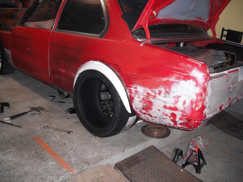

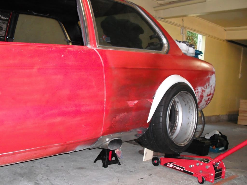

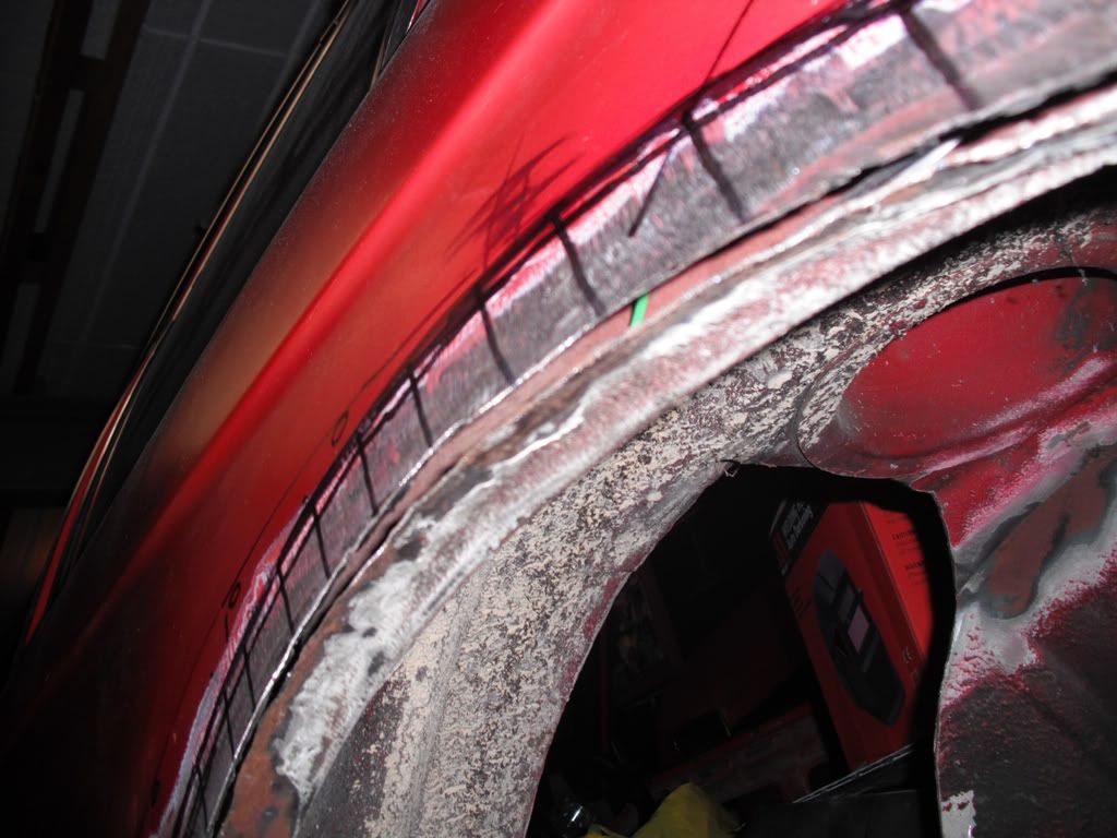

1. Lowered massively, on 17's. I cut the guard and tapped the inner guard up to meet it, and was going to get it welded there and be done.
2. As we all know, lowering an e21 induces massive amounts of rear camber. Looks cool, but is not tyre friendly if they're wide and low profile.

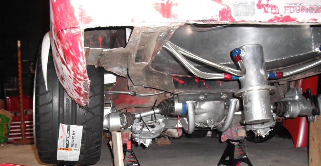

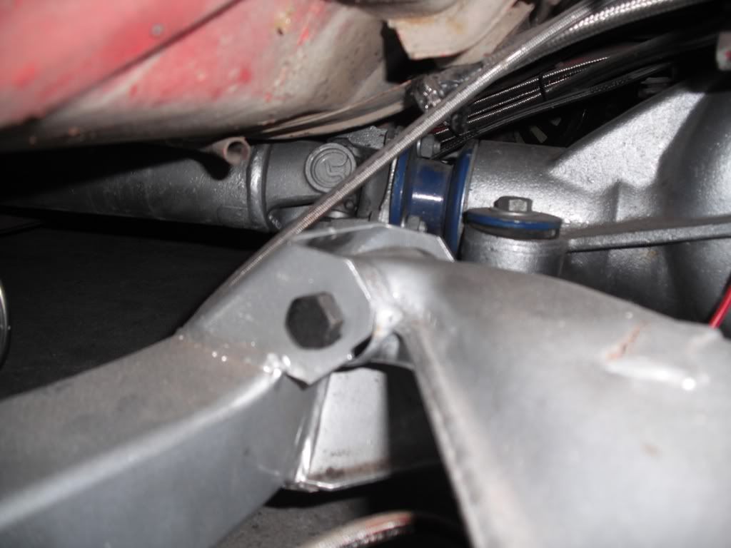

3. One solution to this is to raise the subframe. I'm in the process of doing this now, although the previous photo is with it already raised, and there is a lot of camber still.
Raising the subrame results in the outer joints not having much room (I'll be shaving some material off where the arm actually would contact with the chassis)

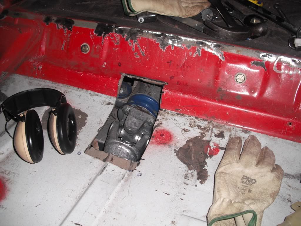

I also had to make a bit of room for the driveshaft...
(yeah, i got a bit carried away there...
The inner joint will be raised (im not a fan of the adjustable bolts, and its cheaper to just weld a plate on with holes in a different spot).
now we still have the problem of arms that 'point down', which is not ideal. I havent figured a solution to this yet (an affordable one, anyway), but there must be a way to fix that.

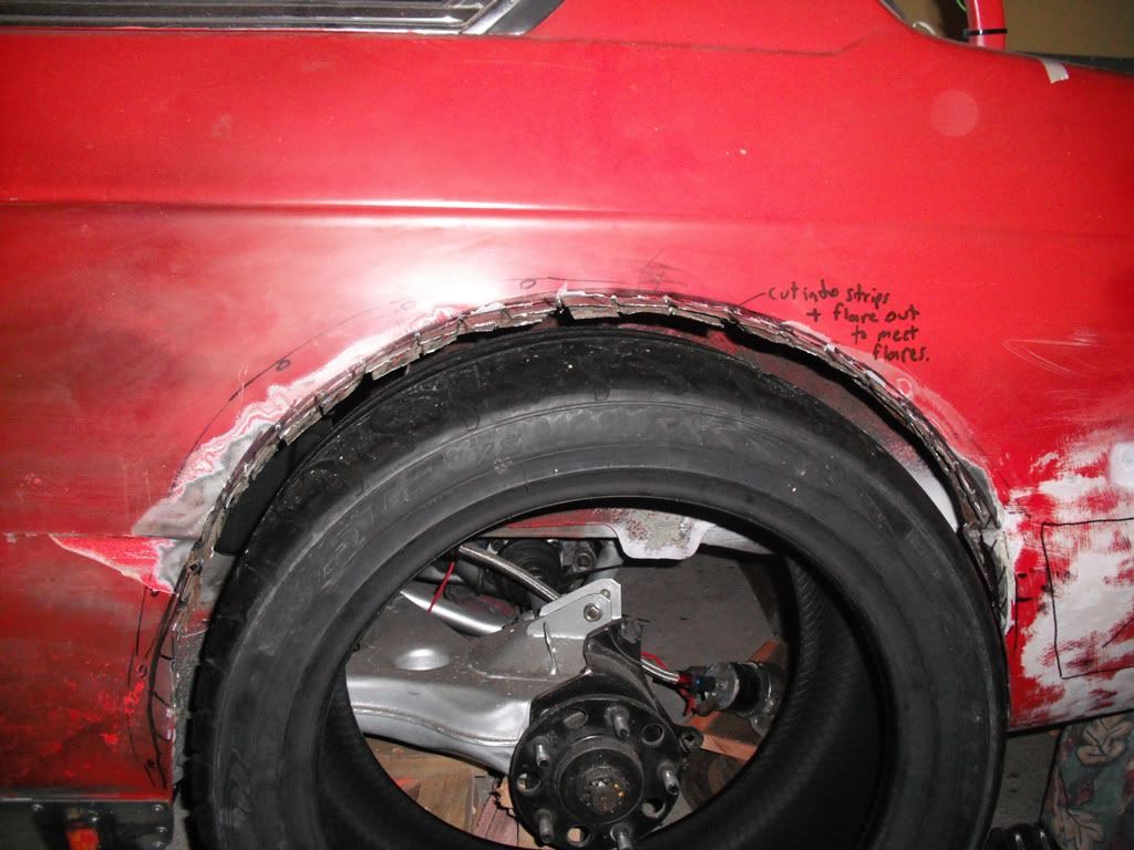

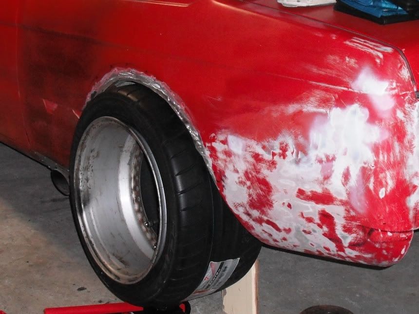

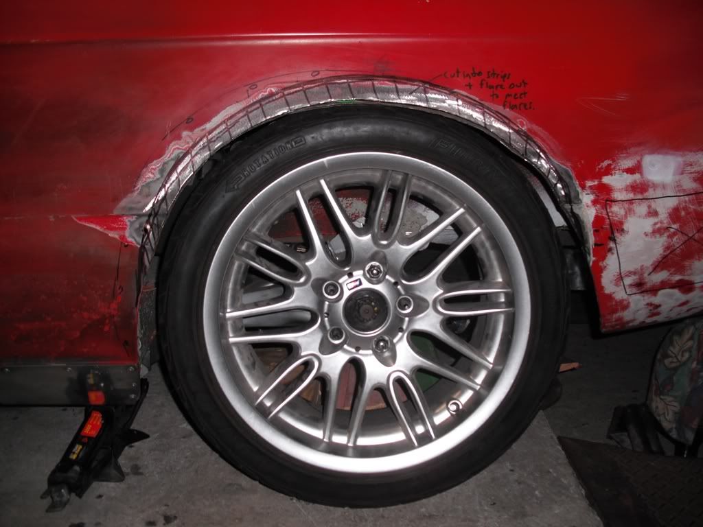

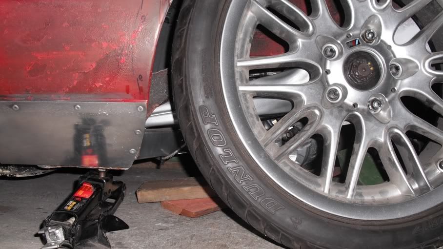

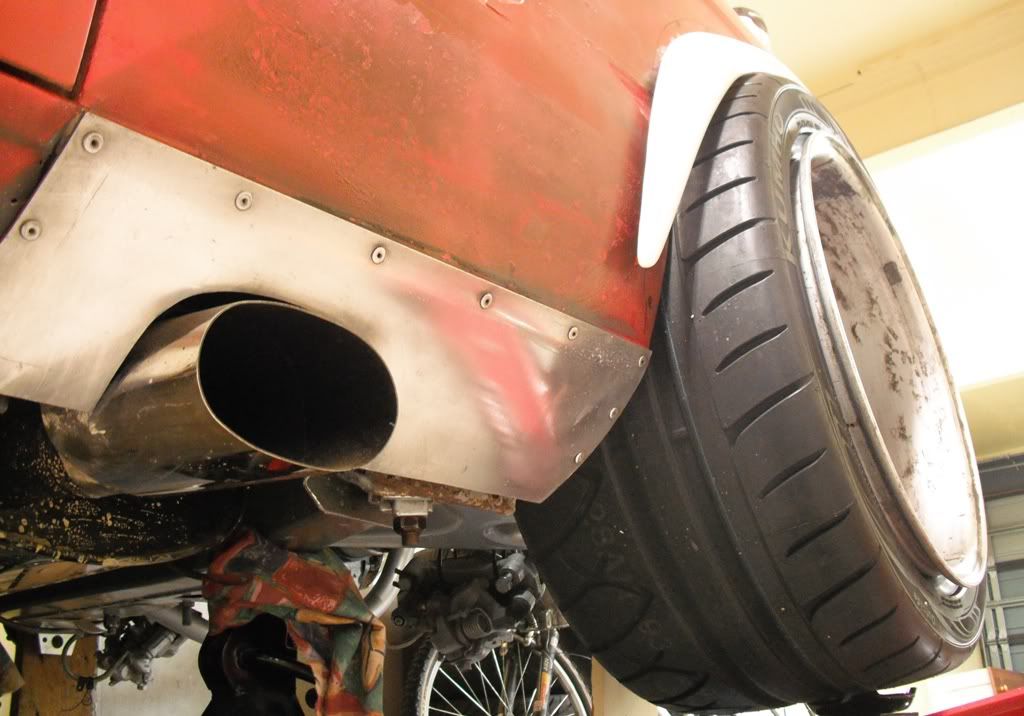

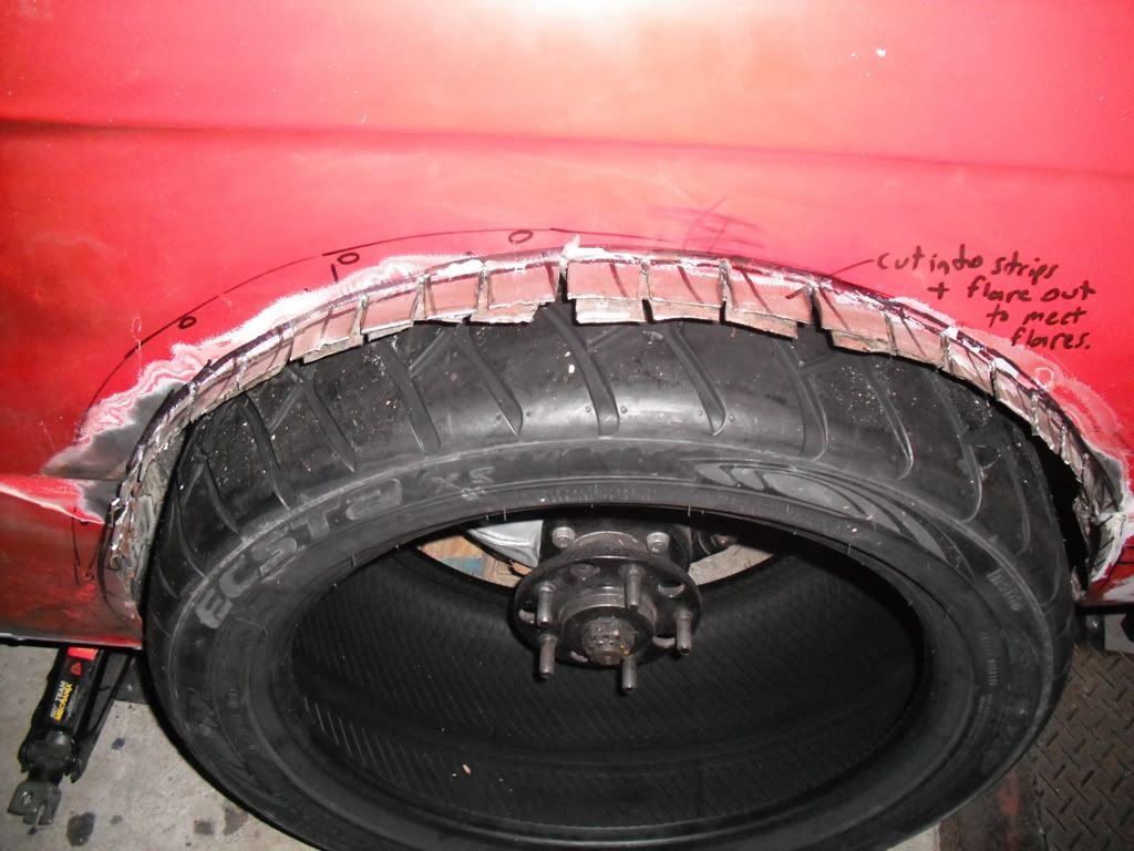

4. Next I needed to make some room for the bigger tyres and also bring material out to meet the flares (which aren't wide enough in the rear for these tyres)

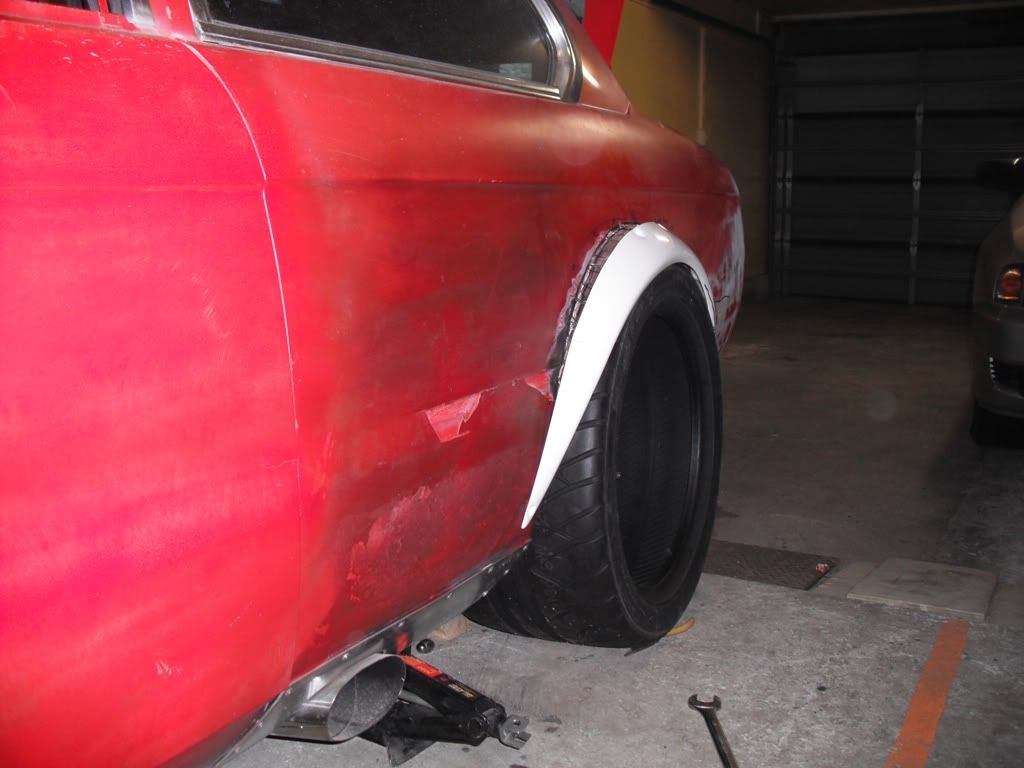

5. starting to look ok

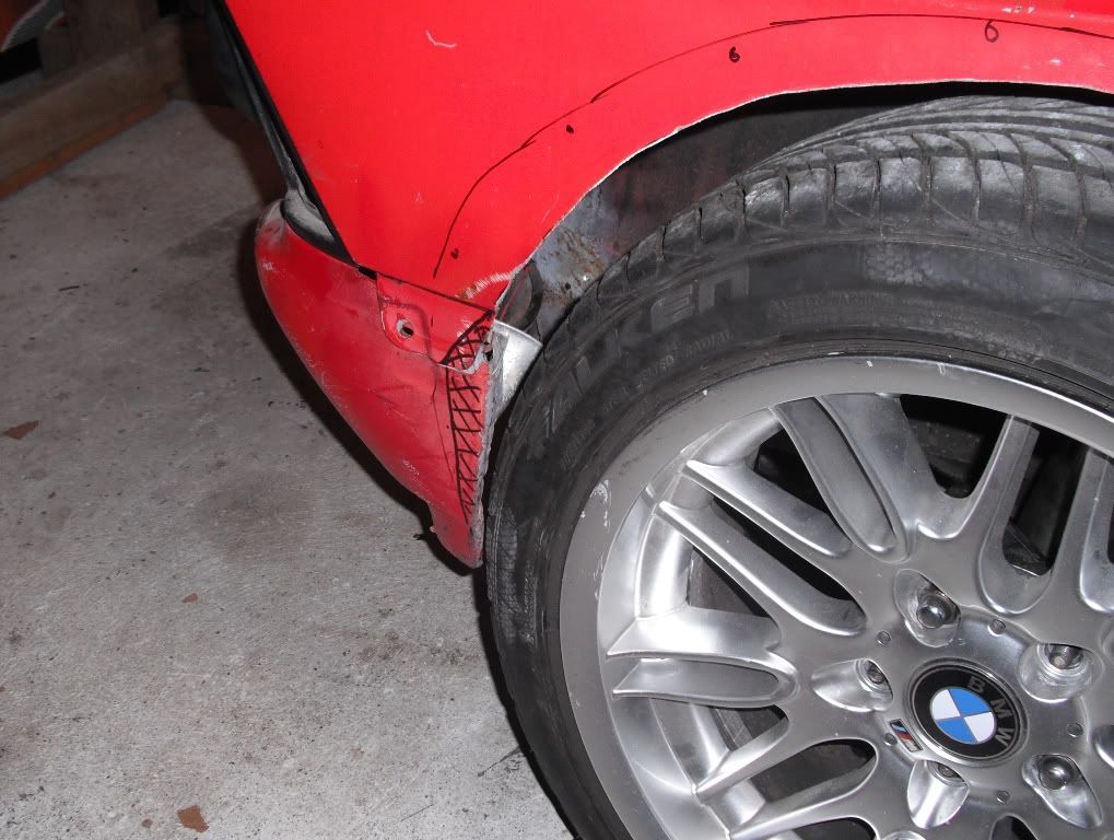

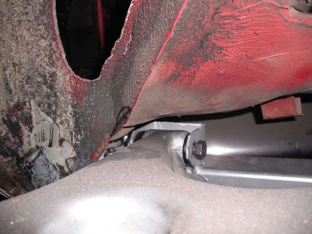

6. and the front needed a bit of clearancing too. im going to cut this area out. it doesnt need to look perfect, because the flare will cover it all up anyway.
