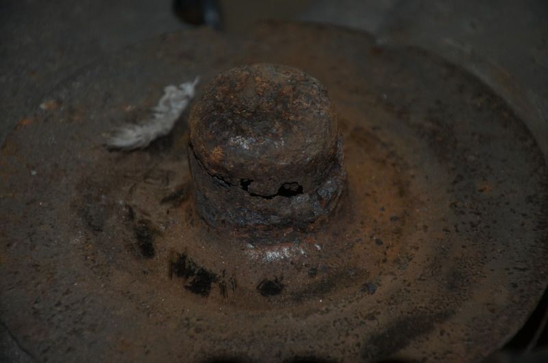

In December 2015 I started working on the E30. I took off the front legs ands the stabi.
things that stand out:
Top bearings are shot. Lots of movement.
I found out that the car was fitted with two different swingarms. Also different rubber mounts. Right is a Boge from 2002 and left is de original from 1986.
early in ths century the e30 was in a fenderbender. Nothing more than that, or so I thought. But the front leg must have suffered some damage aswell.
