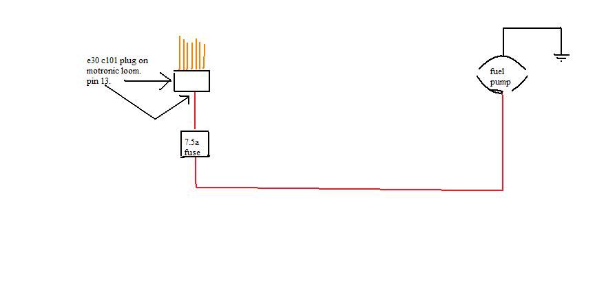

Thanks a lot guys, so let me clarify it properly now I locate the fuel pump which is under the car somewhere and find the live wire, match that wire in the fuse box and connect it to pin13 of the e30 plug with a fuse inbetween and earth the fuel pump. The thing with the 3 brown wire in the back under the back seat do I need to touch that or modify it any way. Shall I leave the brown wires connected as they are?

hey murran I got under my car and found the fuel pump, the fuel pump had two wires one which was green with thin black line and other was just a plain black wire. I assumed that the green was the live. So i traced the same wire in the fuse box and connected it to the green/violet wire (pin 13) i ran a live wire in between both the wires and didnt put a fuse for the mean time just to see if it works. As soon as i connected the live to the wires i could hear the pump but there is no petrol coming out from the fuel lines in the engine bay???? i just held both the fuel lines in a cup just to see whether if i was getting any petrol coming out...nothing. But i could hear the fuel pump pumping something.

Can someone please send me diagram on how to wire the pump. I connected it but it stays on constantly. I need to wire so it turns on to the ignition so it only turns on when i turn the key over. Im doing something wrong. Please help

have you got a live all the time at pin 13 on the motronic loom then?
