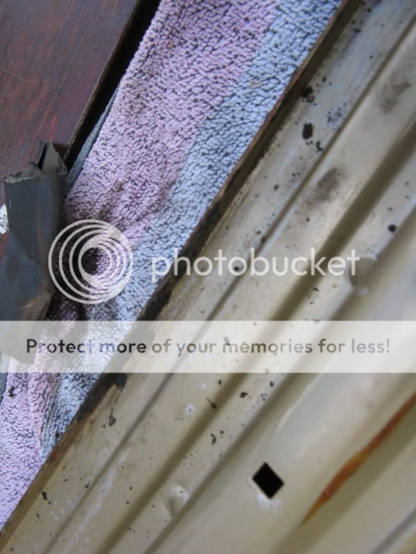

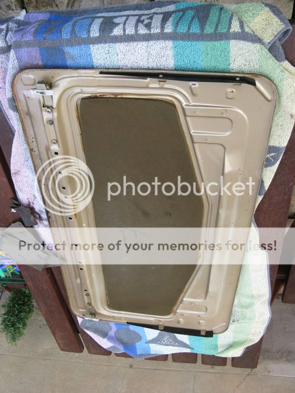

Got the sunroof off and discovered the horrors that lay beneath.....rust.....water.....scratches = fu*&ing nightmare!
I have a plan tho! Ill put some pics of the mess up in a bit
Wakefield Hellfire
- DrGonzoPOW
- Posts: 990
- Location: West Yorkshire

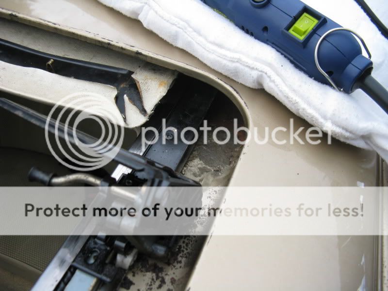

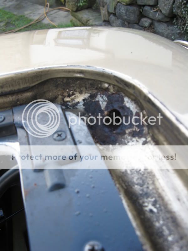

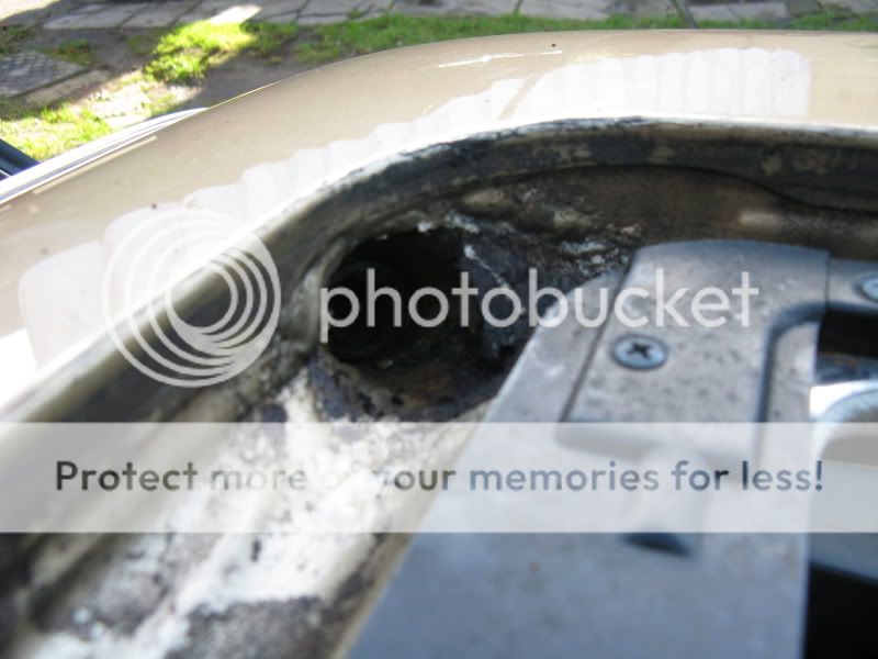

Re: Seals - leaks :(
Right, the good news is that the rust behind the rear gutter under the sunroof is not terminal. Its flakey but seems solid so im just going to grind away the shit, fill it and paint it.
The bad news, and it is chuffing bad news from here on........The front drain channels are shagged, properly shagged
The panel came out and there's just a 2 inch spot of rust under where the seal sat so thats not too bad...But it got badly scratched on the roof when i had to force it open so i could get to the fixings and take it off, gonna have to be a spray job
Anyway, the good thing out of this is i now know why its leaking!!! My plan is to grind and cut all the dead metal out and then either use some thin sheet metal or plastic to place in the corners along with some hose pipe to join into the drains. I cant weld so its going to either have to be siliconed in or i might use some car body filler to join it all up. Then ill give it all a lick of hammerite and waxoil. Just started with cutting the shit out now but as usual when you want to do something its chuffing raining, and ive got a stinking hangover. Ah well
