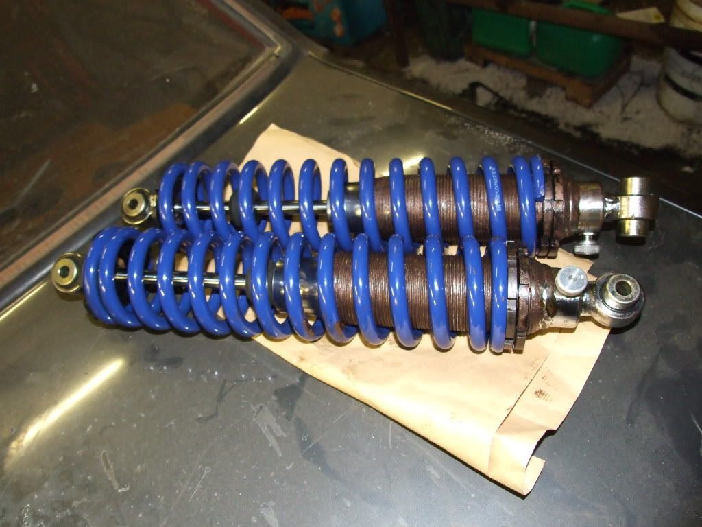

Are the rear springs 2.25"? Do you have any scope to move the coilover away from the tyre where it bolts onto the trailing arm bracket? I'll be interested to see what Gaz have to say!
Mine clear with no issues, they're not Gaz but are designed for E21 trailing arms. My MiM's are the same offset and width so you maybe ok! Here's mine for reference, springs are 12" long and I use them on the lowest height possible, so the spring is right down to the trailing arm and it still clears.

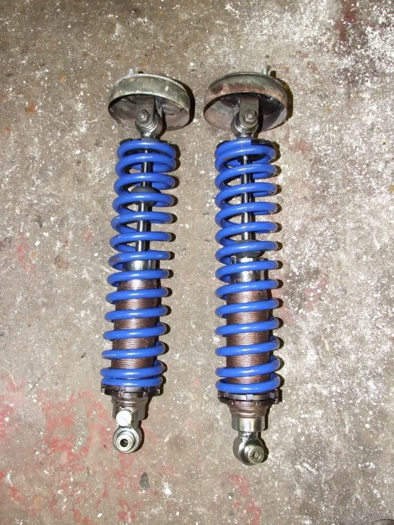

what top mounts do you use with those dampers?

I pulled all the rubber out of standard E21 top mounts so all thats left is the metal, welded a thick plate under neath the top mount, drilled the plate and bolted a clevis onto it.
I know others have got thick plate, drilled bolt holes for the top mount bolts and mounted a clevis in a similar way. My way was pretty easy and does the job perfectly.
