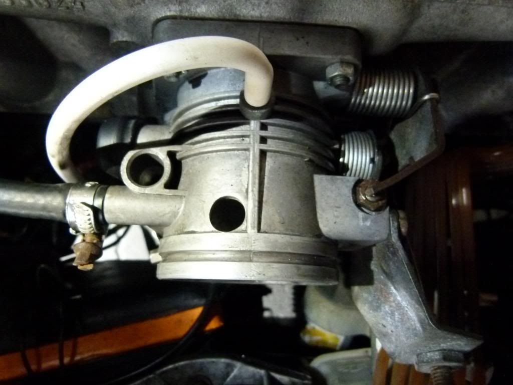

Digging into the K-jetronic i found that the Throttle Screw O-ring was totally worn out. However i also found a big hole in the throttle housing (man made), plugged with a large screw that came out in the air-stream through housing. Looking at other photos, Jeroen´s photos of his -81 323i baur has no such hole. Anyone seen anything like it, and what is it for?

Curious what you mean but the pics don't work.

Back on topic, never seen a hole like this in the throttle body myself!
The hole on the right that is, the left one is for adjusting the idle rpm's, that's where you removed the screw with the bad o-ring.

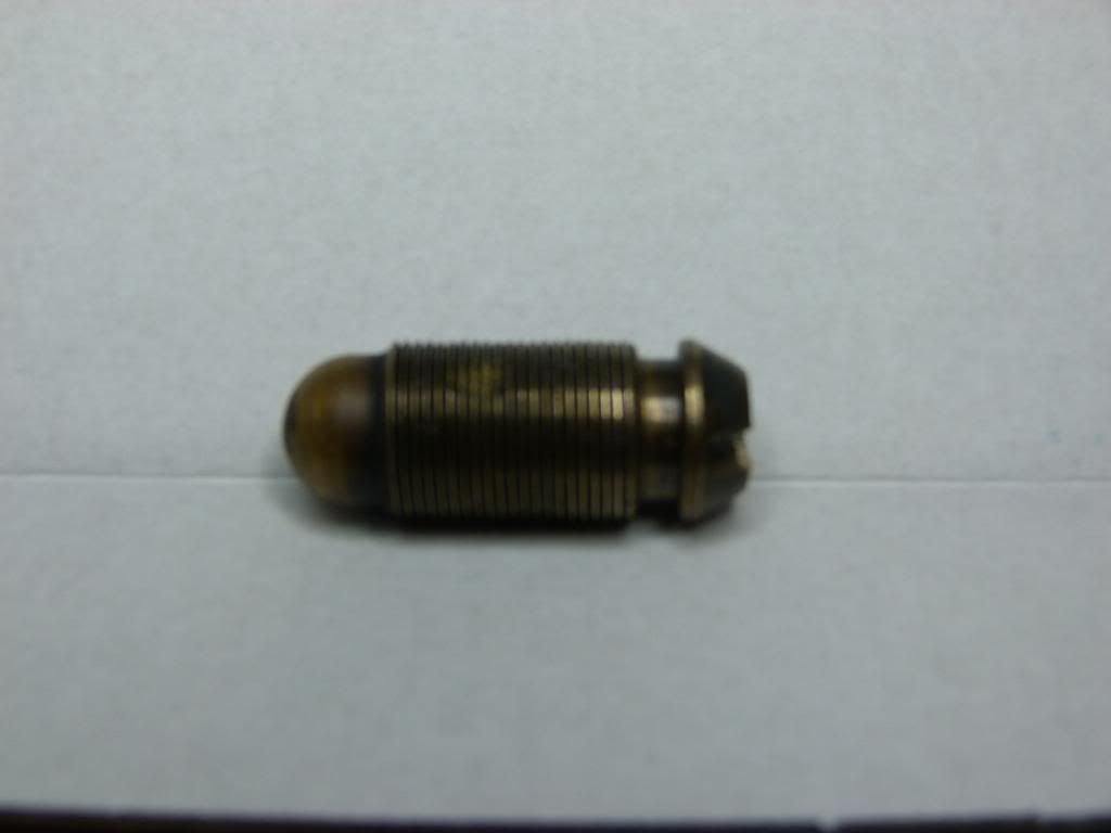

Post by TorEnholm »
As you said left hole is for idle adjustment and the o-ring there fell off the screw as i unscrewed it. The hole on the right (almost center) i have never seen in any manual or here on internet. It has the screw as below, with o-ring. Also this o-ring was bad. The screw below is also through that hole sticking about 1,5 cm into the airstream in the throttle housing. I think the screw that looks almost like the idle screw, only acts as a plug.

Re: Engine runs unevenly and pinking on accelaration
Must be some mod done after production, perhaps for LPG/LPI injection at some point during the car's life??
