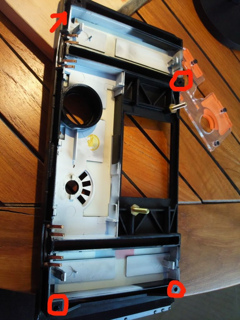

Re: Interior lighting
There's only one bulb in the centre console, you can reach it from above through the "speaker" panel. Assuming you have a NFL model?
Oww and there is one above the asstray, will need radio removal and very tiny fingers for both lights.
You can change the lights in the switches by removing the front caps.
Pics from the panel rear view
All black cables you see are light transmitting cables for the different switches, where they come together thats the position of the light.
Also the blank plastic strip is light transmitting material

Mike, that's an excellent pic - worth a thousand words.
I do have a "speaker" grille so I'll have a look. Unfortunately, I have fairly large hands :roll:
How easy is it to pull the panel out as you have done?
Is it worth putting some kind of grease on the temp/distribution toothed quadrants or do they operate fine in a dry state?

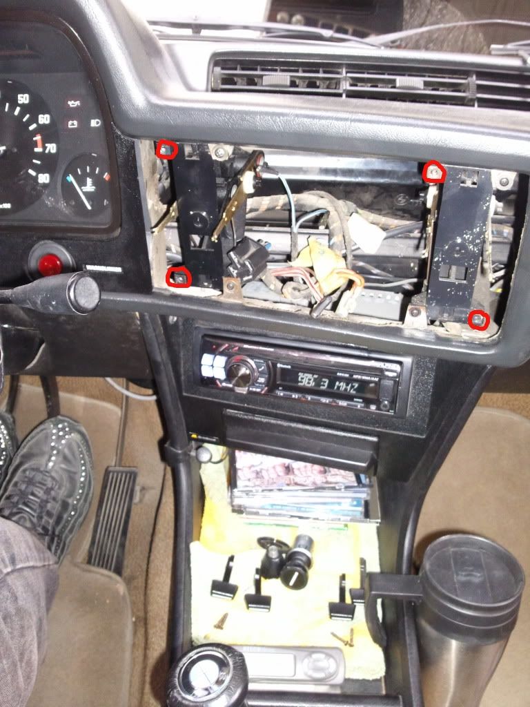

My car is early model
In order to remove the centre part of the dash panel there are 4 screws
I replaced a couple of bulbs there, it was fairly easy.
I will post some pics here
I haven't yet tried to remove the left part (left of the steering wheel, where are placed the 4 switches of lights, antimist, front and rear foglights.)
Actually I was thinking that this one was not lighted, but Jeroen replied to me the opposite on this thread (see above). So I will try it as soon as I find some time to do it.

petroscf wrote:My car is early model
I forgot to mention: in order to remove the centre part of the panel, after taking out the 4 screws, the lighter and fan switch have to be taken out.
The fan switch is a bit tricky to remove but doable
Good idea also to give a good clean to all these parts, will result to a dash way brighter than before
