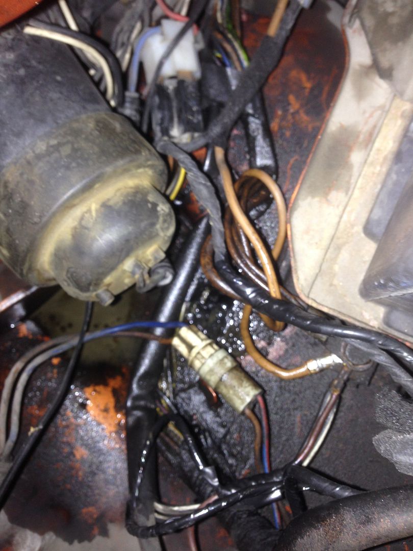

I forgot to take a pic, but I 'll post one here, a rather big oil spot appeared on the insulation foam exactly over (on top of) the fuel pump.
A friend with experience on M10 engines suggested it might be the Bakelite (plastic) part of the fuel pump where the pump connects to the engine.
I guess if that is the case, it might not be a big deal, a new flange might solve the issue

Finally it seems it was the fuel pump
It let some oil pass through
Replaced now
If the problem continues, we will replace it by an electrical one

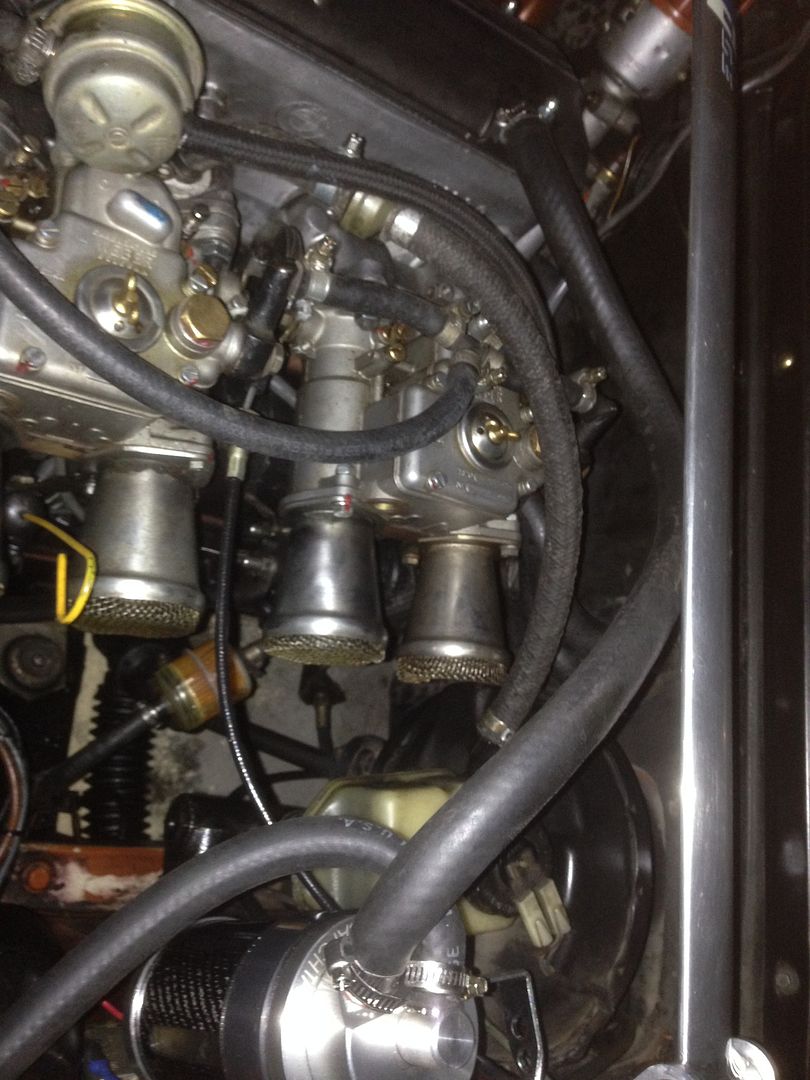

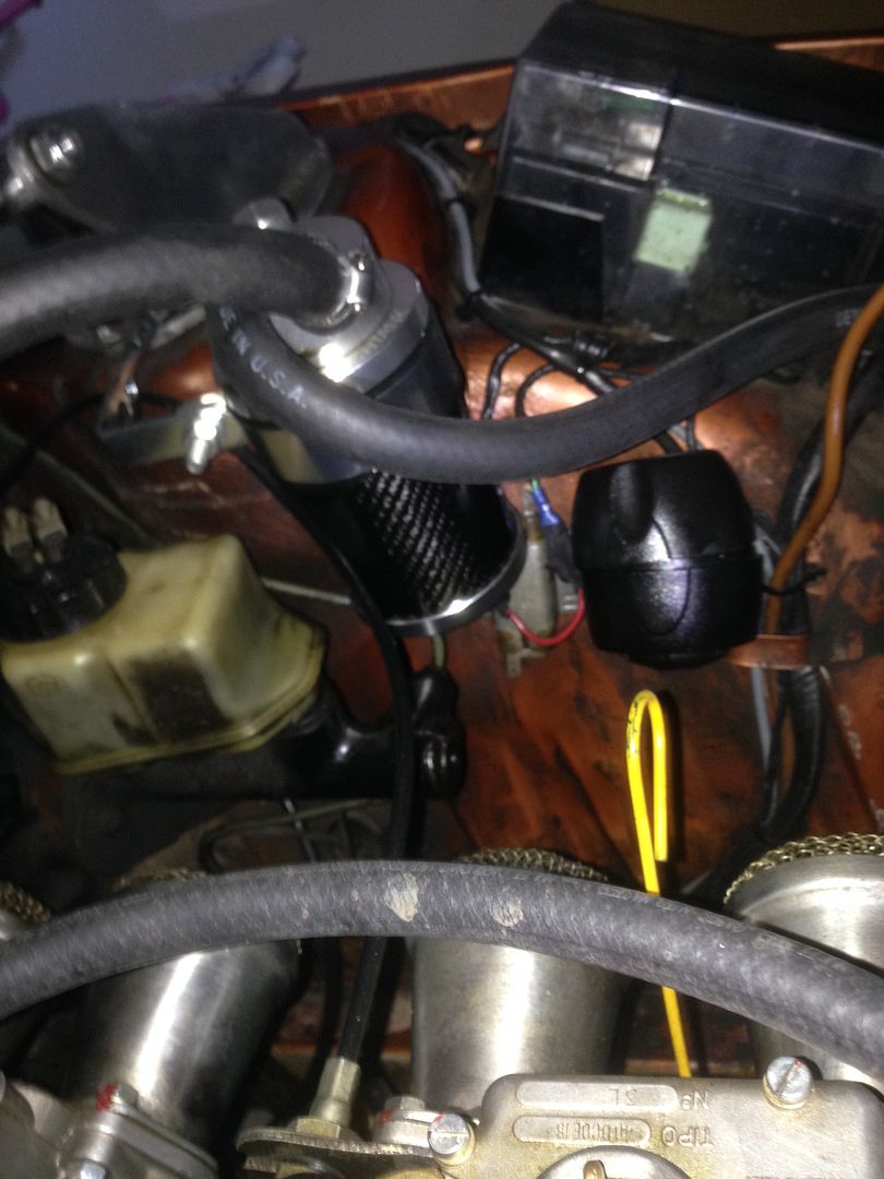

Hi,
From your photos, it looks like your oil catch can isn't connected up fully, you should have another hose running from the outlet of the catch can to the intake, where those fumes will be burned and expelled through the exhaust.
Otherwise although you are catching the oil mist in the fumes, you are just venting the smell/fumes into the engine bay.
Dave.

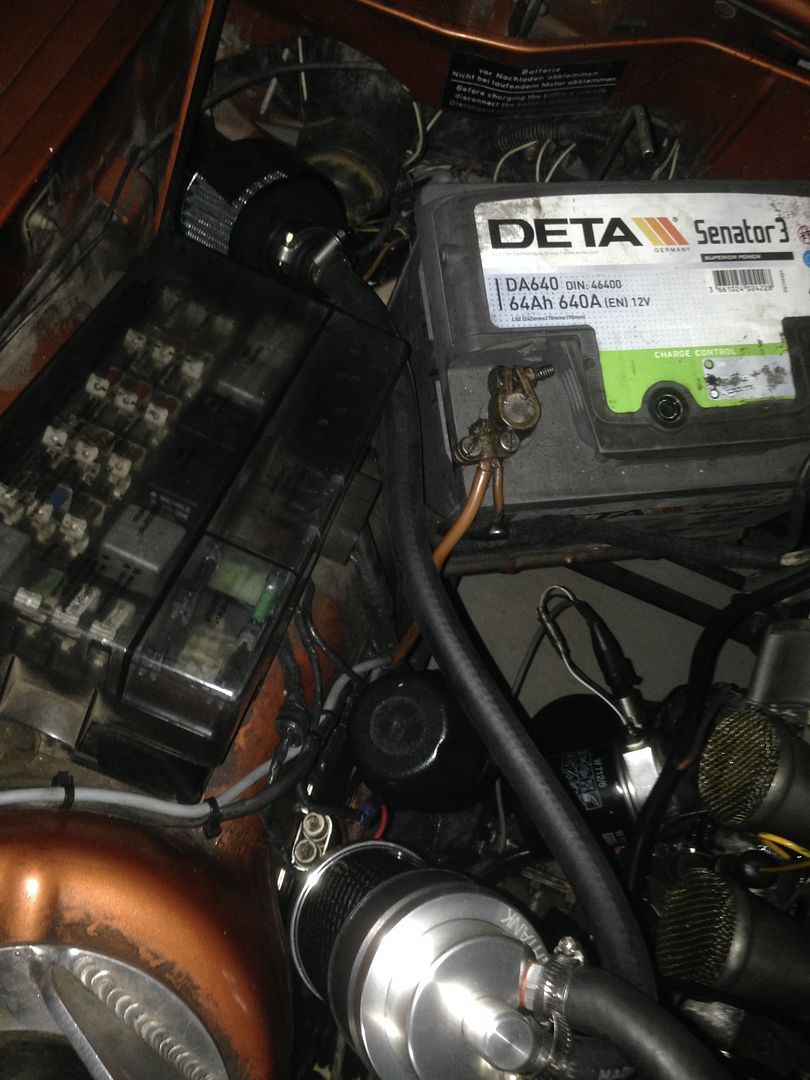

It seems I owe an update with some pictures here.davidvincent wrote:Hi,
Dave.

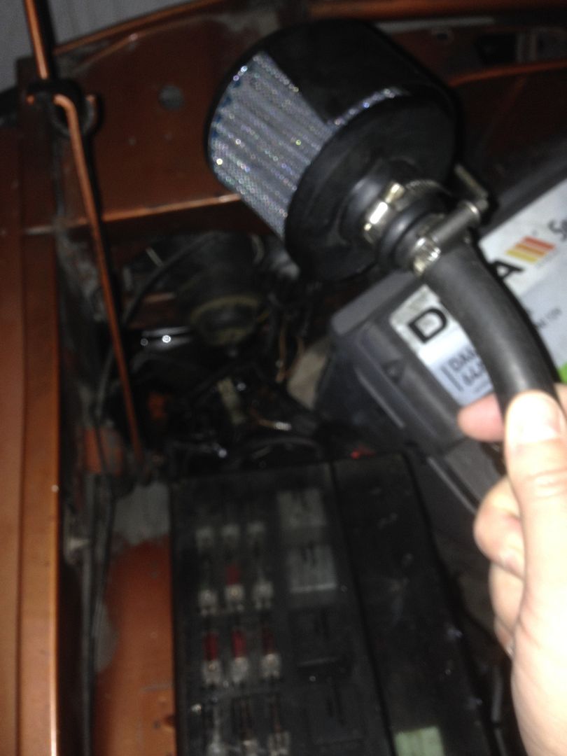

We have already done something here, not exactly what you said, but :
We connected the oil catcher's outlet to a hose and the other end of the hose to this:
It seems that this has led fumes further than air vents so I still smell them (!) but fewer now, as it seems they escape from elsewhere.
The problem is that oil still goes out from this little filter:
The engine's inlet manifold is of this type:
So I can't see where a hose coming from the rocker breather could be connected
May be the solution here should be to fit plenum type air filter box on the webers? instead of the current setup (which I have to admit produces perfect music to my ears...)
And then connect the hose coming from the breather to the plenum, so the fumes go inside there?

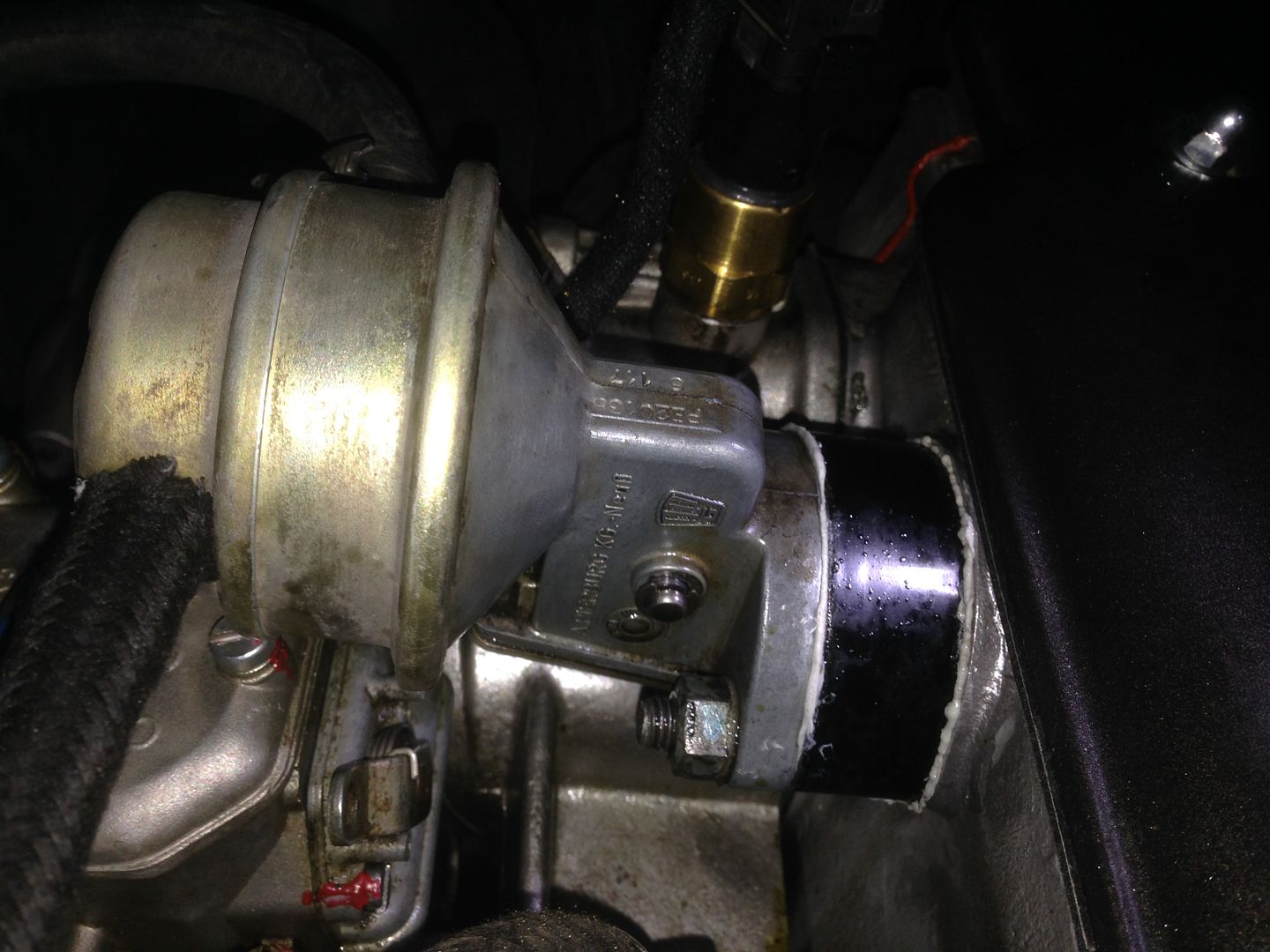

Now, about that fuel pump spitting oil (mentioned already above and/or in my build thread)
We replaced it but I can still see some oil "teardrops" - so that might mean that if rpm increase up to 6000+ like the other time we might have the same result?
maybe the solution here is an electric pump?

Yes that's a common solution, to add a little bike filter on the end - but if you're still getting oil out from that then the catch can isn't working, perhaps you need a more expensive baffled can?
But either way, that amount of blow-by shouldn't be expected on a rebuild engine - did you rebuild top and bottom of the engine or just the top/head?
When the engine is running, take the oil filler cap off and balance the lid back on loosely - does it blow off, or can you feel a lot of air rushing out?
I use an OBP http://www.obpltd.com/Alloy-Products/Catch-Tanks) catch can, but I have a 6cyl engine with a Weber Carb setup, with a K&N air filter - I had to adapt the base of a K&N to accept the hose from the catch can, so I have no fumes in the engine bay (or car) now.... but if you're still getting oily deposits after the catch can stage, then you need to consider what is causing it (excessive blow-by, or a too basic catch can, or both).
