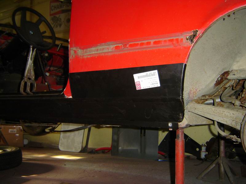

some progress is made again....
I'm very disapionted with previous owner's mechanic's work.
He glued parts with sylicone kit and make no protection on "new" parts he puted on, so after one winter everything came to surface....

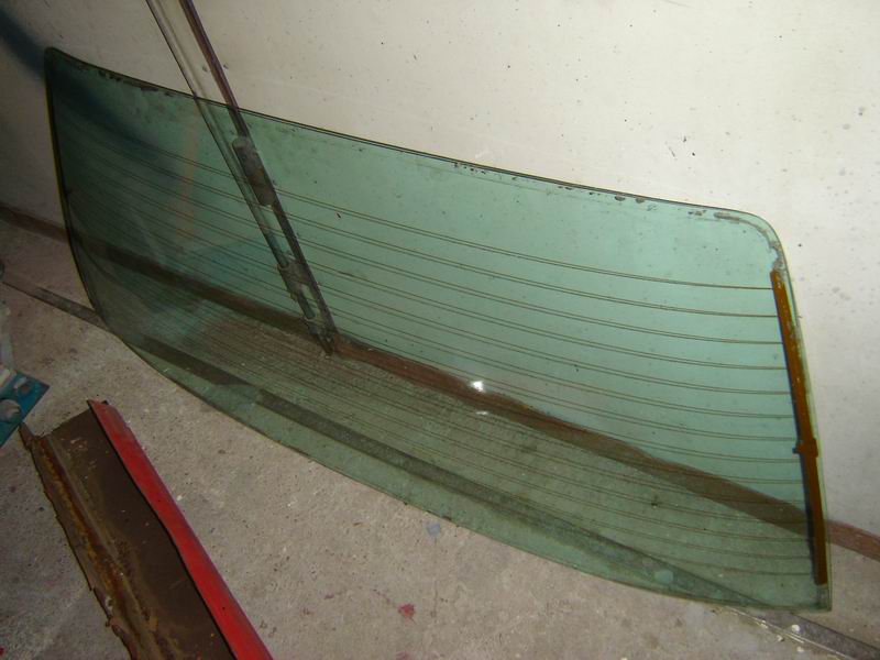

here is green tinted window...
does anybody knows if rear spoiler from M535i came with some other model unstead? (I think that someone on forum have that spoiler)

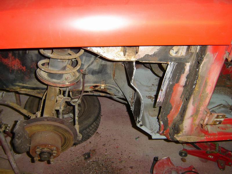

today we remowed:
exhaust system, mufler is asso (all brand new)
fuel tank
complete rear axle including driveshaft
rear suspension also band new
rear glass (unfortunatley we broke plastics pieces that have to be remowed before remowing glass)
I have no pics of done job.
maybe tomorow or other day.

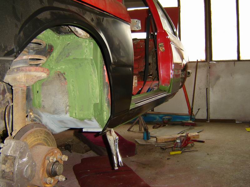

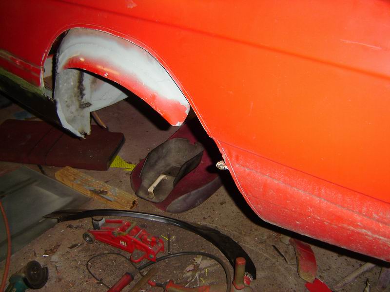

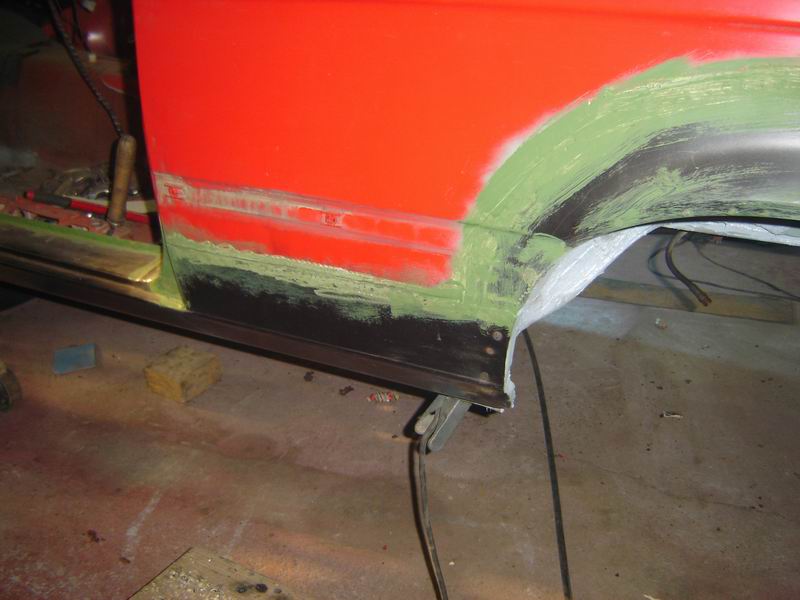

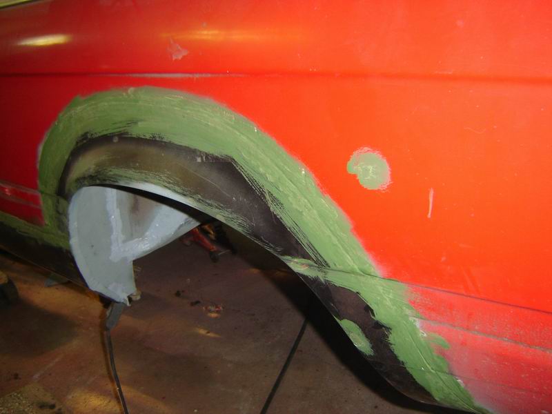

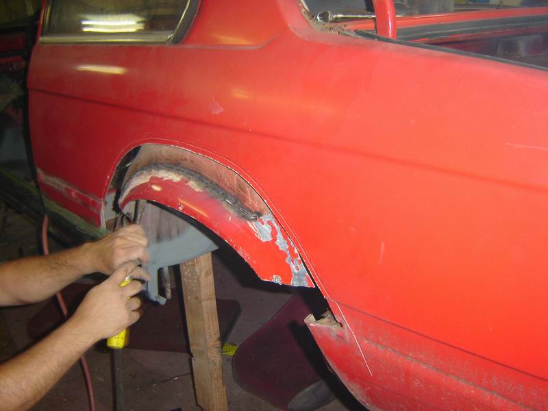

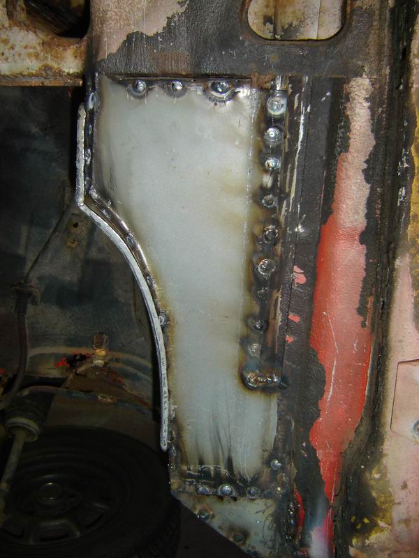

hello!
this is what has been done in last 2 or 3 days...
rear wheel arch has been cut off and rusty part remowed.
inner arch is like new now, and on top of it's brand new arch.

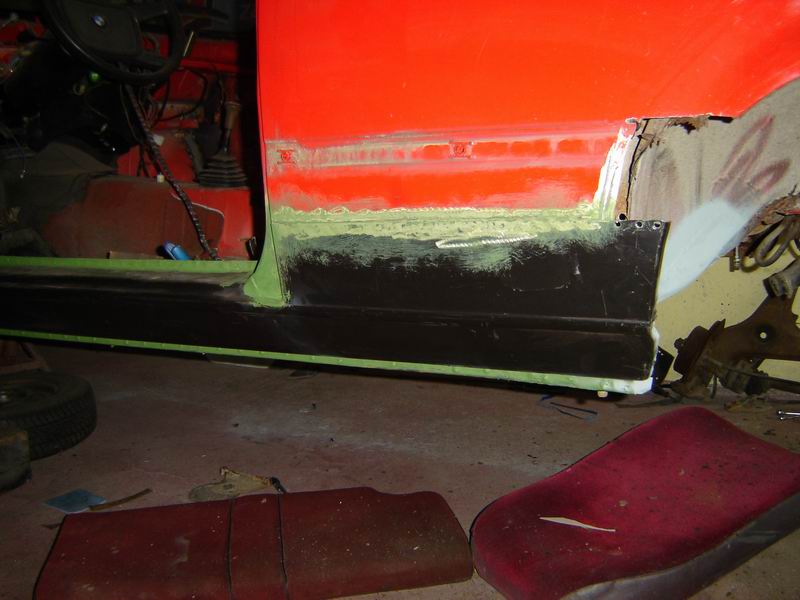

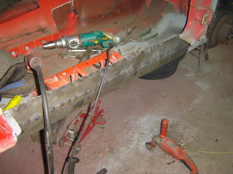

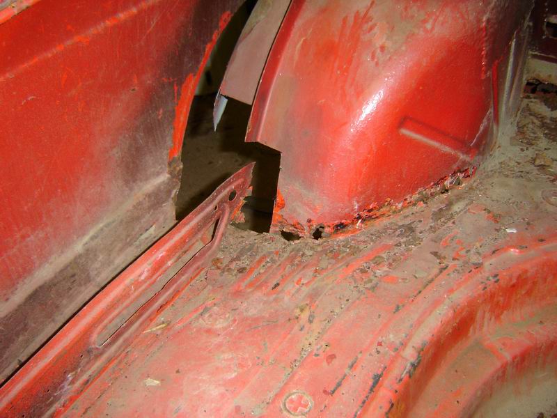

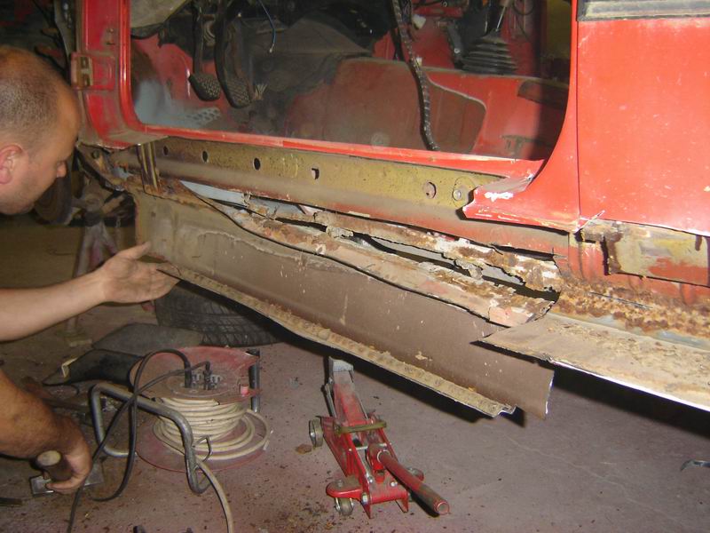

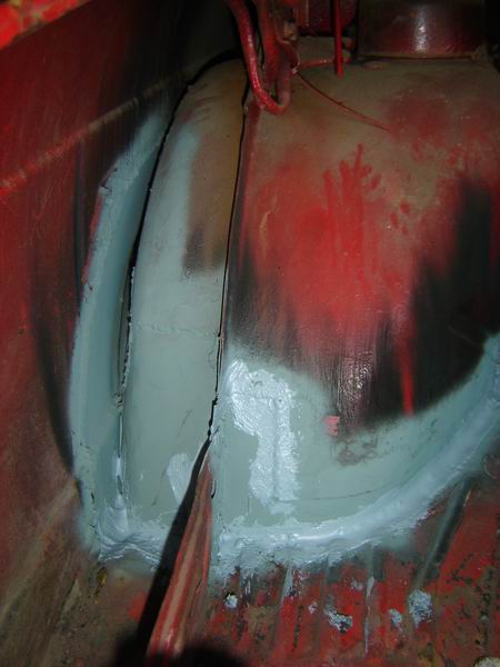

f****n rust!
we found out that left panel was replaced probably 20 years ago when the car was still "new", but it was a pro who was doing it.
rear lights almost fall apart when we tried to remove them.

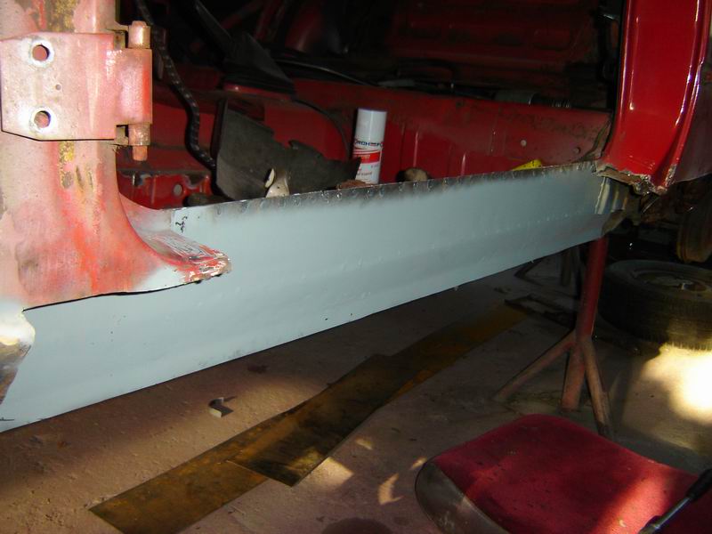

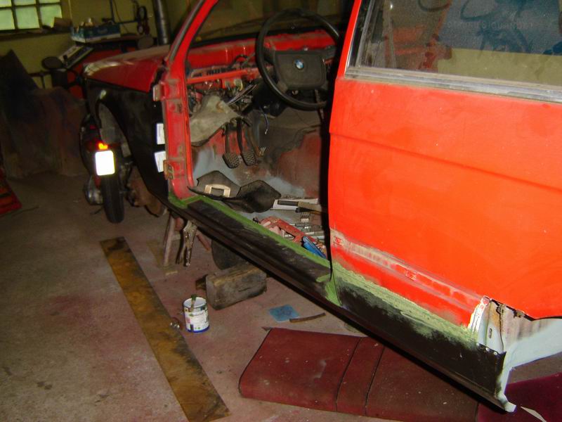

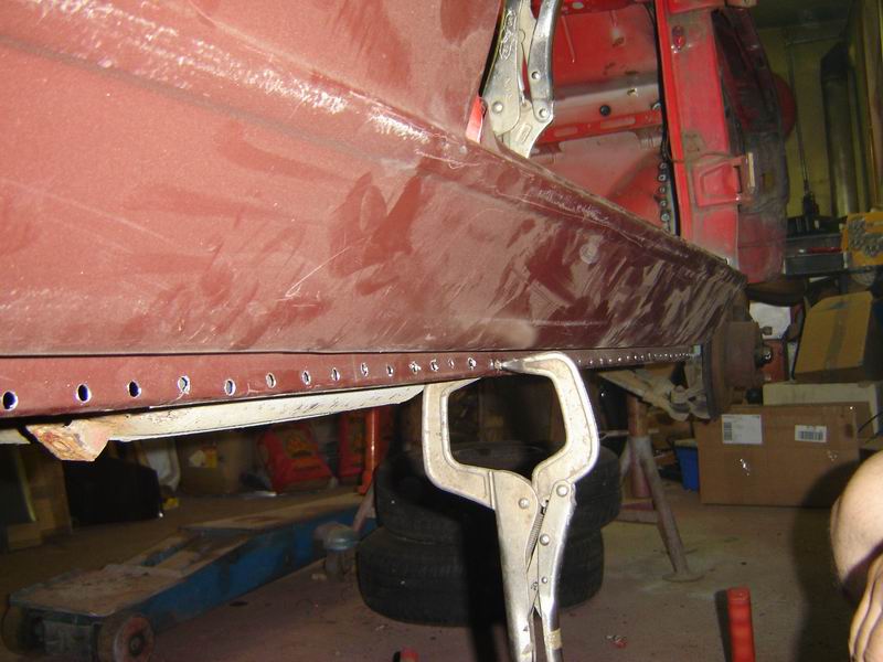

some holes have been fixed in past fiew days...
and right side will be like new again very soon...
