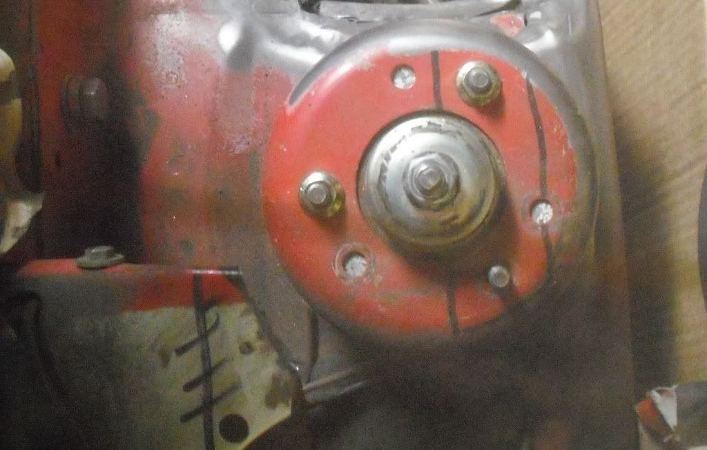

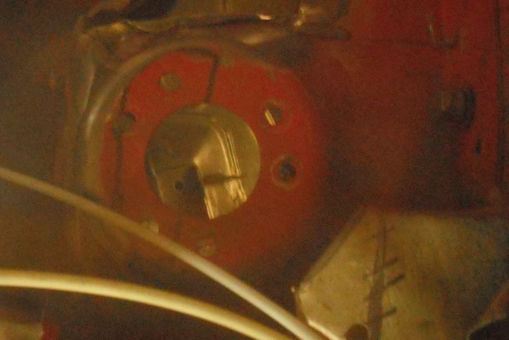

and another thing i noticed, the holes in the chassis arent symmetrical? is anyone elses car like this?
left side:
right side:
considering this, im thinking that the best solution may be to make a plate like the one ive made, but get it welded to the chassis and bolt the bearing housing straigh to it. opinions/thoughts???
left side:
right side:

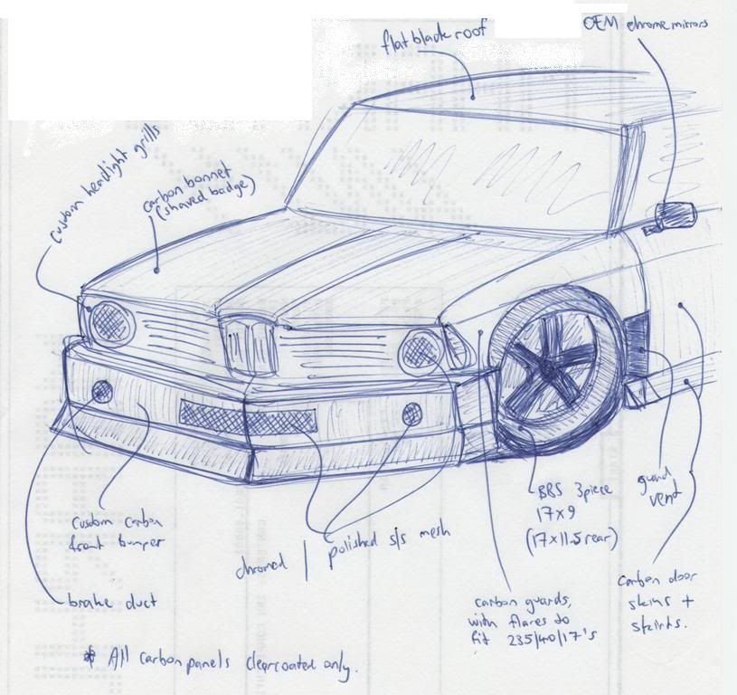

Anyways, I did a bit of a scribble today for what I'm thinking as far as plans for the next year or two, so let me know what you think. The overall concept is to keep going with the theme of many differnt influences. ie. Its a German oldschool road car but with new race-spec parts, Japanese-powered but American hotrod inspired engine bay, VW-scene style wheels, 'Stance'-style ummm stance... etc. The body kit will draw from the old 2002tii race bumpers and also from the current drift style kits (but with slightly less of a 'snowplow' feel I hope). There will be a bit of 'Time-attack' style thown in the mix too, but more at the rear of the car. If it all turns out pimp-my-ride-ish, I can always convert everything back to standard!
The only thing I've not drawn in is an external oil cooler ('Bozu'-style), which I think look pretty awesome if done right.
Re: Nice V8 project
hmmm, no responses to my plans, im not sure if that is good or bad...
