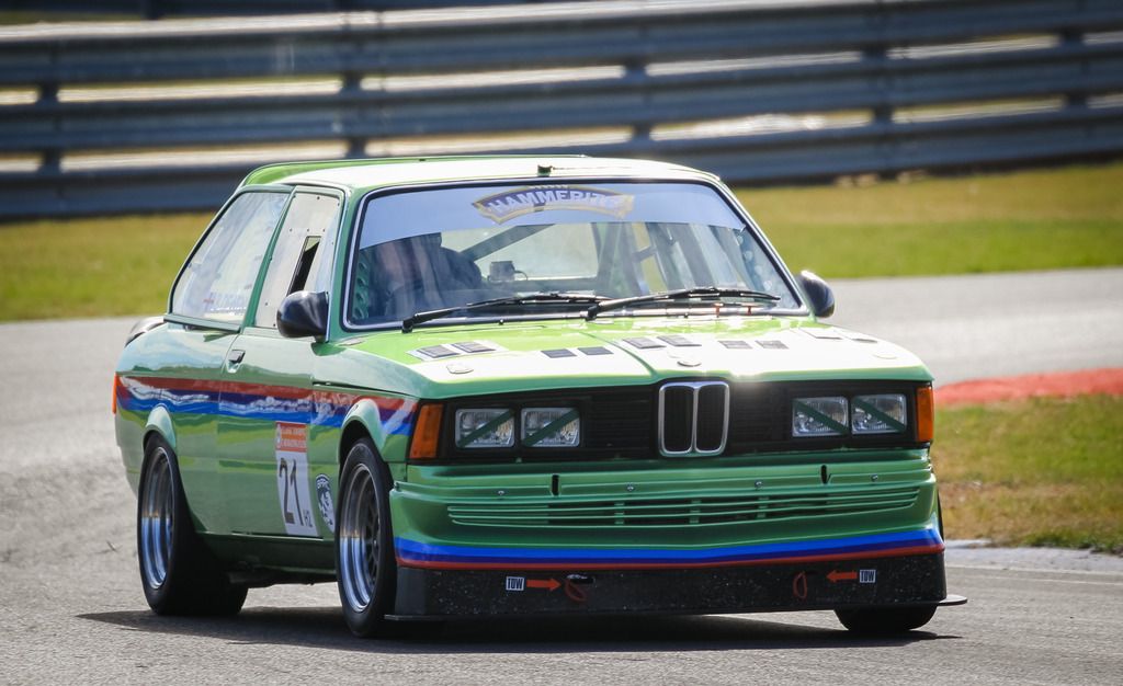

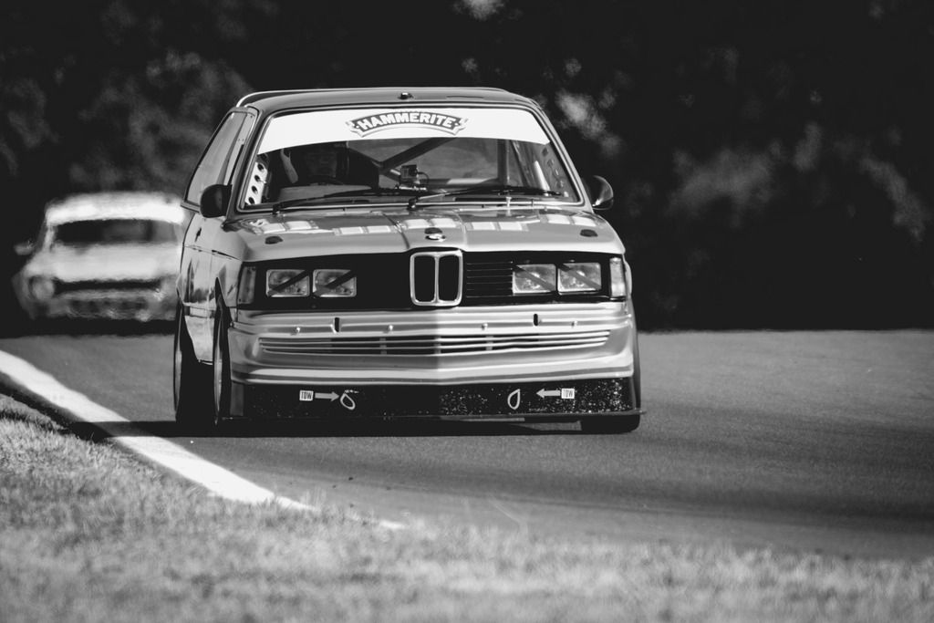

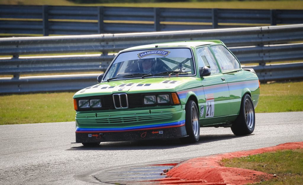

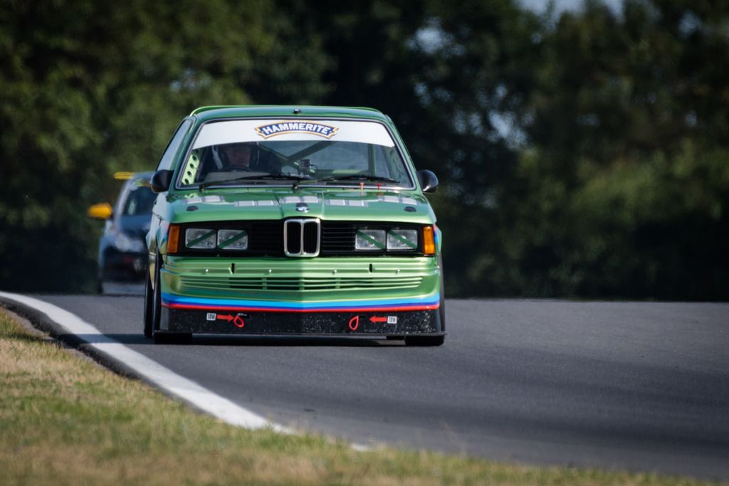

Some pics from Snetterton in September

That’s a proper way to use an E21

Very nice view!
