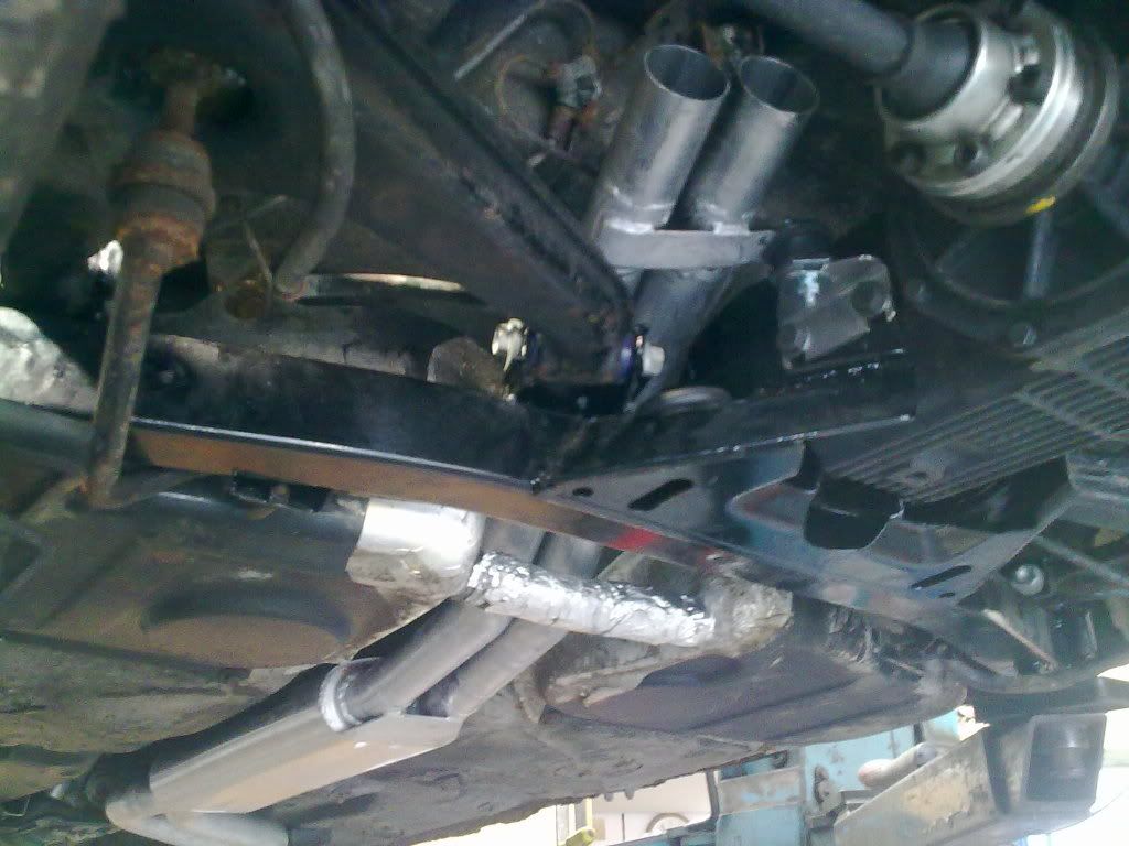

Managed to fit both the E46 S54 manifolds cut off just after the collector.
Will be a twin system with crosspipe and 2.25" near the manifold reducing to 2" over the rear beam.

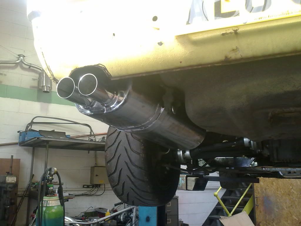

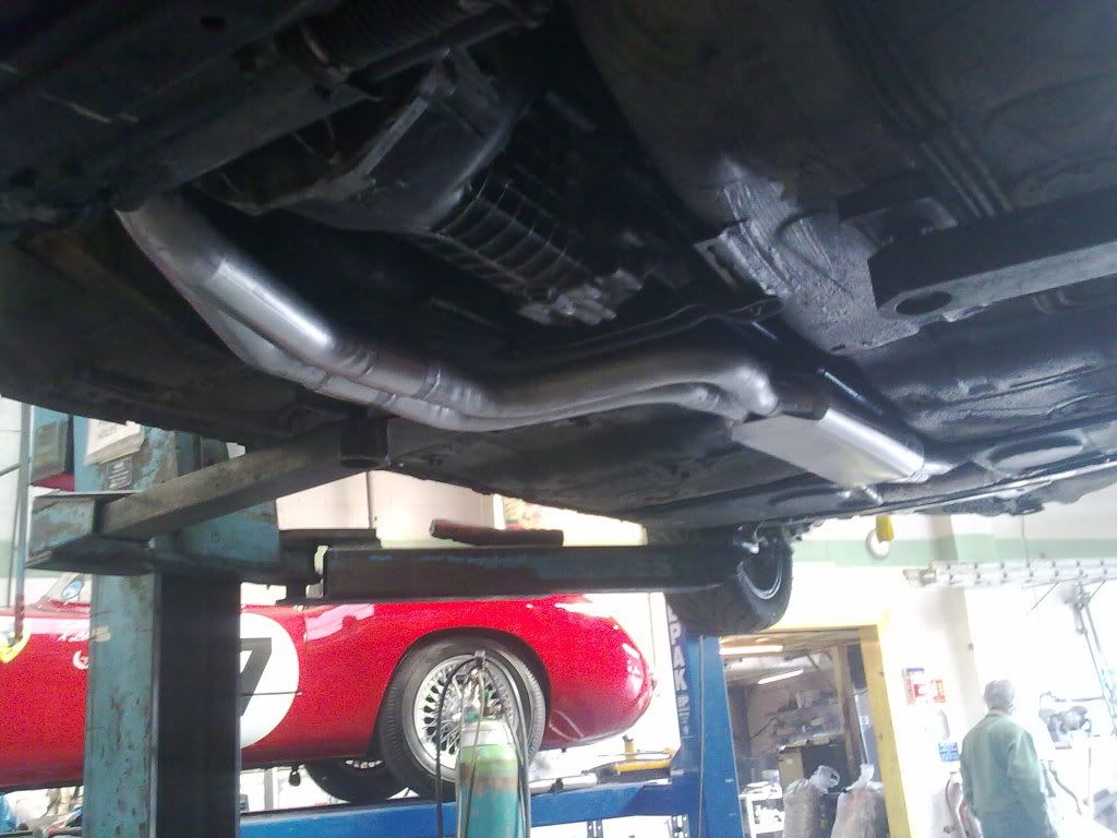

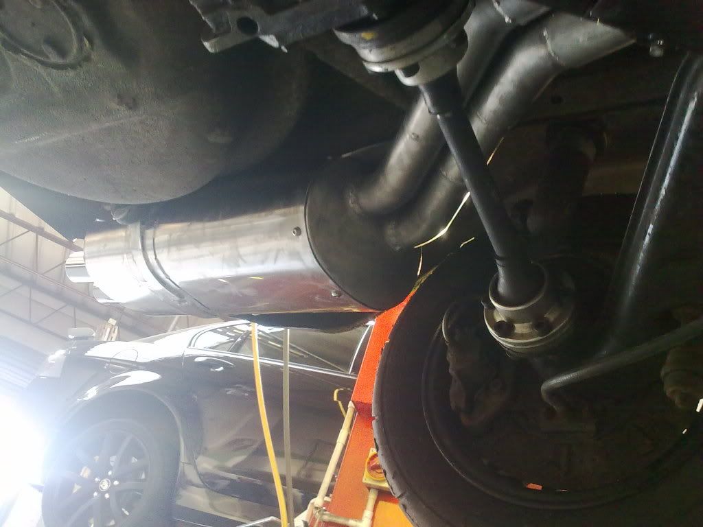

Exhaust has been made, using std S54 manifold cut just after the collectors. 2.25" pipes from the manifold to the centre box with a cross pipe just in front of the box with a Lambda boss.
2" pipes between the tanks and over the beam (largest that would fit).
Repackable rear silencer with twin 2" tailpipes.
I picked the car up then transported it to Emerald where it is staying for 1 to 2 weeks for the final mapping etc. Can't wait to hear it :boogie

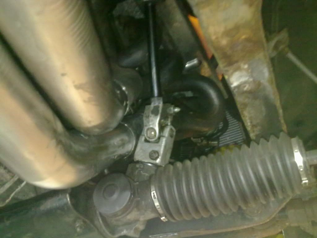

BTW isn't that a plastic cap on the steering rack the manifold is pretty close to? Any risk?
For the rest: wonderful and not exactly undersized

Jeroen, Yes quite close but not as close as the steering knuckle, once I get the car back from the RR I'll be checking everything underneath for heat management. Probably fit a small alloy shield between the two. I've got to get the tanks out as well to find a leak when full of fuel. Nearly took out the passenger Tank to give more room for the exhaust but decided I'd rather have the capacity for longer races and for road use.

Yes totally std E46 M3 manifolds from a 2003 RHD Convertible. They were cut at the 3to1 collector. New pipes welded on from there.
The new pipes do run very close to the steering links and floorplan, however I'm running solid aluminium engine mounts so theres no movement.
They won't fit to an S50 though. wrong flanges.
