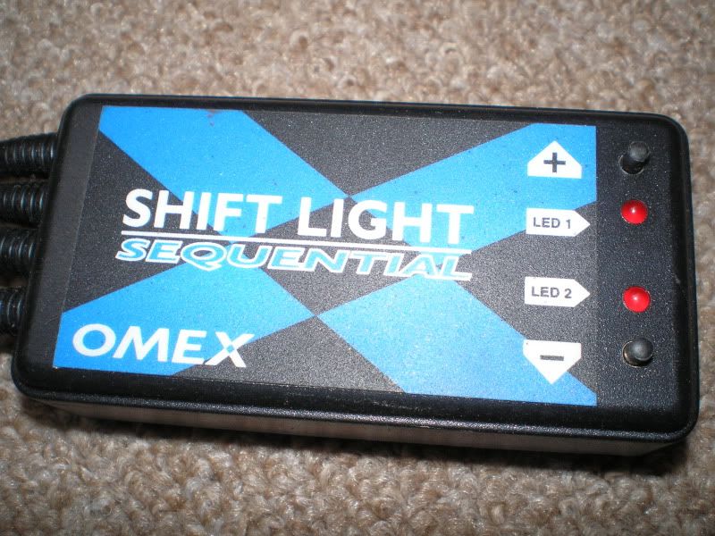

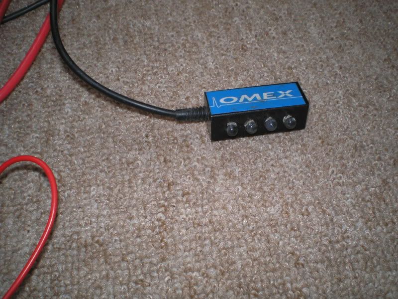

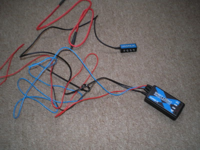

and the sequential shift light
why do I need it? Simple, if you hit the car hard on the bends, you dont have time to look on the RPM gauge, many times I was in the limiter because of that, this lights are programable, currently starting at 4200 rpm, second 4800, third 5400 and red 6000 (200 before the limiter kicks in). For testing purposes I fitted it in front of the e21 tacho. I have to take pictures of the finished product, hidden, visible only at 4000+ rpm.
and the link if someone is interested more in the technical way
http://omextechnology.co.uk/OMSLS.pdf
