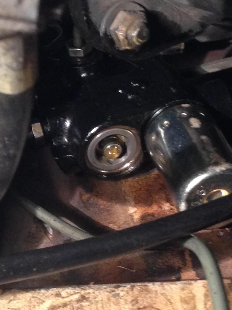

Re: 316 - 1977 - petroscf - Greece

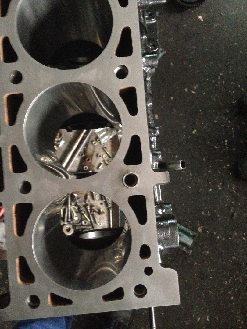

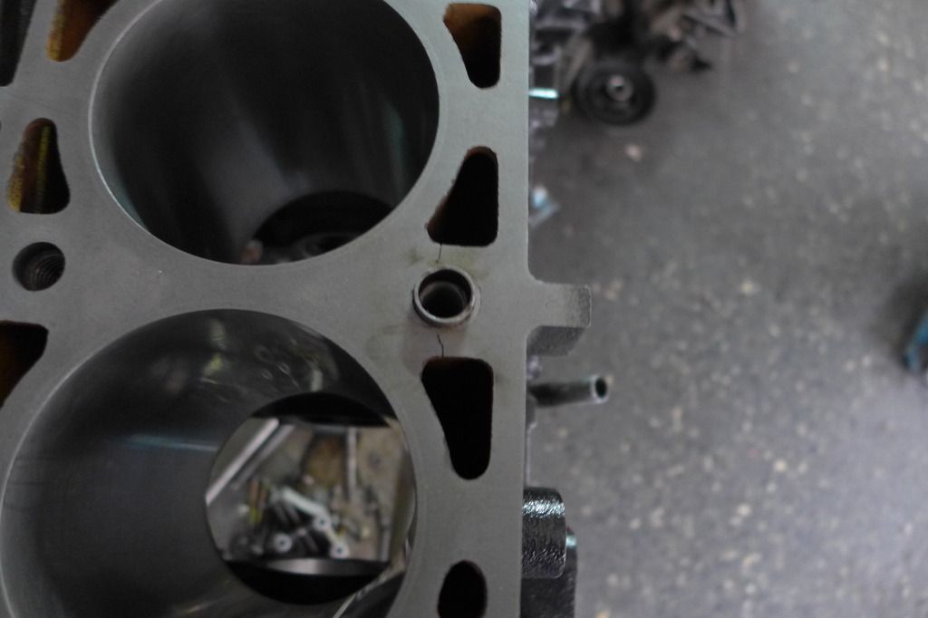

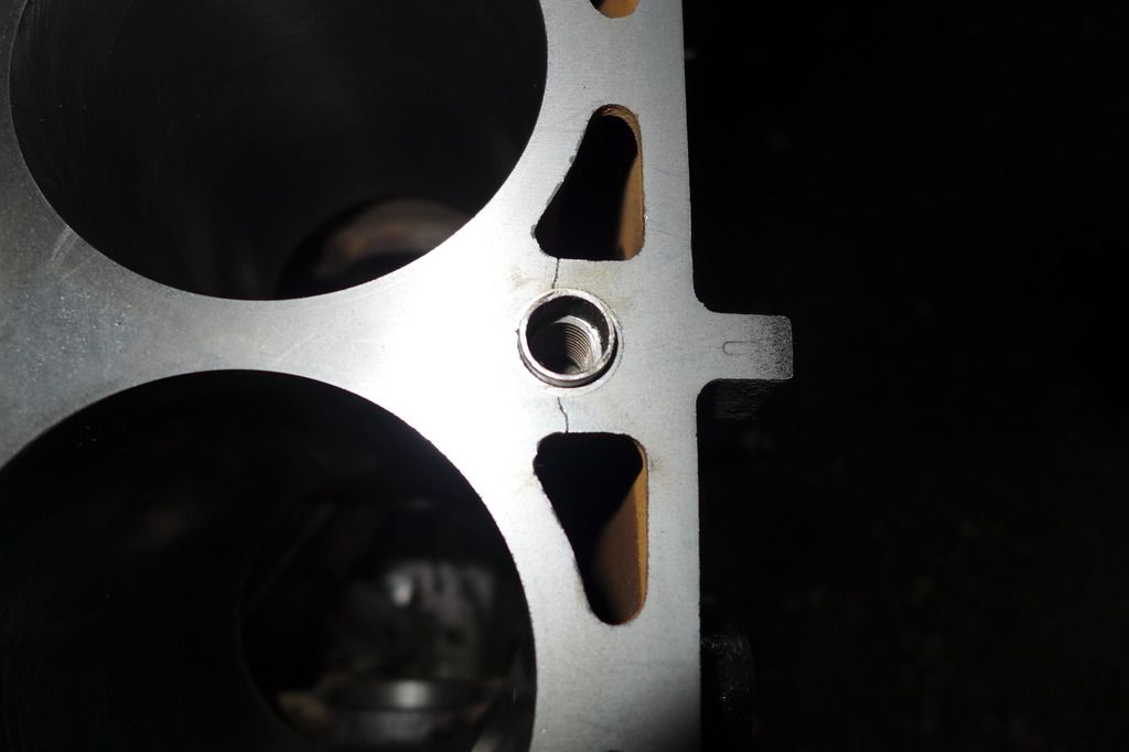

Hopefully soon I will be able to upload some better pics
Worried about a small something that looks like crack (a couple of them)
But the mechanic reassures me that this is absolutely nothing
