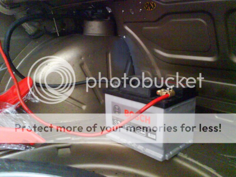

Sorted that battery in boot job today Murran. Just turned out to be a crap earth. Wire brushed the top-mount stud and attached a cable to there. Bought a thicker cable from a breaker too. 5 quid for a big 5 meter piece, good price jimmy. Attached that fuel pump fuse inside the car, makes it a bit neater. Can put the interior back in now :shake

Couple of bits done today. Finished soldering all the wires and ran all the cables neatly through the cabin so all the interior could finally go back in
Battery in boot officially done and working
