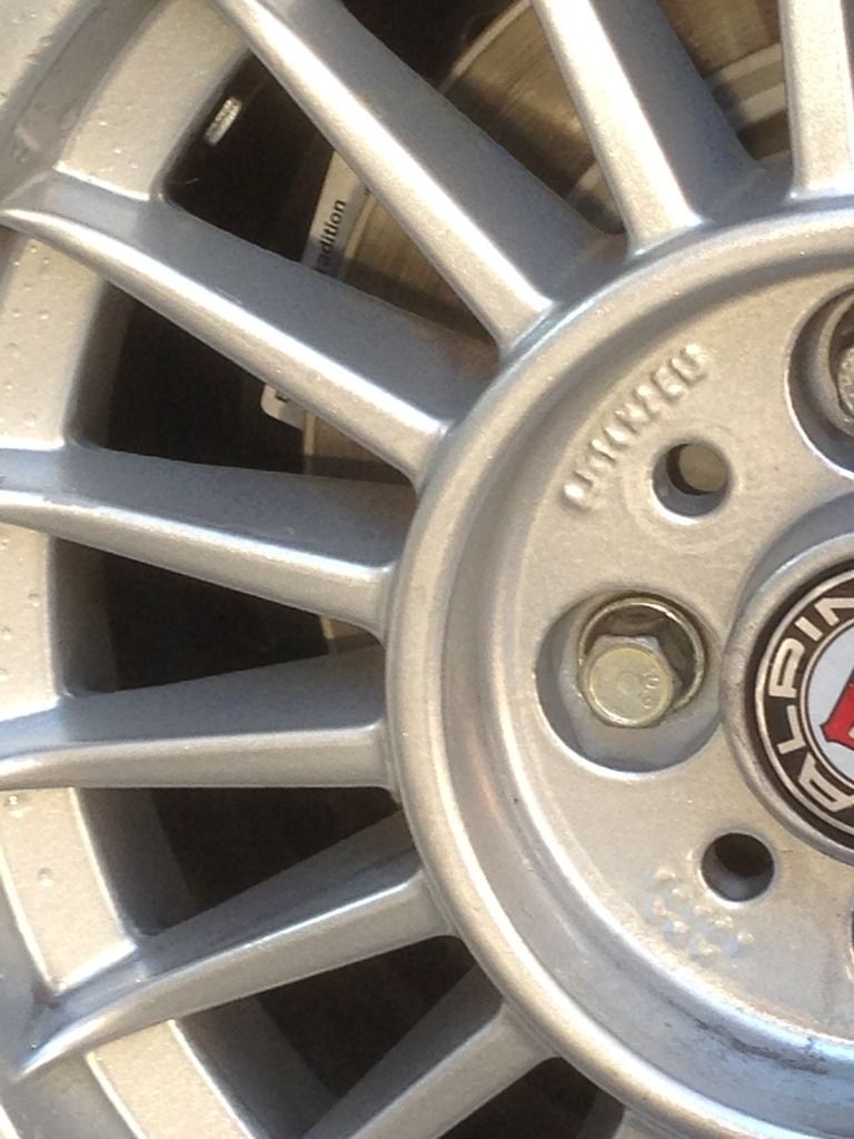

Yesterday left the car to the mechanic for its first oil change, webers final (?) setting etc.
Also he fitted wilwood front calipers, and an exhaust manifold (hand made-copy of an Alpina one) was ordered.
haven't yet taken the car, I guess he'l finish today.
We also replaced the 316 distributor by a 2002tii one (the hot spark electronic ignition was taken from the old distributor and fitted in the new one) -he said that this one has a centrifugal avance and more aggressive, it's better for this engine ?I am not sure I understand very well what it does exactly. If somebody can help I would appreciate it.
