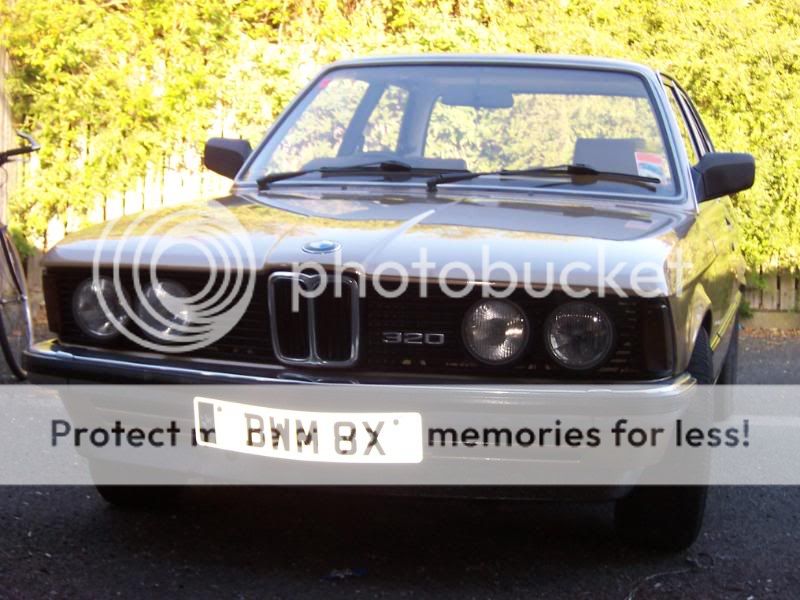

All finished after a hell of a day and here she is, i was suprised how much lower it was when i came to take the jack out - nearly chopped my arm off on the front spoiler.

Well done mate!! looks sweet now!!, you should have slipped the strut off rather than unbolting the anti roll bar, then use a ratchet belt to pull it back in to the strut when re-fitting... but you`ve done it now!! looks good!!

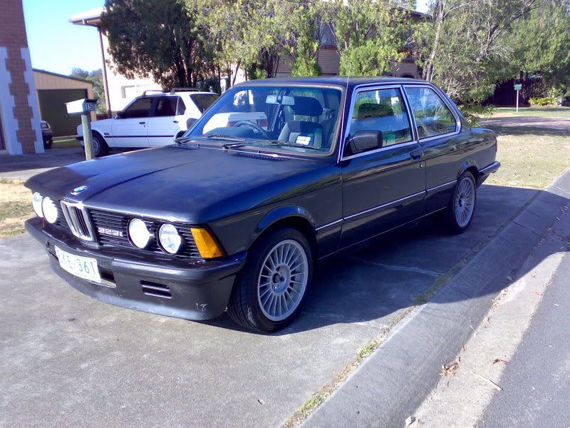

Nice job, absolute pain in the arse to do, but the rears are alot easier!! Good thing you saved them for last. I had fun replacing the shocks with bilsteins and lowered springs. But need to lower the fronts more.

Lookin RUDE! 8)
Have the springs settled since Saturday or is that as low as she's going (which is plenty far enough in my book!) ?

I took it for a quick drive later on Saturday evening and everything seemed fine (other than brakes which i have upset in some way)
Dont know if the springs will settle anymore than they already have. I did set them to the softest setting before putting them on so thats probably the lowest its going to look which is pretty much spot on how i wanted it. The only thing that worries me slightly is that the lowered springs didnt need much compression to fit them onto the struts (compared to the stock anyway). I have a small fear of them coming off the spring plates. Ill take it nice and easy for a good while until im confident with it.
