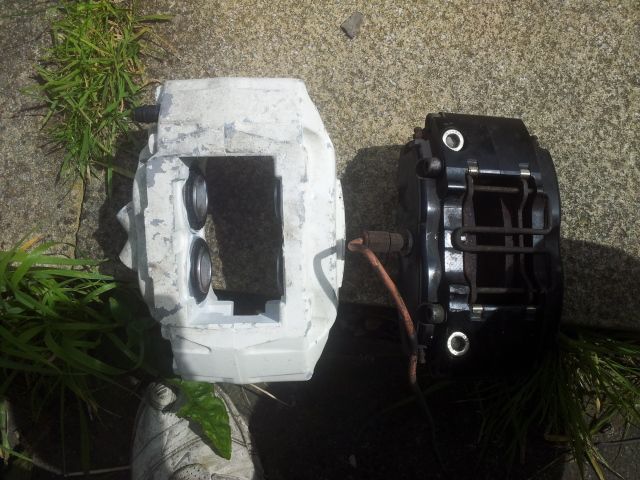

There's lots more work to do still. Lots of measuring and welding my pedal box / making brake calipers for fitting these badboys (on the left) will prove a challenge. I just hope it all clears my rims.

those calipers off a frecking HGV
Re: 316 beige uk
They are rx7 twin turbo calipers. Rx7 owners don't need to upgrade brakes till they hit 500hp or go full on racing. When I had my rx7 a few years back I used to be able to brake so hard it actually hurt.
The wilwood are brilliant on my car.. but as Im removing the booster I need more co efficient / pad area and greater leverage hense big disc. I hope this works out to fit straight on under my rims.

Soo much nicer, with the new painted bay, really worth doing. Those brakes are huge they will be extra safe for your car! Good good

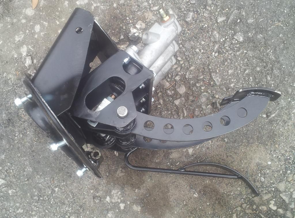

Its been a while (maybe 6 months?) since i did anything with this car, its been at bogg brothers for storage over winter and at the same time they did the final welding and strengthening of my brake bias pedal box.
]It still needs finishing because the pedals sit maybe an inch too fowards so i was going to space the masters forwards to move the pedals back a bit. I need to work out how jerry rig the accelerator cable too.
I still have a lot of braided brake lines to make / fit - but then I think i am going to cheat and use some motorbike ones. Decided to get some bulk head fittings so that if there is ever a problem or want to change something its easy to work on..
Really happy with bogg bros' work on this actually. the pedal box is a rock solid assembly

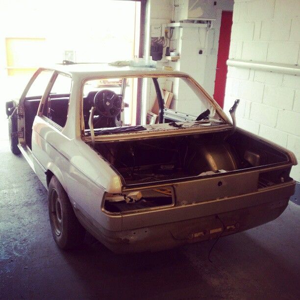

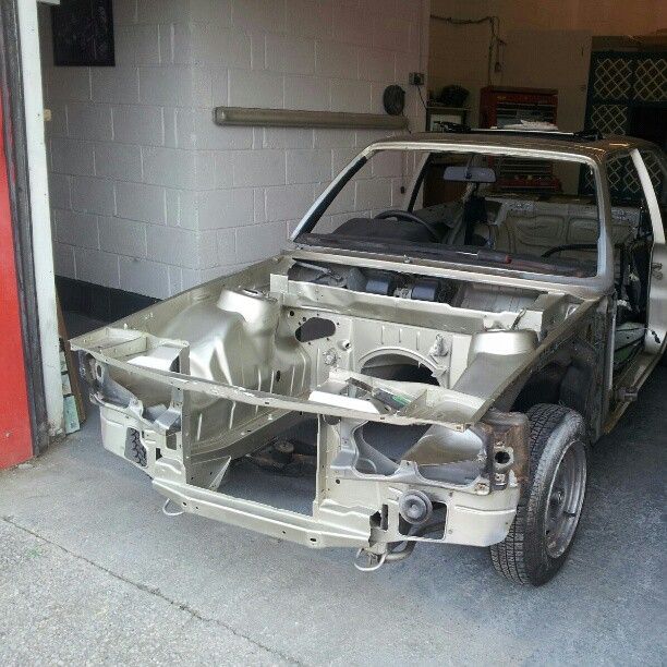

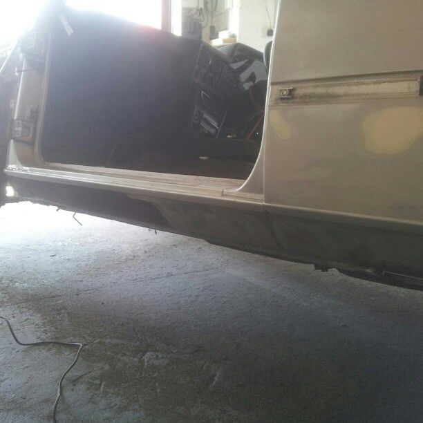

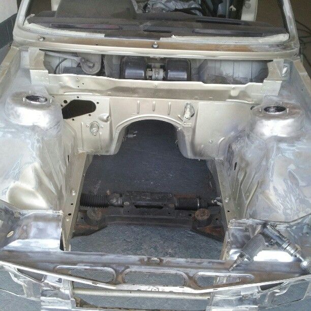

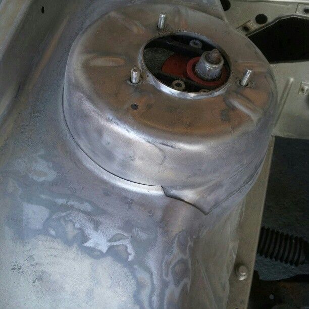

Last weekend the car was delivered to Mals custom classics body shop - following on from some of the rust repairs that i did (around the chassis rails / front windscreen and back of the sills) i found i couldnt get a match for the 30 year old faded paint. Besides I felt the car deserved a full on body resto seeing as I am doing all this mechanical work too.
car was stripped of all the interior and panels

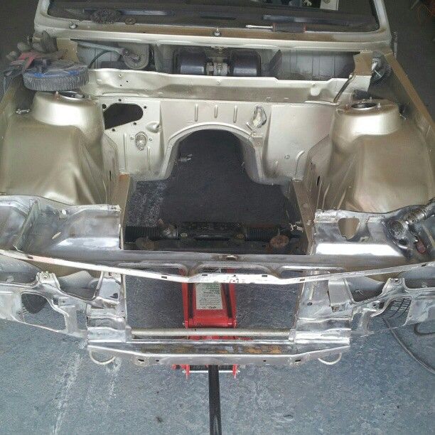

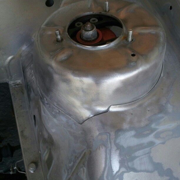

cleaning sills and bay back to bare metal

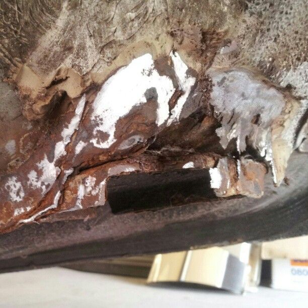

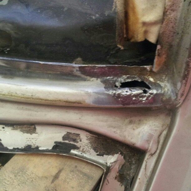

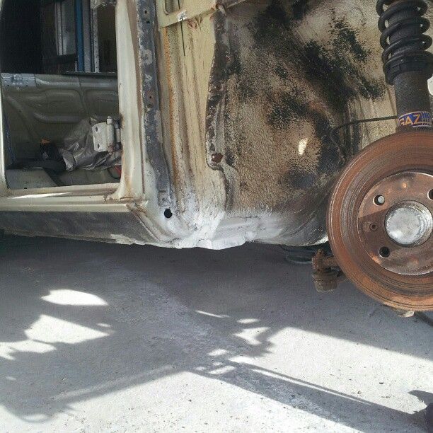

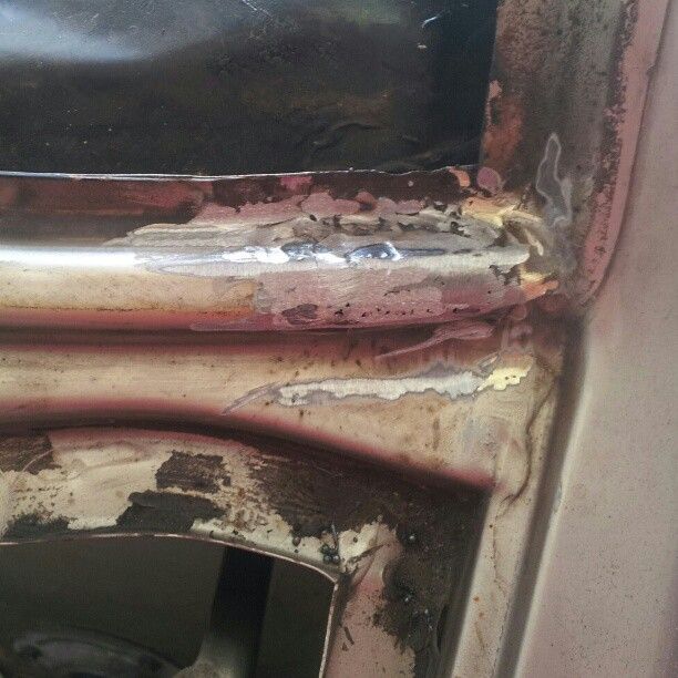

some crusty edges were found and repaired -

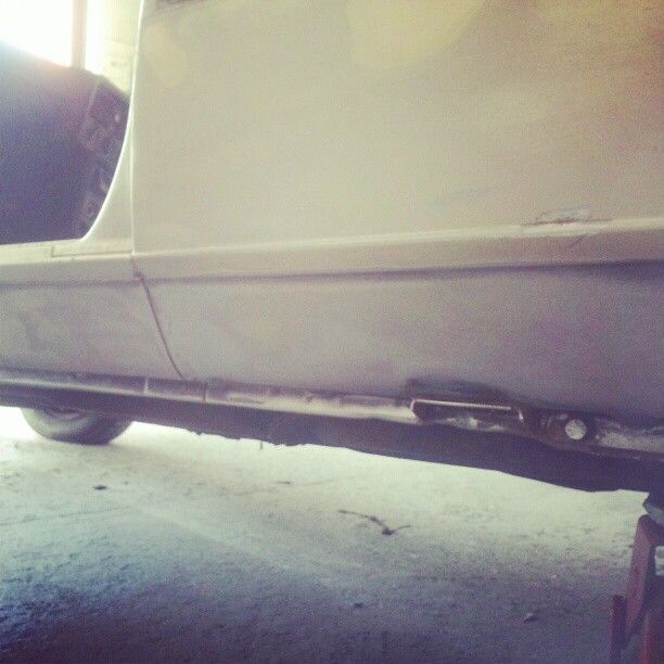

this is the bit where the sill meets the inner wing next to the drivers side floor.
and fixed!!
this is under the rear window screen - i was shocked to see a scab there as there was no signs of any rust .
Ill keep the thread updated as the work goes along.
and fixed!!
