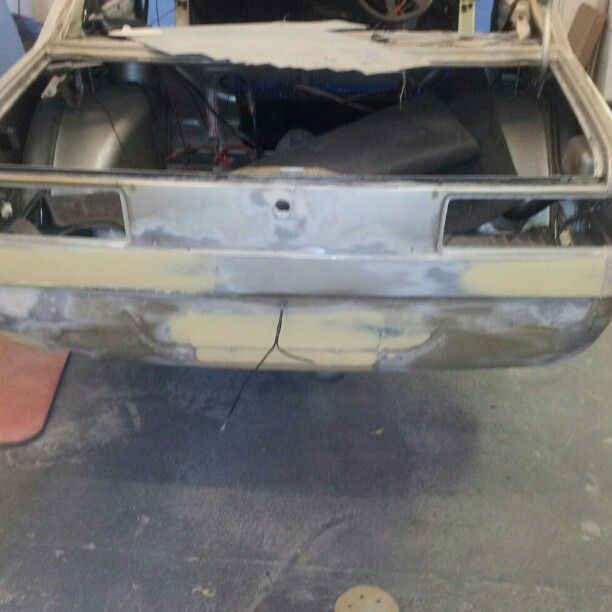

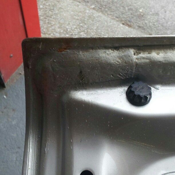

some more progress happening
Theres some minor denting from various battles with inanimate objects and some extra holes by a tow bar hitch that a previous owners did, but nothing serious.
i bought this bootlid over a year or two ago and at the time there wasnt many about - it had a fibreglass repair already on it however it was straight and never got worse, but Mal doesnt like it and is fixing it properly :-) my original bootlid when i bought the car had two massive holes from the rather crap spoiler someone bolted on it and wasnt worth salvaging.
Re: 316 beige uk
Are you deleting the rear plastic panel between the lights?
Re: 316 beige uk
e21-Mark wrote:Are you deleting the rear plastic panel between the lights?
no i will keeping that as I think an e21 looks really odd without that plastic bit. hmm.. thinking maybe I could get Mal to fill the holes in and could stick it back on with number plate double sided tape?

I normally don't like the rear plastic bit being deleted, but in your cars case it might actually suit it. But yeah, should you want it on double sided tape is a good idea. I'd be tempted to try a smoothed off perspex plastic panel instead. I think one of our eastern european members did it and it looks a lovely subtle update.

I did consider sticking the alpina / bbs / zender front spoilers and foha spoiler etc stuff on my car to make it look more "sporty" but i really like the way my car looks like a standardish 316. thats why i havent stuck the twin exit or the the twin headlights etc on either. If i changed the panel to a smooth type or got rid totally it would make the back end lose some of its original features. so i think im going to leave the styling as BMW intended.
I can change my mind later on I suppose.
