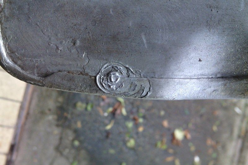

I owed 'some pics, so here they are!

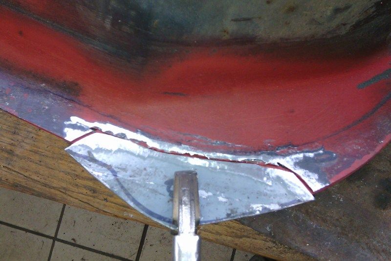

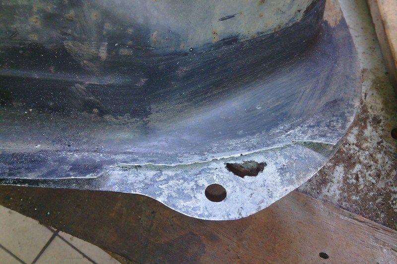

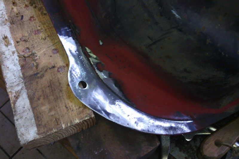

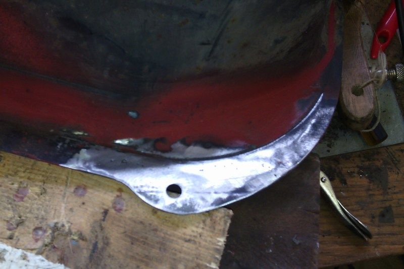

some scrapmetal fit to sie (roughly).
welded and grinded

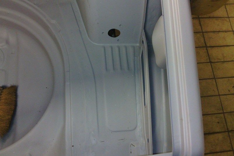

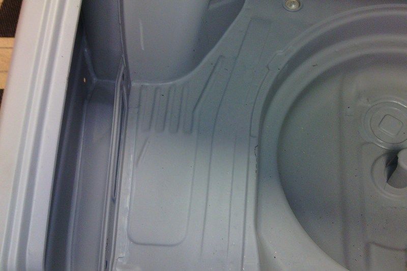

And some rustprevention, for the time being, until they go to th powdercoater.

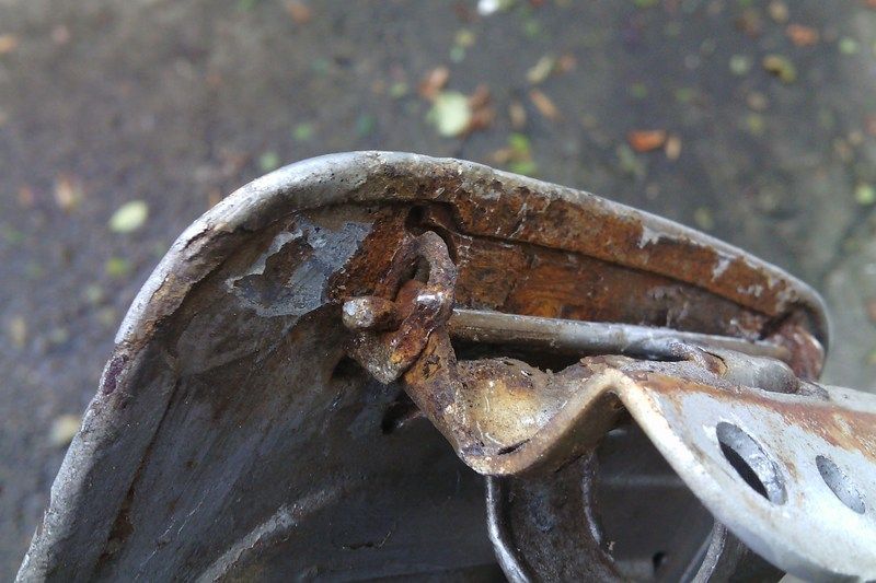

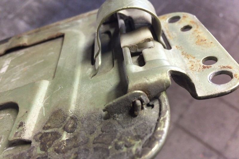

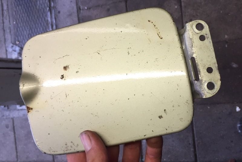

I also dug up my fuel pipe cover. It's totally shot, hinge is worn out and it all rust.
At this spot the cover hit the rubber on the car. Clearly to see that it moved over the years, due to that wornout hinge.
There is also some damage to the edge of the cover. So I scraped the paint of. Ofcourse, rust and filler... :hammer
Bu not to worry, I got me an brand new used resada one. Thanks Jan :thumbsup !

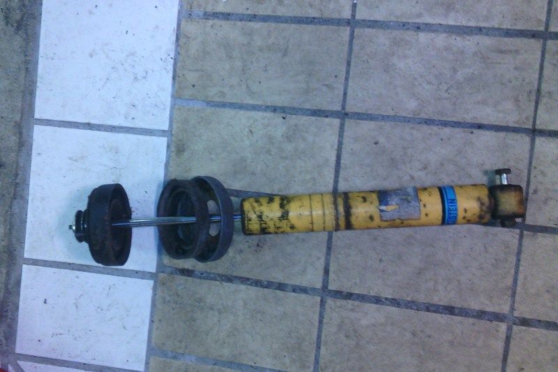

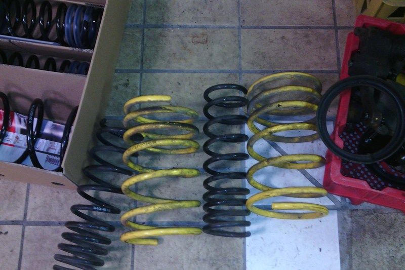

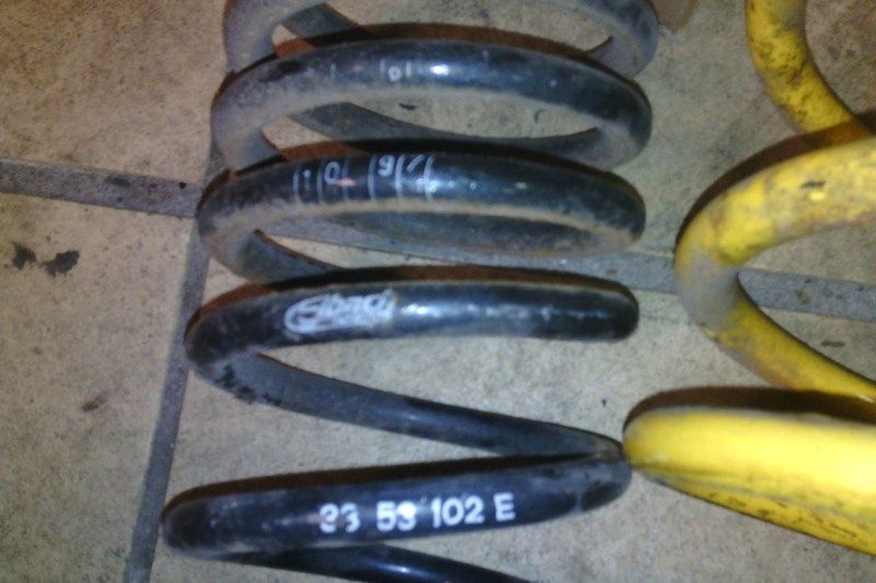

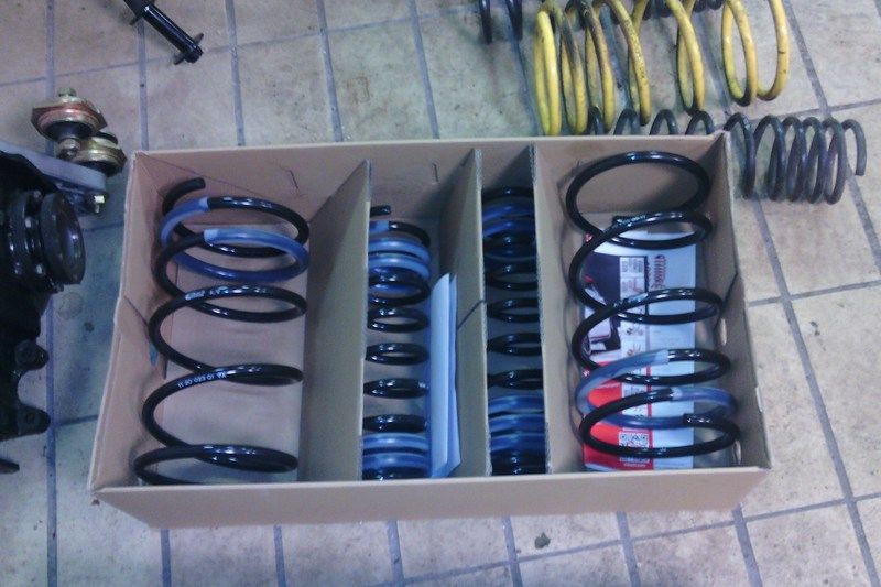

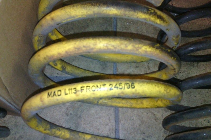

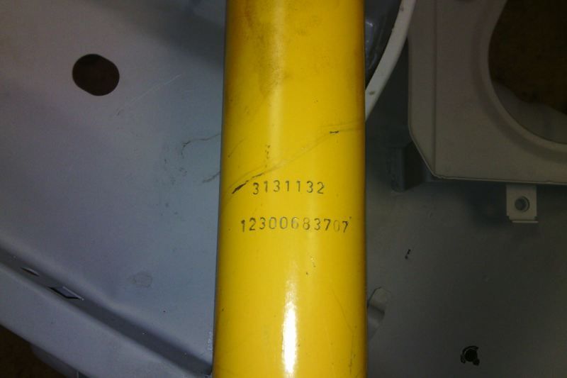

I took the coilovers apart and found out some things.
At the rear I have 18 old Eibachsprings
And Bilstein B8 (sport?) shocks
At the front I have honky tonky wappie wappie springs
And probably B8 shocks, but Bilstein NL couldn’t help me with this number to determine the type.…
Old springs:
Brand new set of Eibach springs!!

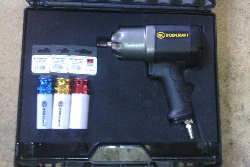

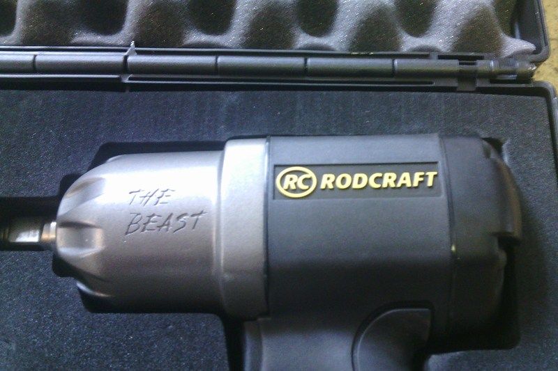

Because I had to use an airgun to release the spings, and I don’t hav one and my comprassor is not far from beeing dead, Arnold D. came to the rescue! Thanks Friend!
But I don’t want to borrow stuff, so I got me a brand new second hand compressor, 100 liter tank, capacity 425l/m.
And a new airgun, Rodcraft, heavy duty, named The Beast. goes max 1295 Nm …
Both of these things are donated by my housebank... Thanks Dad and mum!

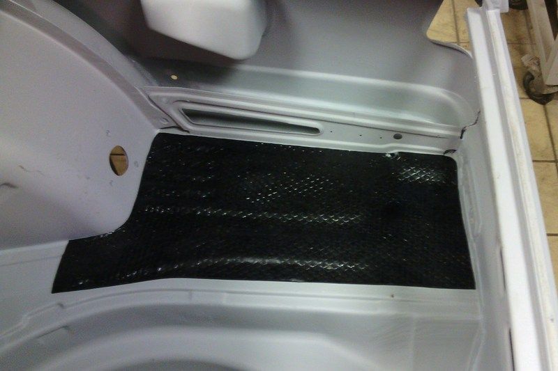

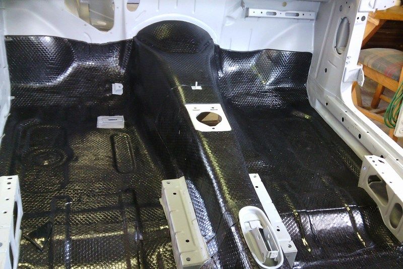

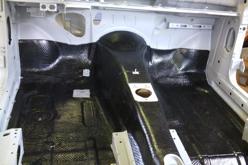

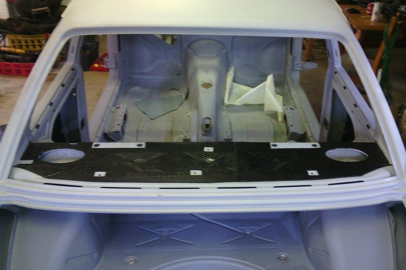

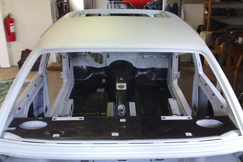

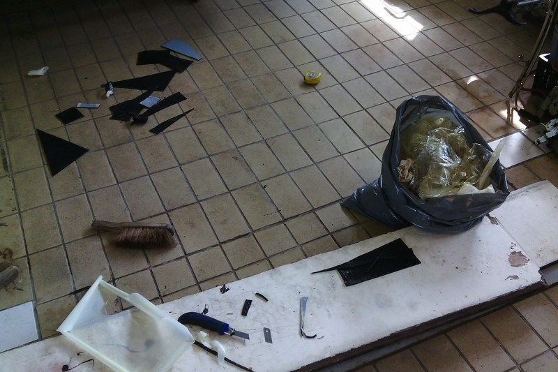

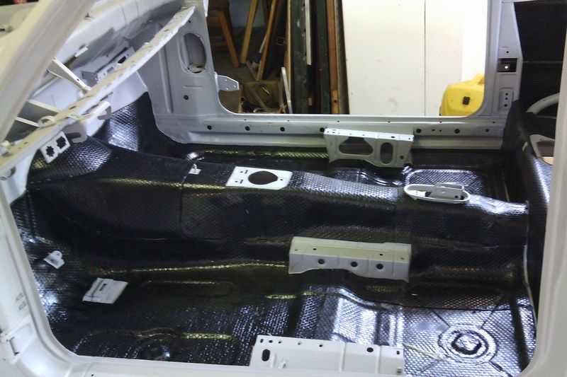

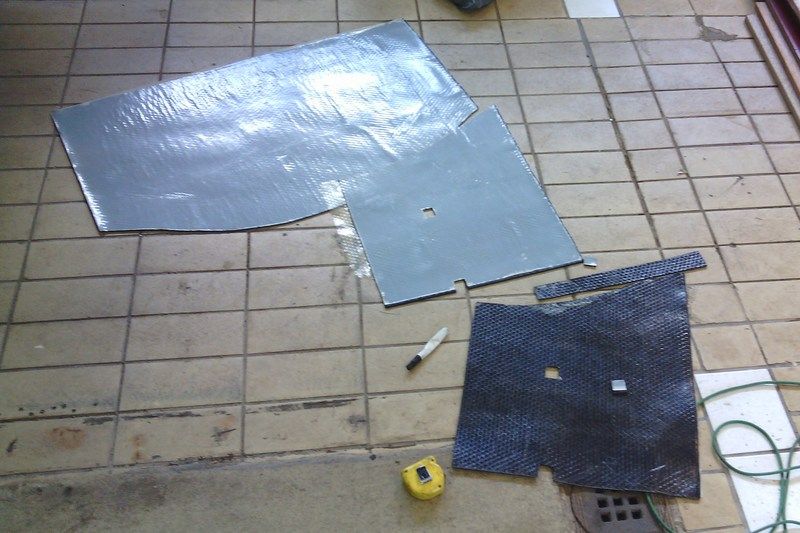

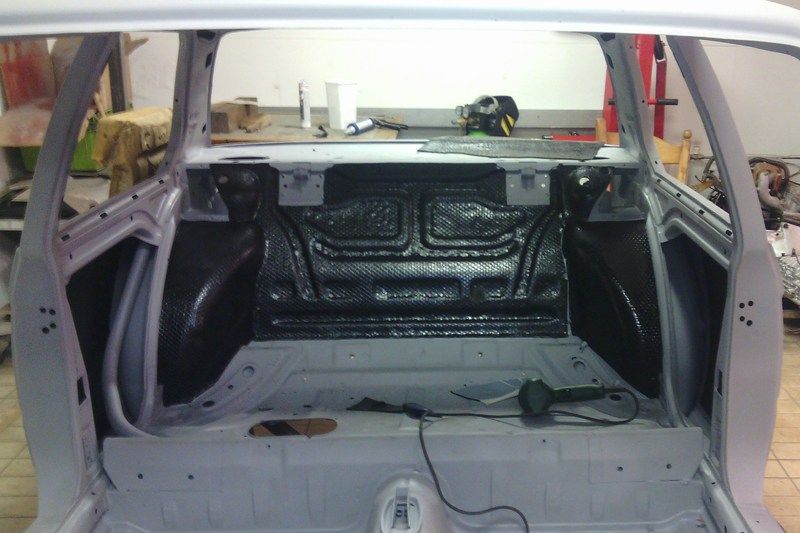

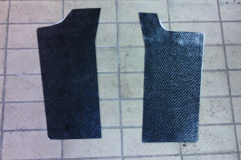

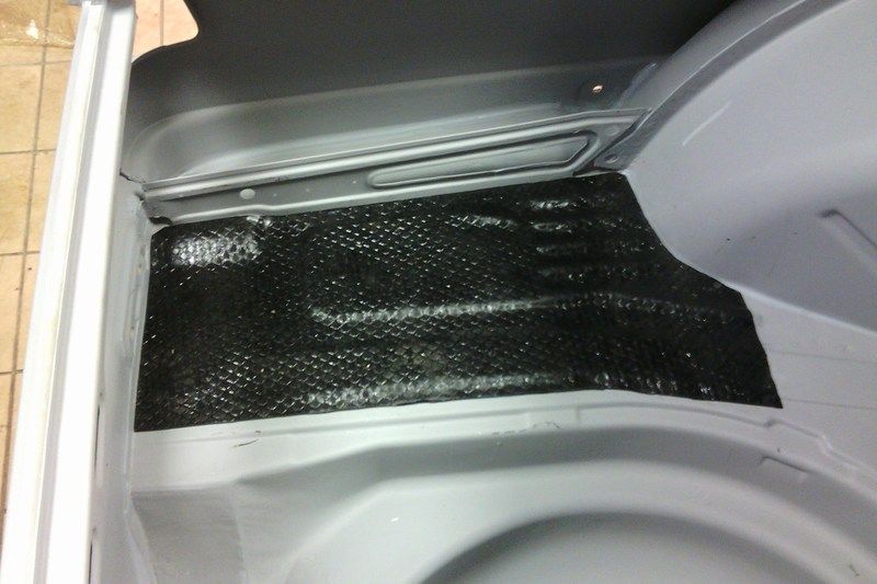

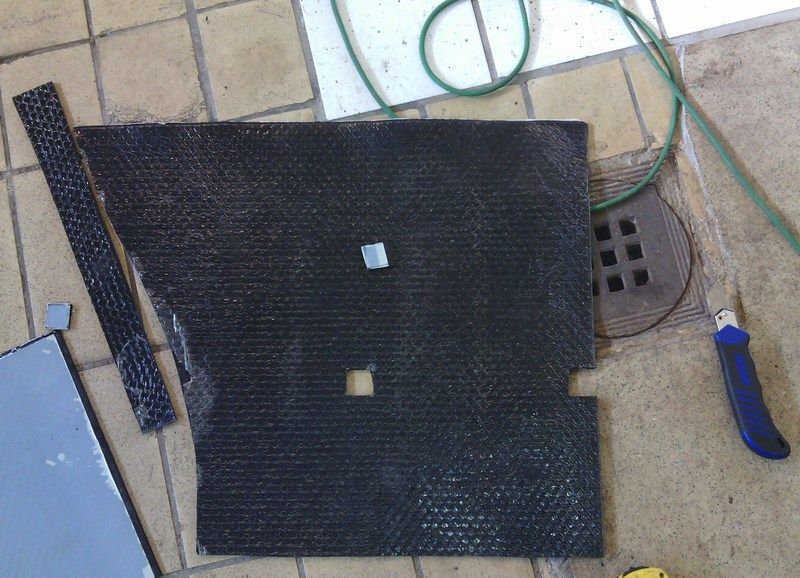

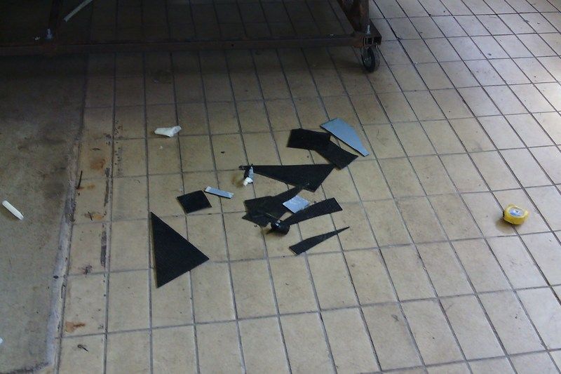

After beeing done with the sealant, it’s time to put the asphaltic panes with adhesive backing, the damping mats. I bought 7 pieces of 1m2 a piece, 4 mm thick. On the welding I wanted every thing like they did in the factory. But wit they saounddaming material, I intent to use a lot more. Gives a much more silent car with a much sturdier feel to it.
I started with cutting out the side panels
And stick away! I use a paintstripper to heaten the bodypanel, put in the mat and use the paintstripper to heat the mat aswel. Dus push and pull it in to place, and make sure it sticks on the panel everywhere.
In the boot these two will go. BMW used to put in only one above the exhaust, but on the 323i they didn’t use 2. But I do.
Done the shelf
Backseat
On the seat it selve I can almost fit a complete mat.
Done the rest.
I think the car is somewhat 40 kilo’s heavier, sice I used 5 (!!) complete mats, so I used 5 m2! Only leftover material is this.

Nice work done! After that you paint over?
BB-Carworks
BMW E21 323i S-Edition 1982
BMW E30 325i Cabrio 1991
BMW F87N M2 Competition 2018
Posts: 19182
Re: Uwbuurman: 1978 323i polaris: Sticky business!
Thanks for your very kind words, Walter! Looking forward on drinking a beer with you in september!
Bert, yes, clean it with a strong degreaser and paint it.
