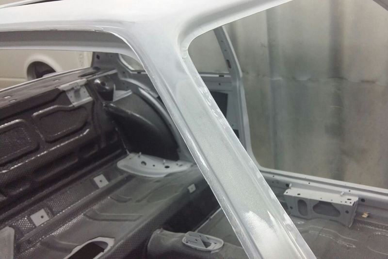

below the A pillar/front window

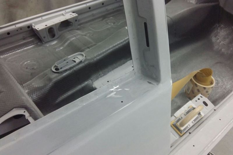

A pillar at the sill

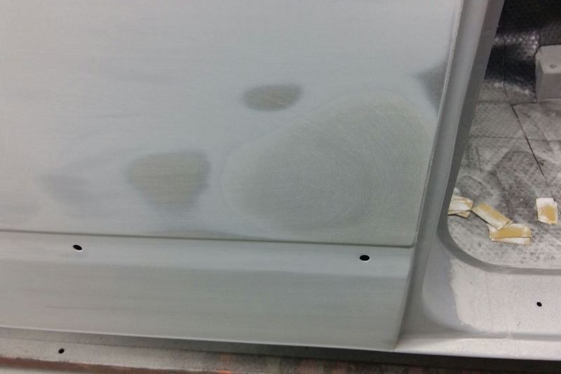

And the new sidepanel. It had a slight dent, but not anymore.
