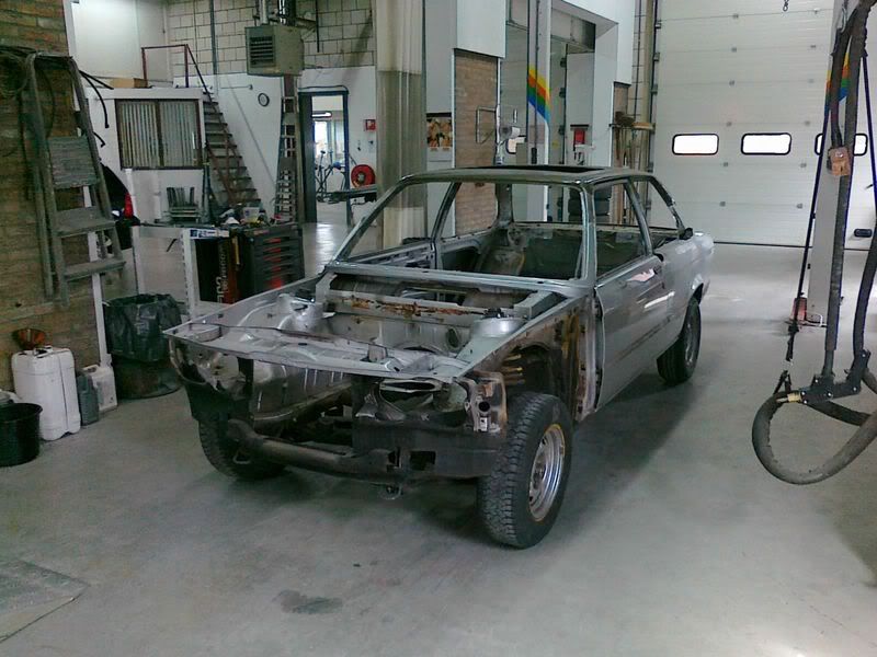

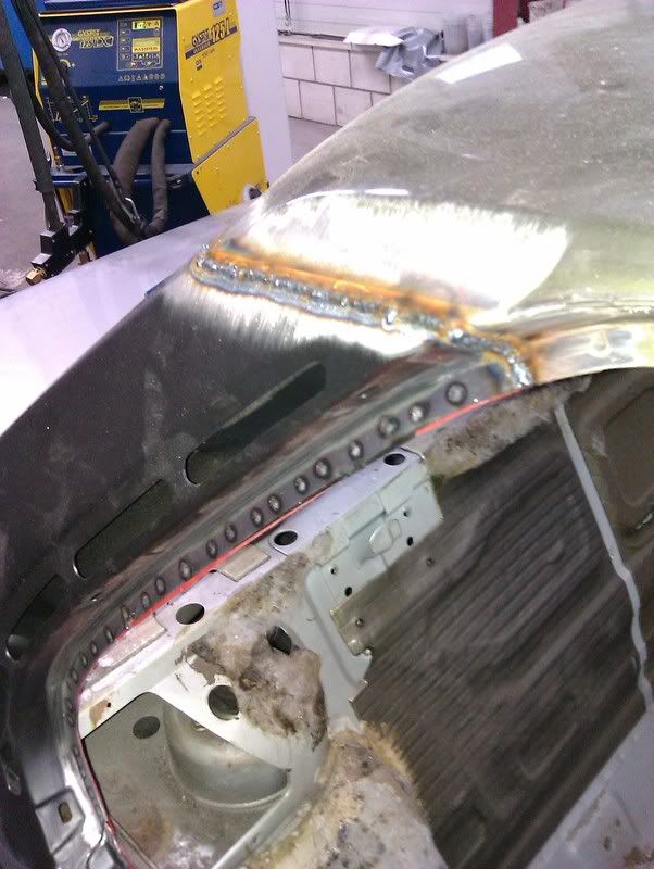

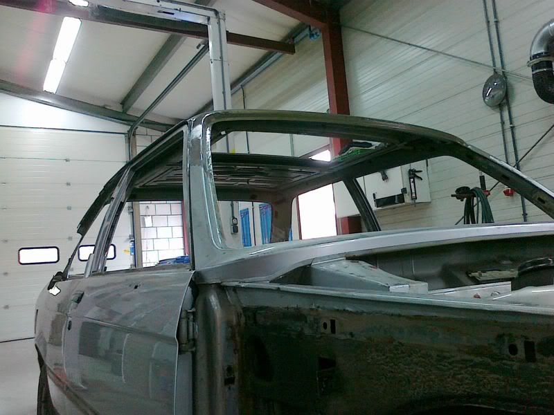

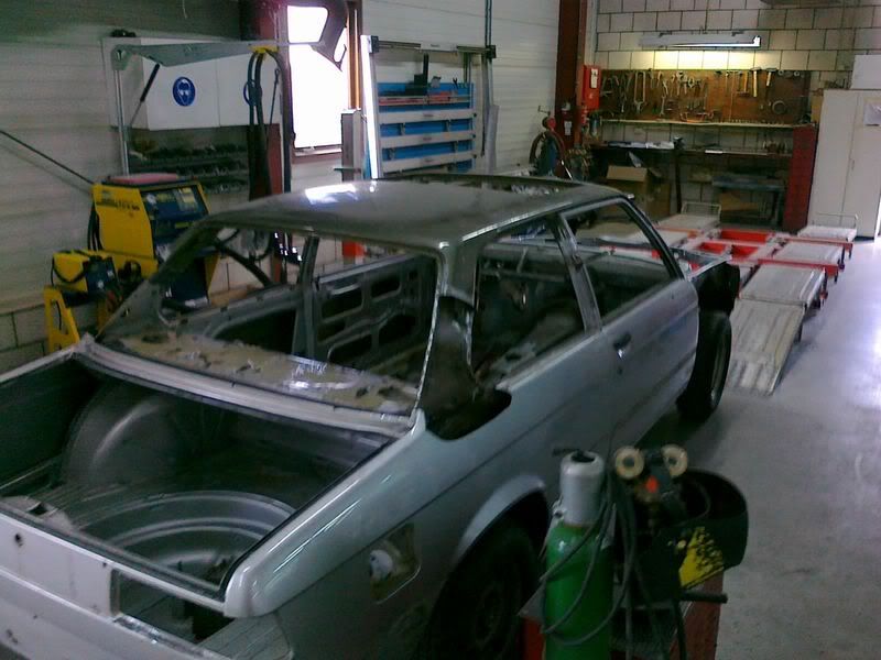

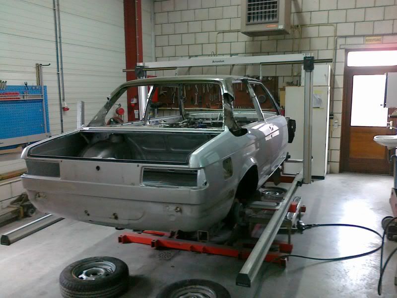

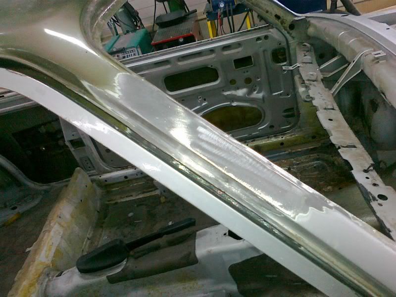

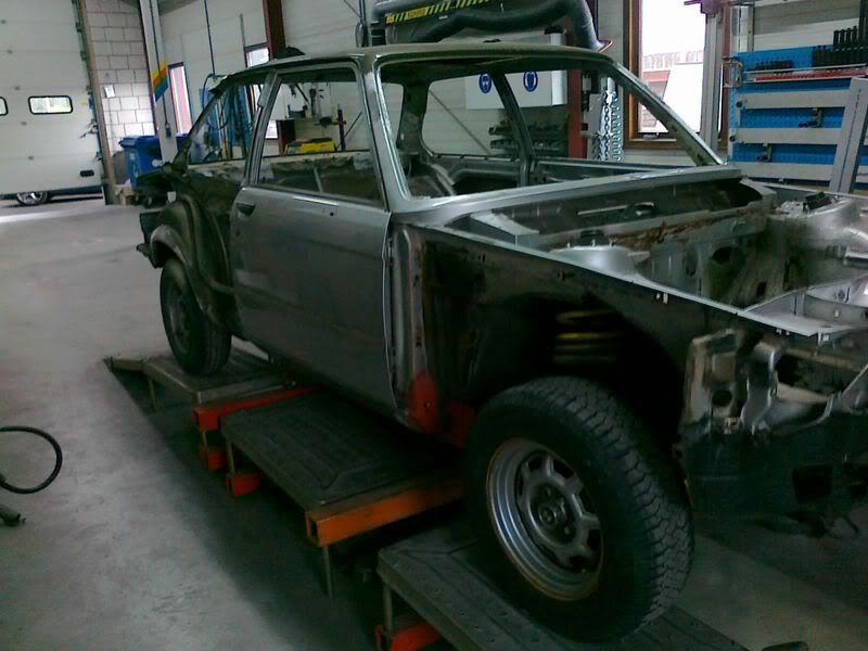

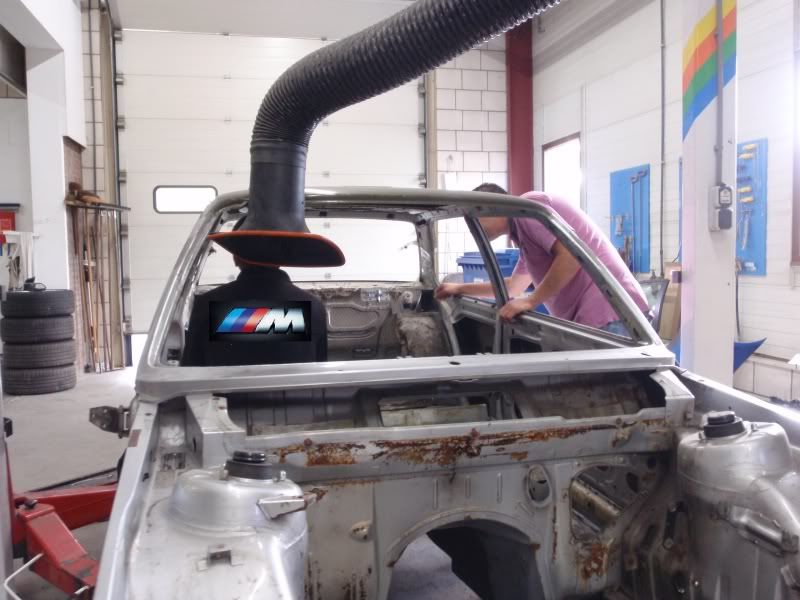

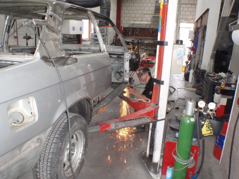

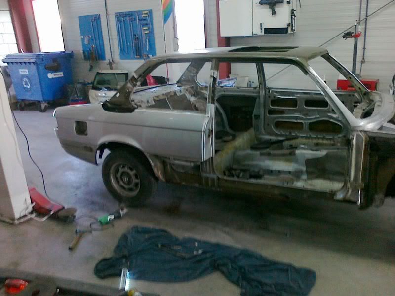

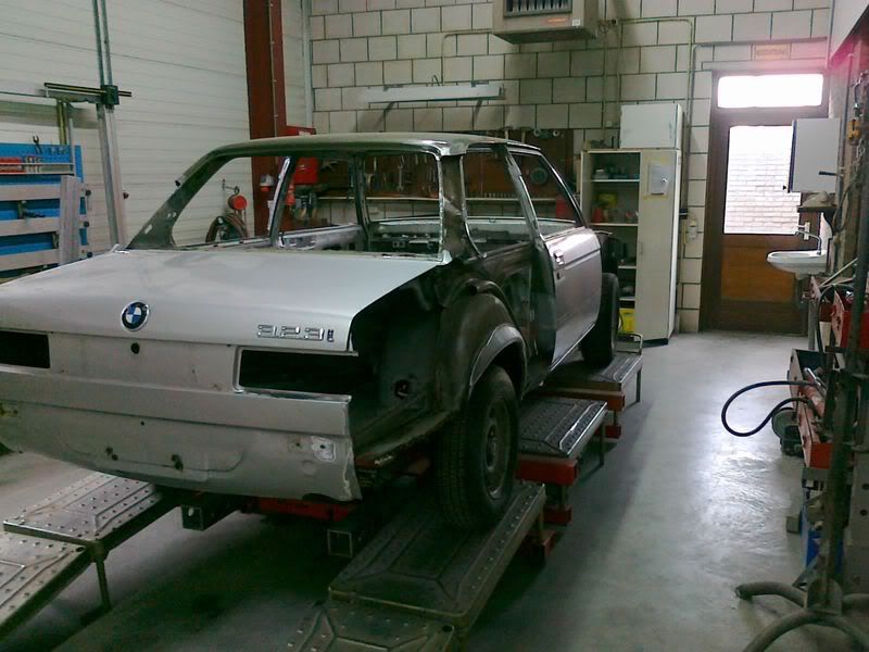

And we have a roof again!!!!
Fit it cold and just clamp it on there.
Then some stitchwelds (or whatever its called)

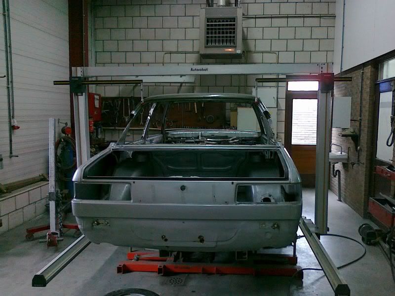

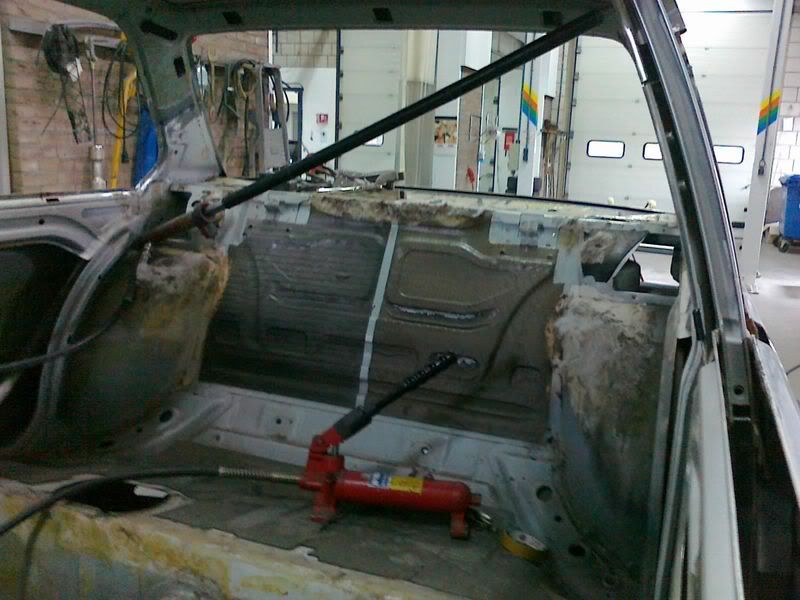

After that the car is put onto the repairbench or straightener and the measuringsystem was put under it.
After measuring it turned out to be 4 mm offcenter, so we had to press the roof 2mm aside. Now its 0mm! BMW had a tolerance of 3mm in the factory, so, job well done!
All straightend out!
Then welded it all.
And on the inside
Putting the hatch back!
All grinded down.
This roof used to have a winddeflector, but thats not coming back, so welded the holes shut.
And now, I have a sunroof!!
Down from the bench, Monday an onther car needs to bestraightened
I’m happy! Nice roof, nice work!

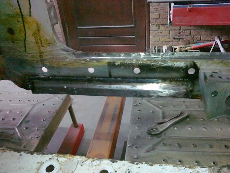

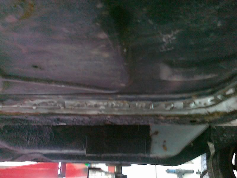

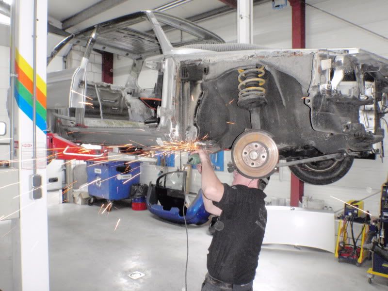

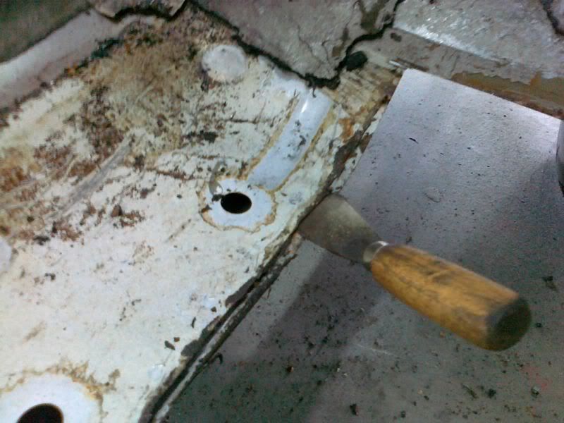

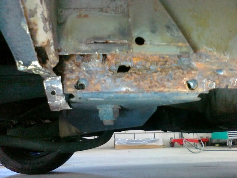

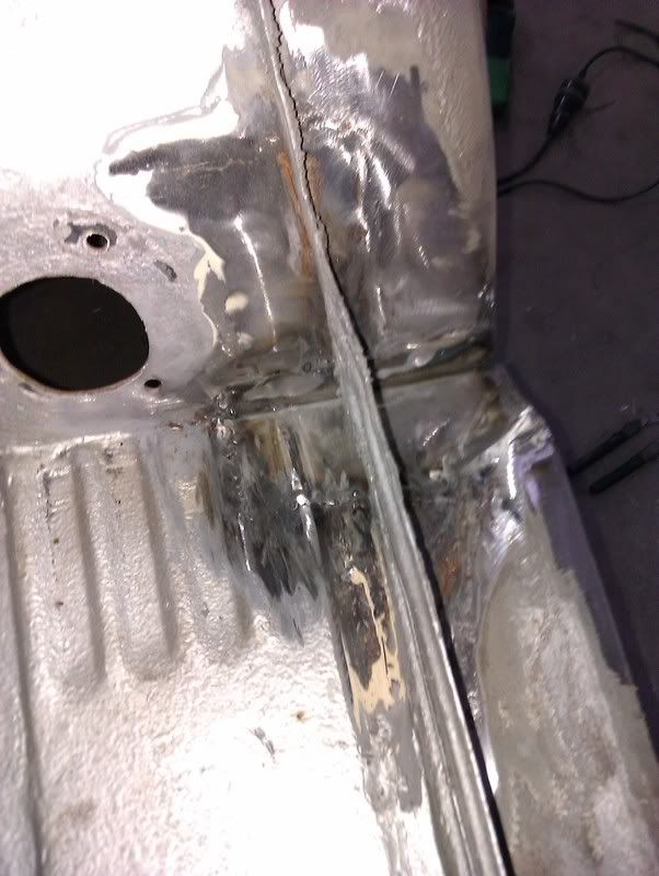

On Monday July 4th 2011 we went on with the floor. The previous restauration scared the crap out of us.
What a terrible job they did!!!!!!(sorry, had to get it out of my system.)
The floorpanels a just welded on to trhe side of the chassisbar
No rustprotection whatsoever, so rust everywhere
On the chassisbar there are no of insuffient spotwelds, not welded thru and tru, the outersill is not welded properly, look what happens when you open the door…
Floorpanel dosn’t run over the chassisbar, but is bended in to place en just a few spotwelds
Rear suspension mounts are rotten
And then this is what you get…

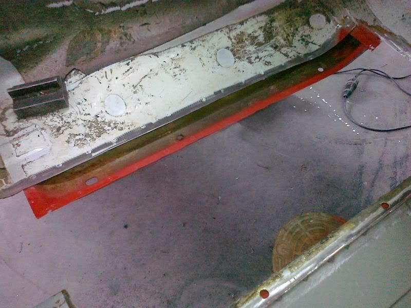

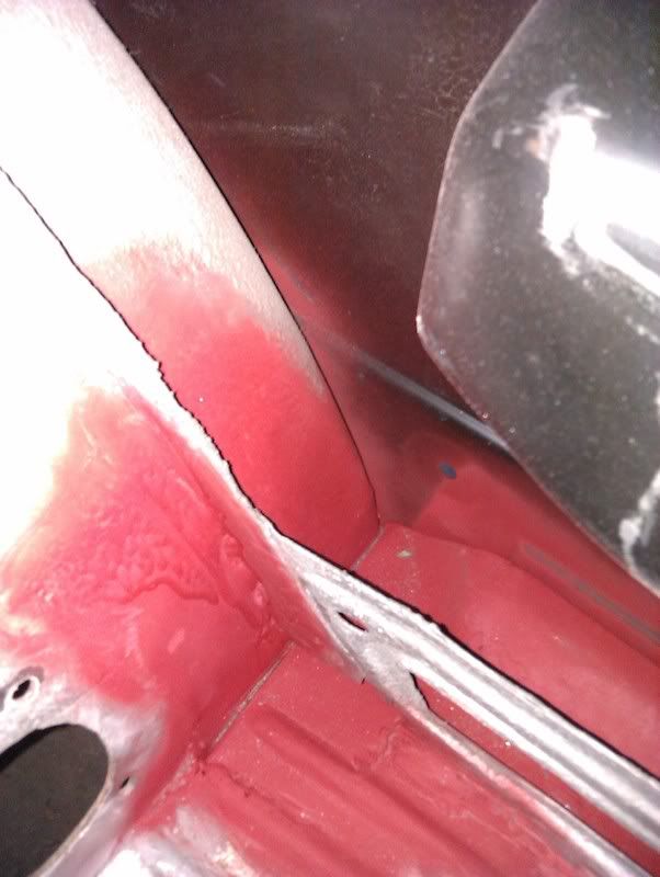

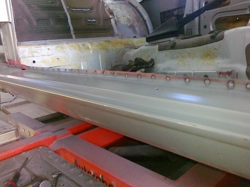

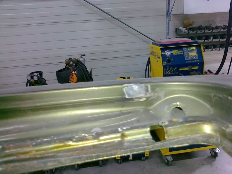

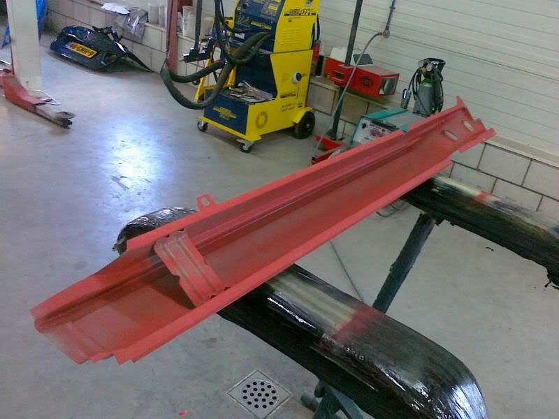

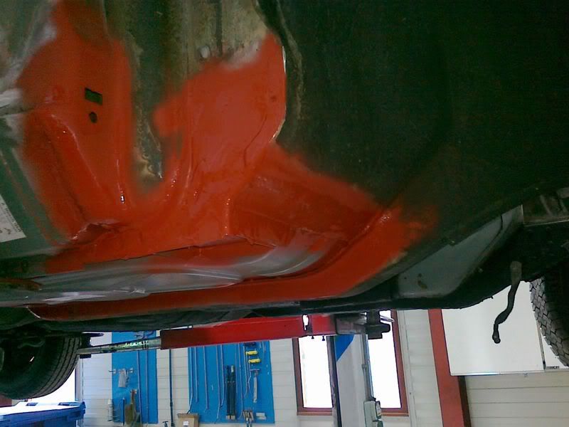

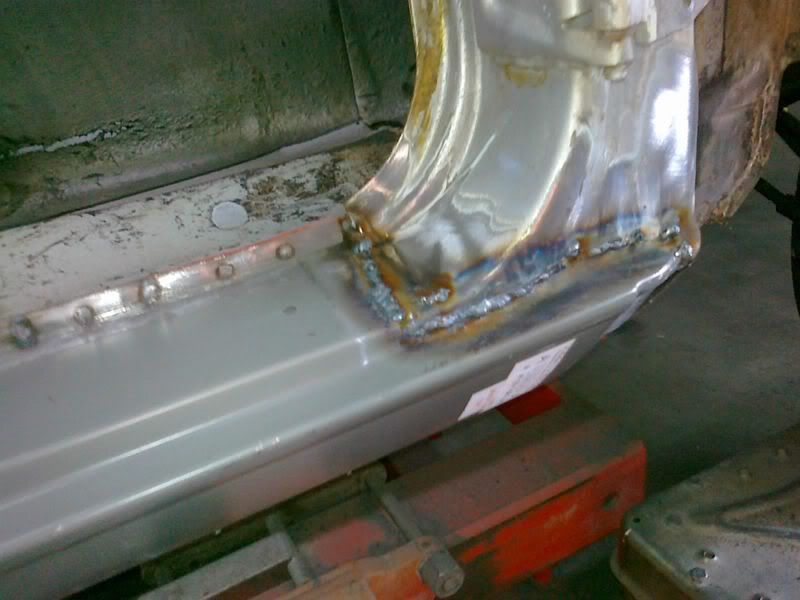

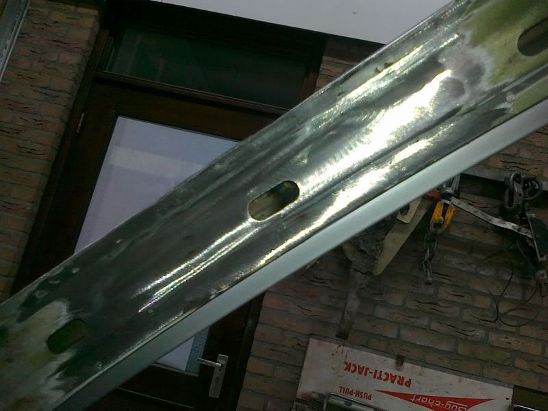

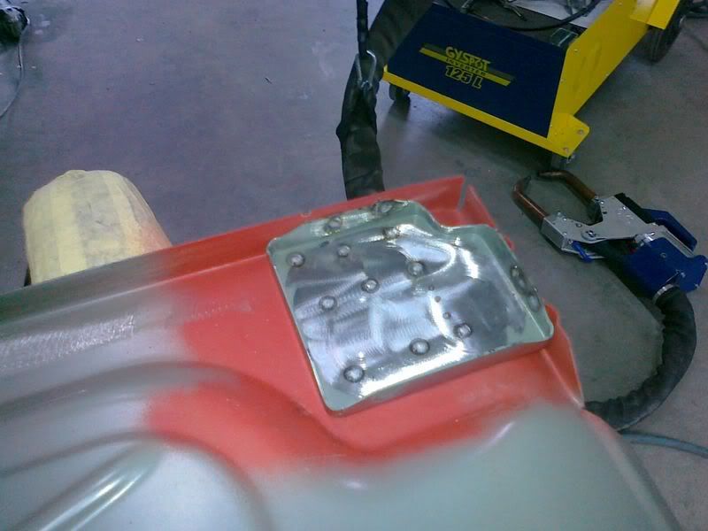

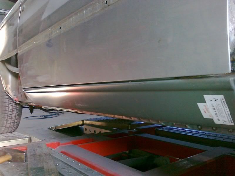

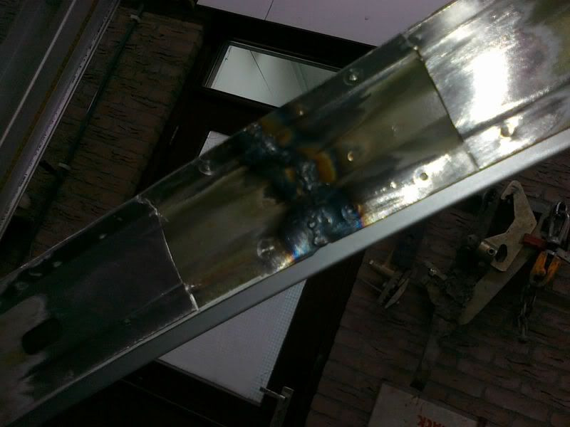

July 7th, 2011, done a lot tonight.

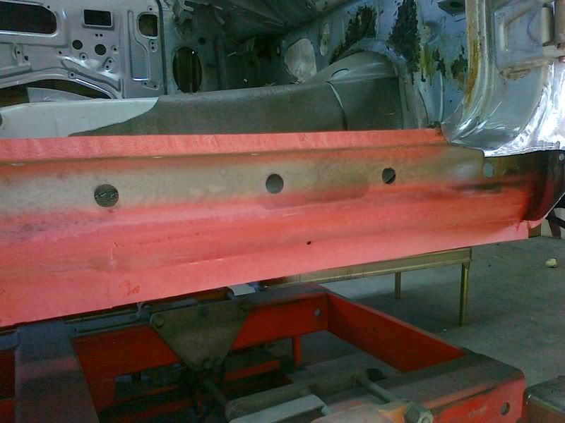

Restored the inner sill. Took out the rotten bits and put in some new metal.

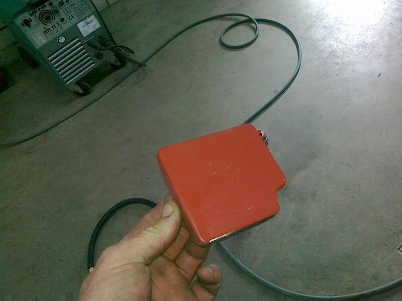

After that we prepped the edges and sprayed them with this stuff.
And attached
Upper and lower spotwelded
And some CO2 welding

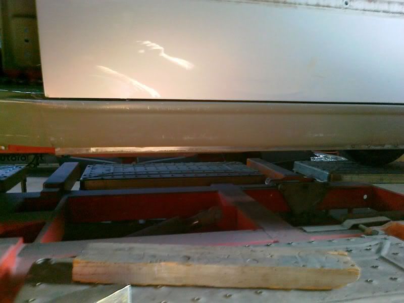

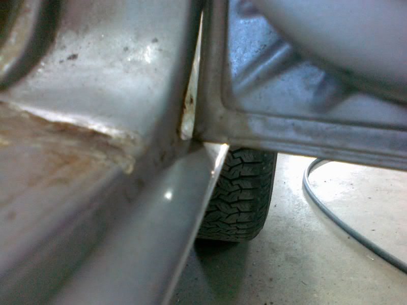

Then we put in the the door to check the gap. Nice and straight!
And attached

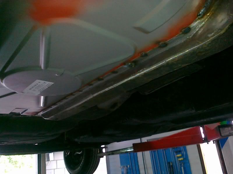

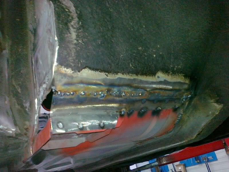

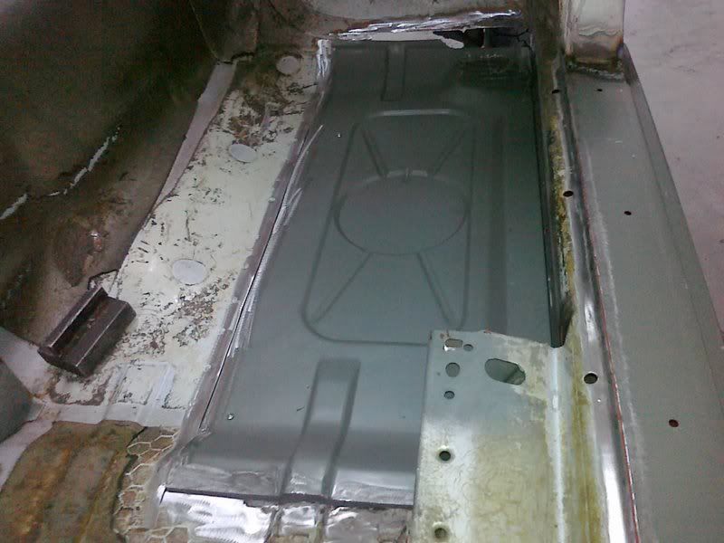

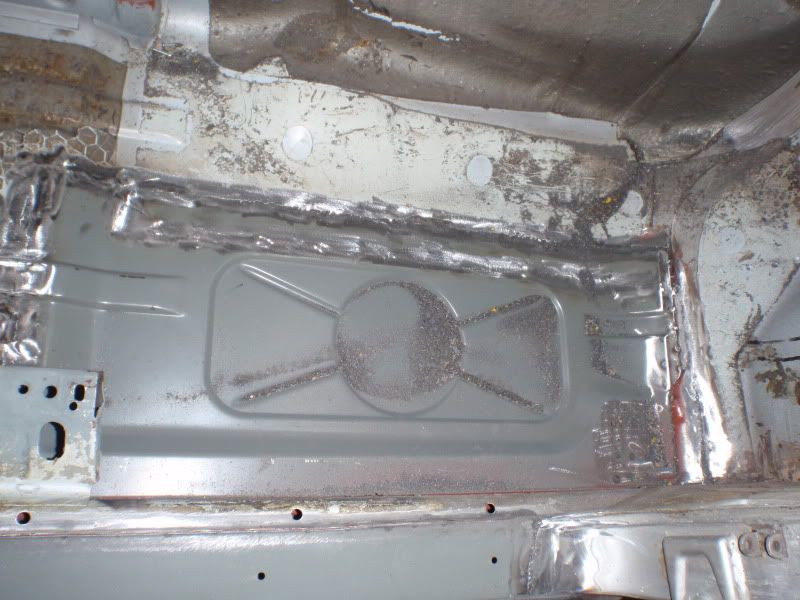

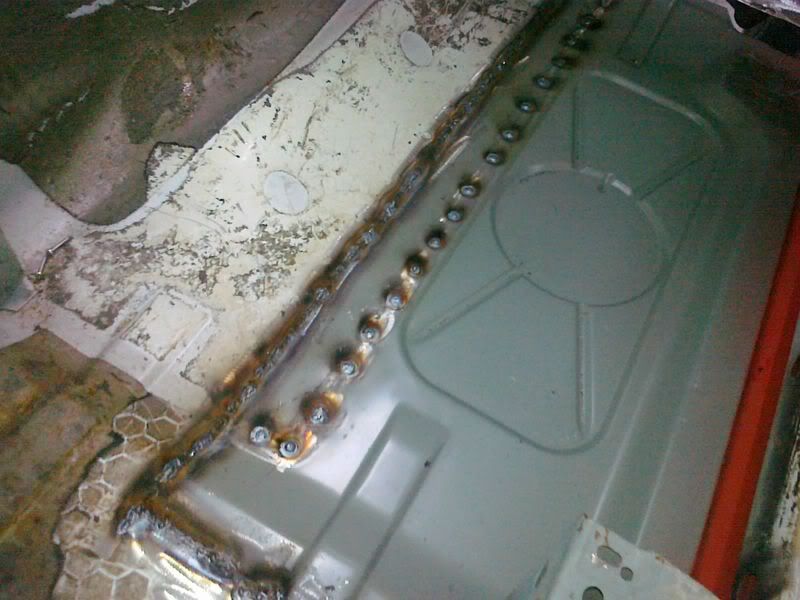

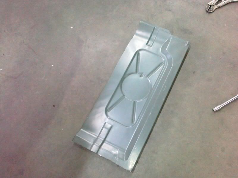

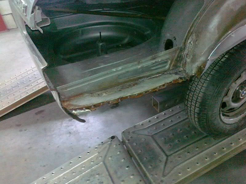

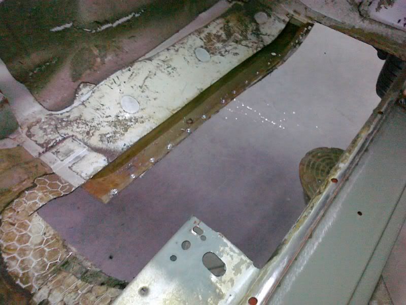

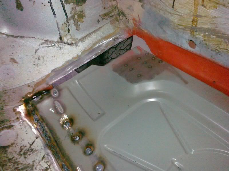

Some days later we repaired a part of the floor
At first cut it to size
Then cut out the part on the car
Clean it all to prepare it for welding
And dryfitting to measure out the chassisbar.

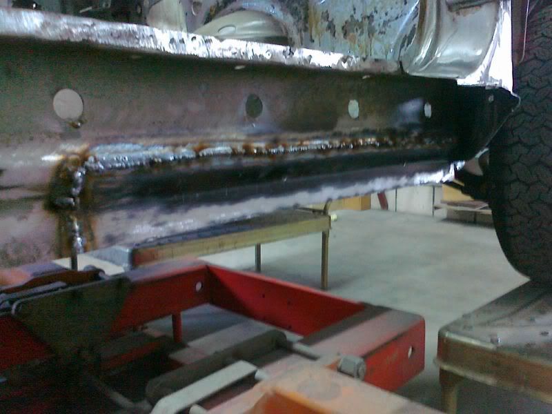

And again I sprayed it in the anti-corrosionprimer
Then we put in the supportplate

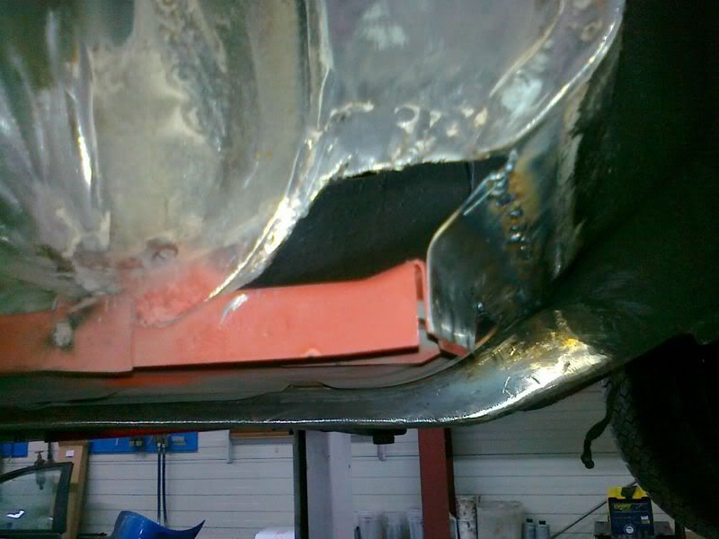

Cleaned the chassisbar and took of all the rust and undercoating and other stuff.
Welded in
Close this gat tomorrow and then this side is done.

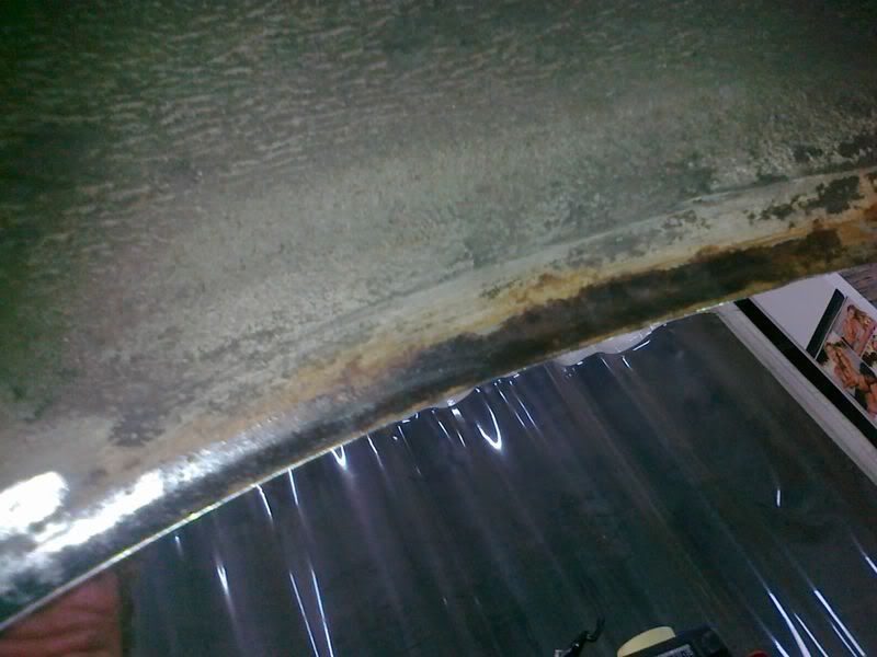

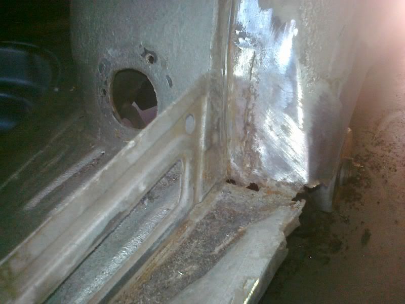

And after removal of the big pannet we discovered spots like this.
The corner of the B-pillar always rusts. Seeing this, triple plates, it doesn’t wonder me. A strange construction it is.

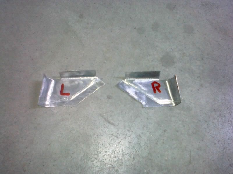

We had to make the little corners ourselves, because its NLA at BMWs

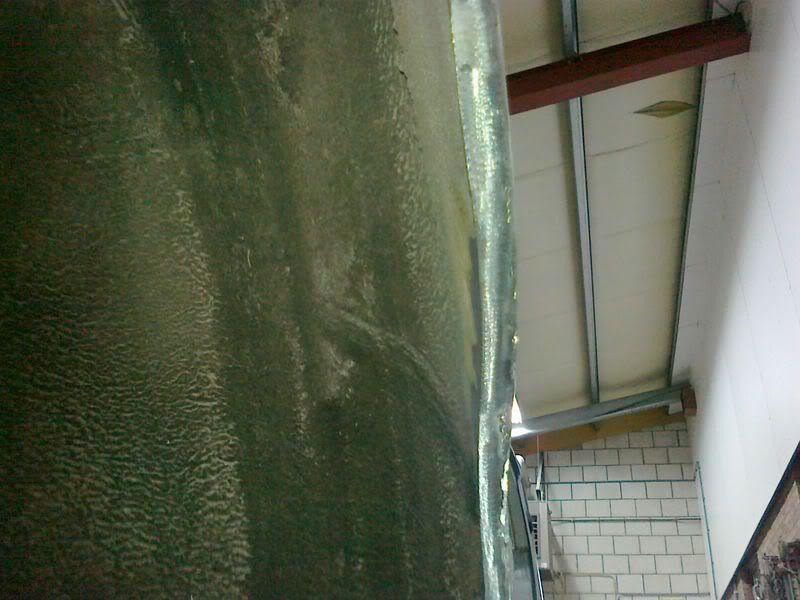

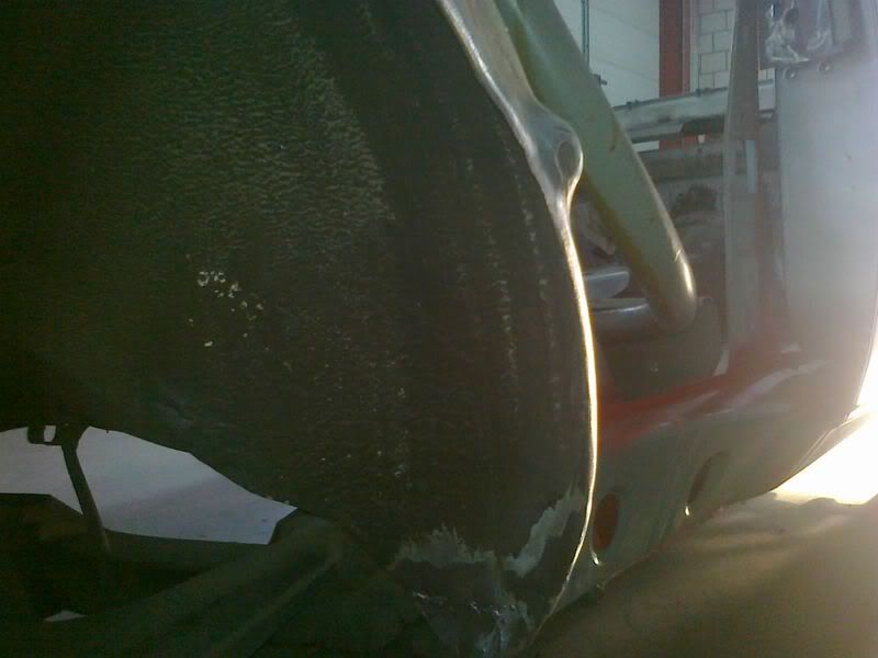

At the rear also a shitload of filler, at some spots more than 5 mm thick!!!

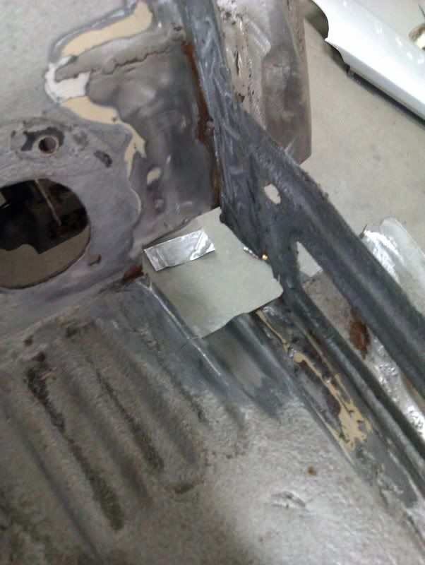

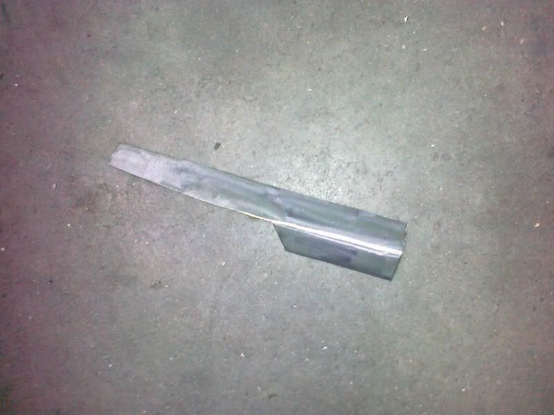

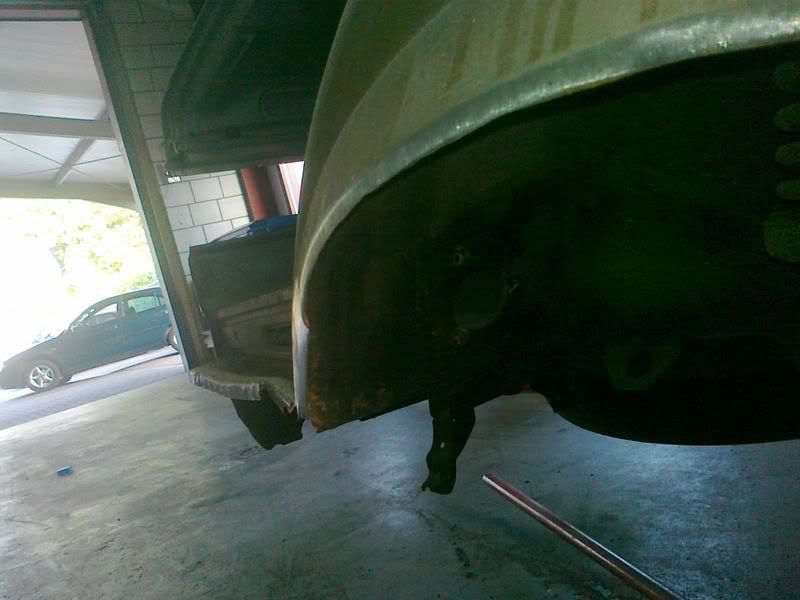

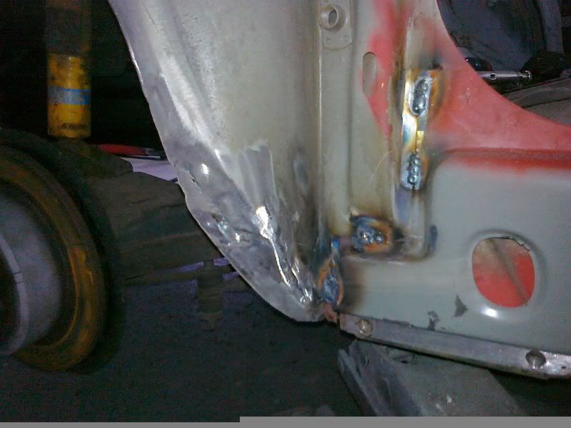

Well then… on Monday June 11th, 2011 we went on with the right sidepanel.
We took of the wheelhouse arch, but that was in so bad a shape that we needed to replace that.
Here we need a new flange (is that the right word for it? Is anyone reading this anyway?)
On the inside some rust has to be cleared out

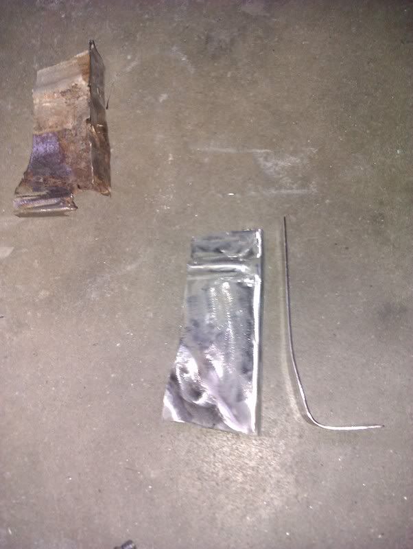

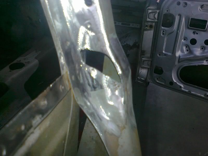

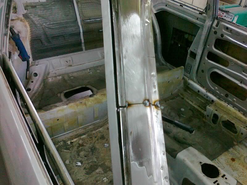

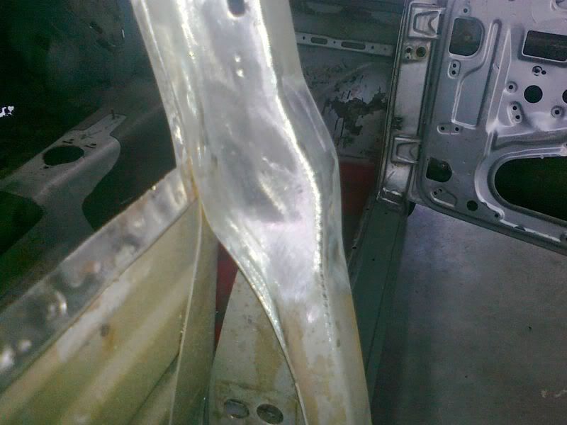

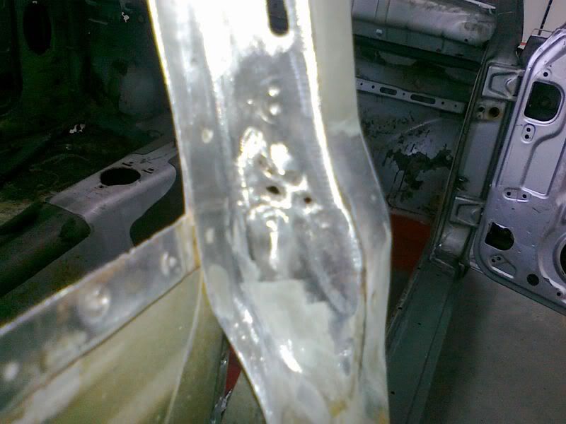

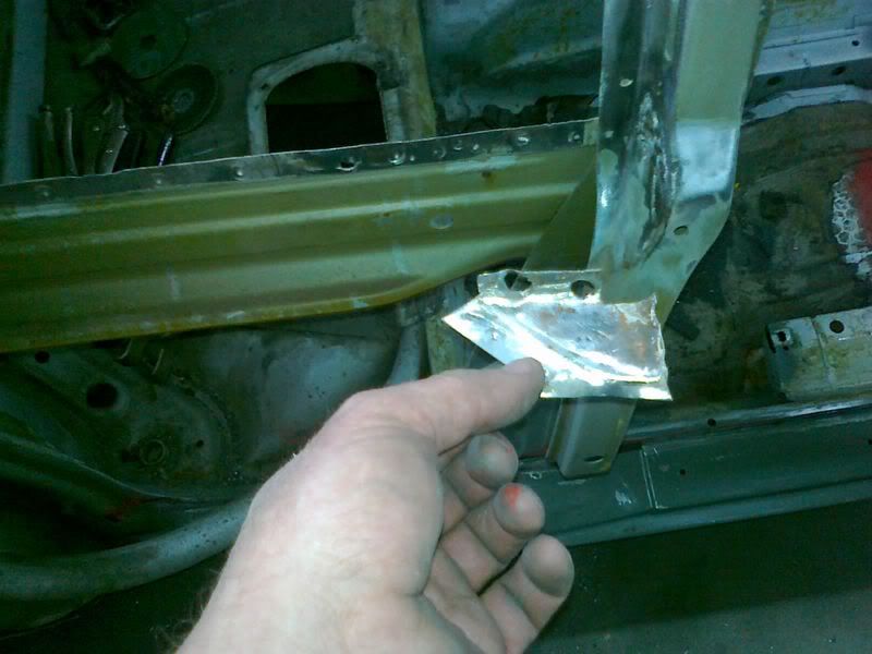

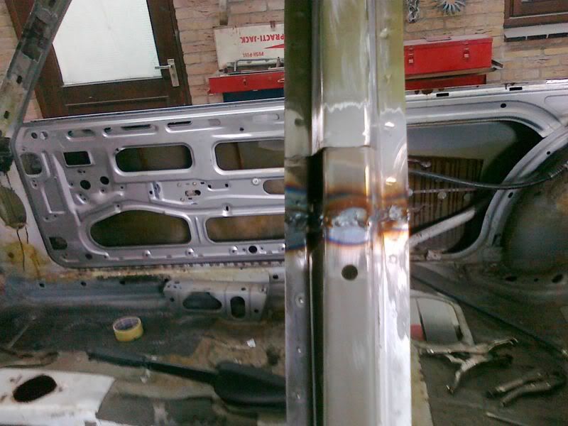

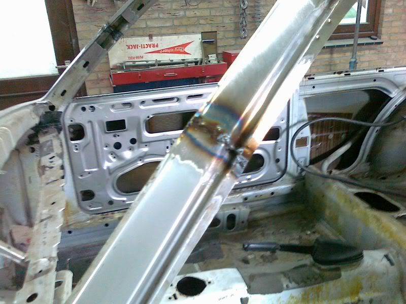

Repairing of the B pillar:
Cut out the bad parts
And put in a new piece of metal

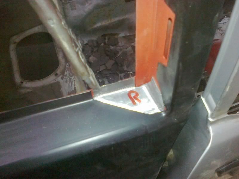

The we fitted the sidepanel, cut it to size.
made some cornerpieces for the rearsidepanels
At the rear some rust has to be cleared also.
Old joint between rear and side panel
Tomorrow we will repair some more little spots ant then the sidepanel can be fitted on.

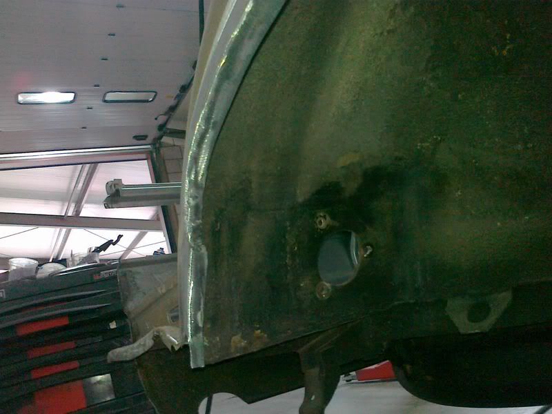

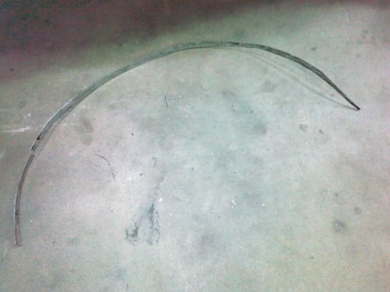

We made the wheelhouse arch flange thing…
And welded it inn
Repaired the frontside of the wheelhouse
Tomorrow we’ll place the rear side panel.
And welded it inn

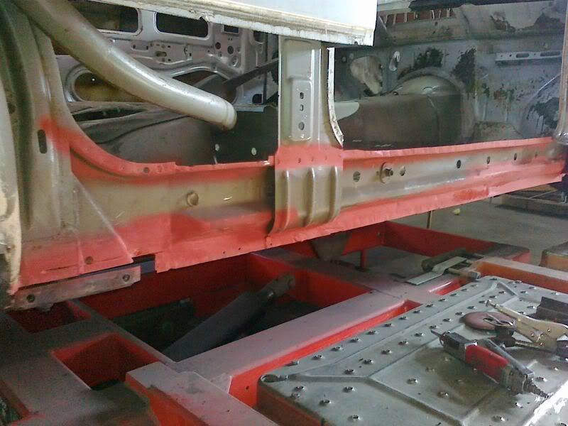

- Posts: 19234

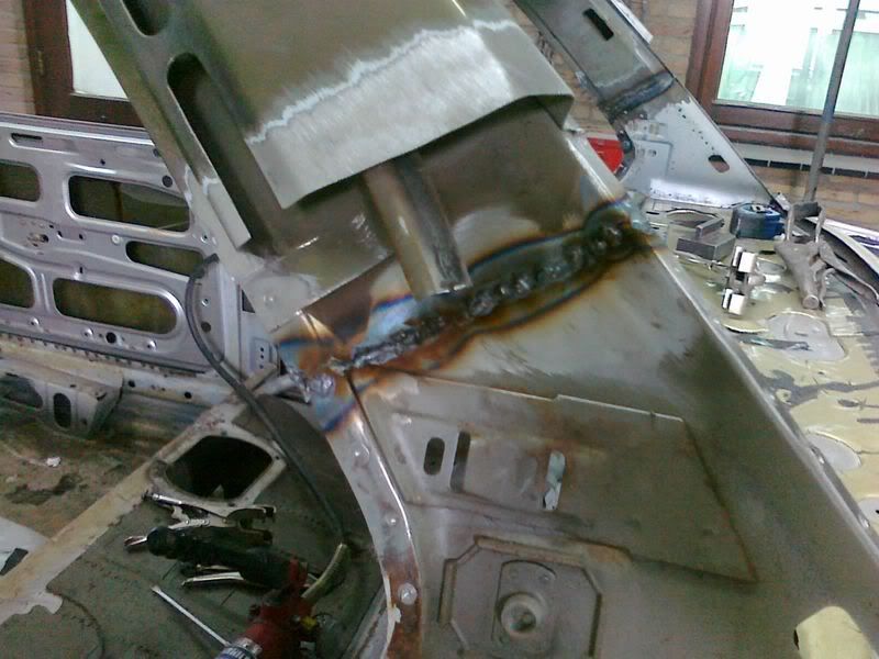

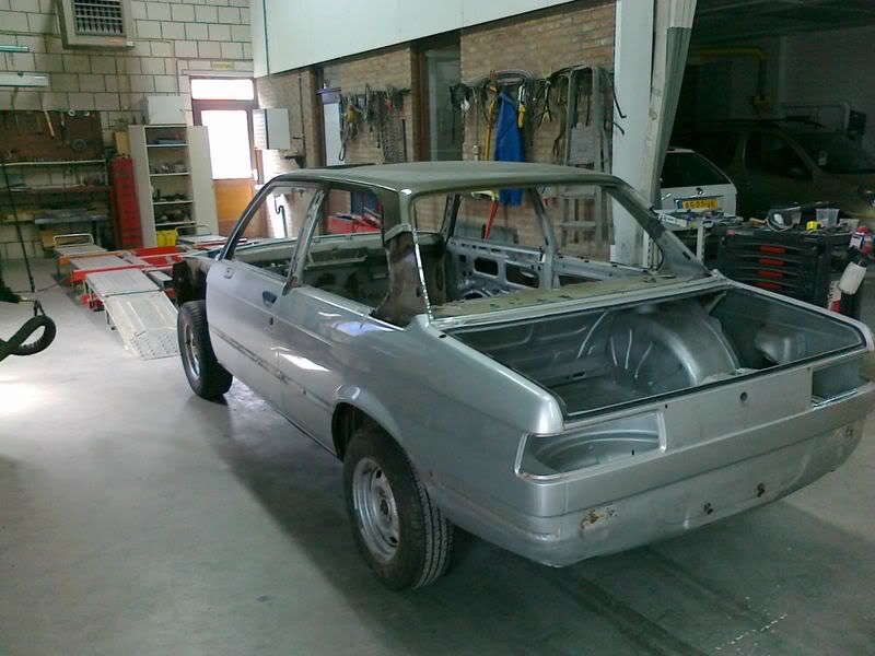

Re: Uwbuurman: 1978 323i polaris

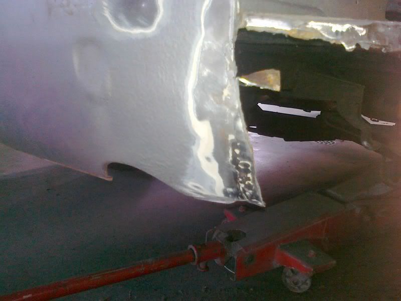

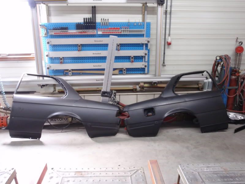

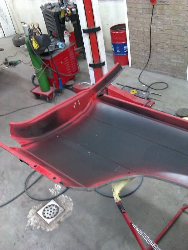

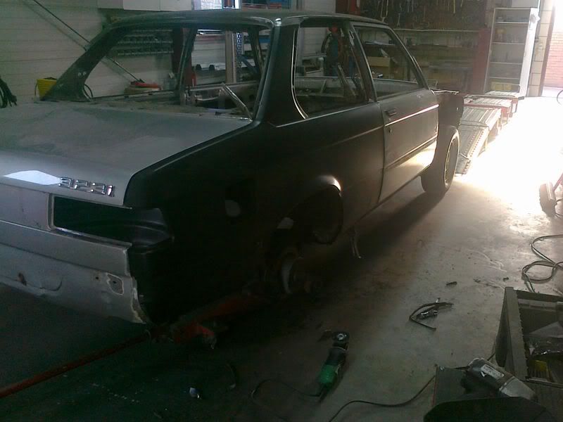

And the right side panel fits!!

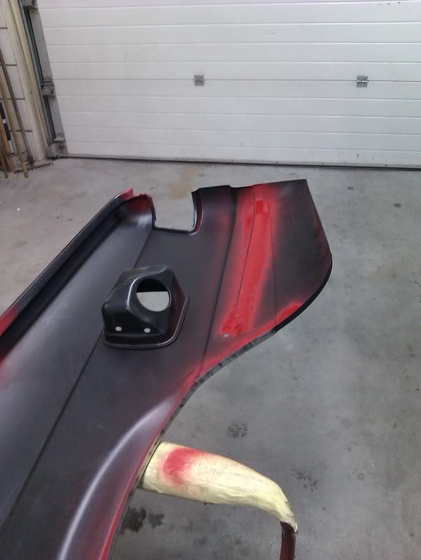

But before welding it on, we repaired the bootfloor/rear wheelhouse
nice work!
It goes in here
And in

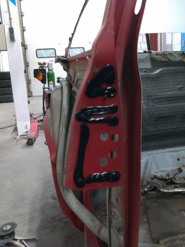

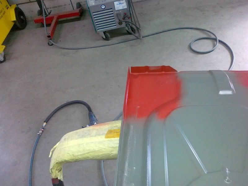

Then prepped the new panel

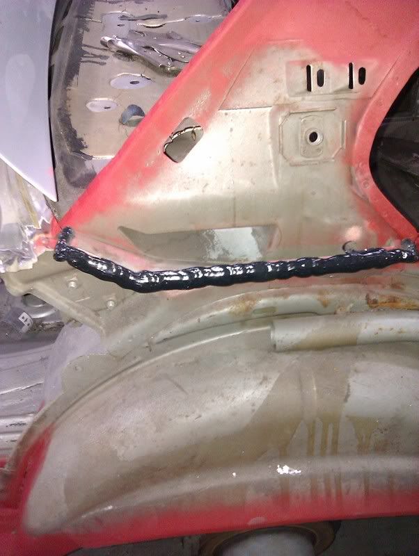

To have and watertight joint it needs to be glued already, lateron you can’t reach it anymore
The used to spotweld this about 10 times, but with the proper glue it needs only 4
And it’s on!

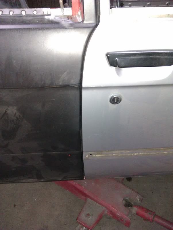

Gap between the door and the sidepanel
Wled to the roof and the spotwelds
And the fit to the booth floor
