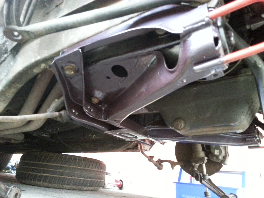

subframe replaced
Today i've replaced the subframe for the modified one, modifications are mounting brackets for the sump guard and relocated wishbone attachment.
Because the engine is laying on the subframe it is nessesary the engine is lifted a little so the engine mounts come free from the subframe. normaly this is done with a engine hoist which i don't have.
I've done the job with a pair of heavy strap winches.
Winthin 2 hours the old subframe was out and the new one back in. it took me anotner 2 hours to attach al the axle support parts and realign the steering rods.
All in all i'm very hapy with the result, the front trackwidth has gained 16mm at each side (at the ground) and the camber is now 1,5 degrees negative, just a little less as the rear wheels.
engine hanging in the straps:
both subframes:
after 2 hours the 'new' subframe was in:
and the sump guard mounted to the subframe (bad photo):

Re: Pastelblau 520/6
Nice work Rob! And a nice fresh subframe!
I'm curious how it drives now.
- Posts: 3138
Can't road test it till 1 march 2016 because Frans Weekers changed the laws a few years agobmw e12 e21 wrote:Nice work Rob! And a nice fresh subframe!![]()
But i think i won't notice the difference in the camber before and now. I'm not a competetive driver. Ofcourse the new shocks, wishbone, rubber and springs i've mounted last summer made a huge improvement i did notice !!
Just knowing the changement would make handling better is enough for me, but mainly the looks how the front wheels were standing before and now makes me happy with it. That little neg camber looks so much better on the car.
