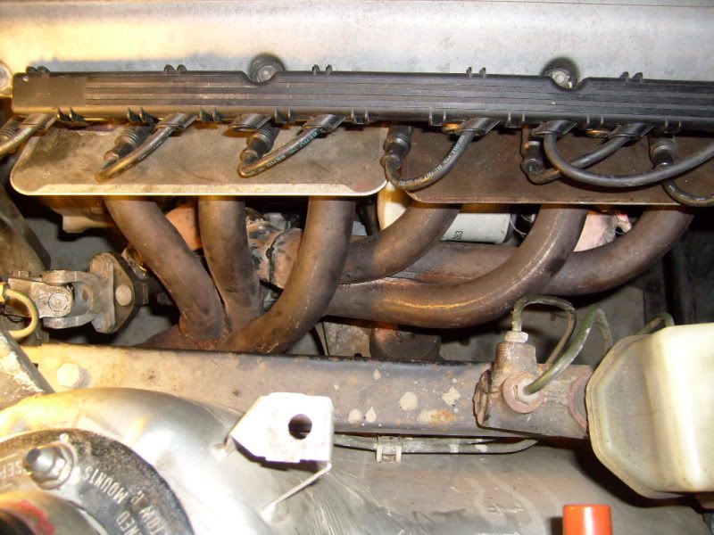

Progress report!
I had another coupe of hours in the shed today and i managed to tack THREE sections of pipe together into some useable form.
I had tacked on the old collector too but when i completed the test fit it ended up being hard up against the floor of the car suggesting some discerpency between my test bench and the actual car.
I also spent some time trying to find a chassis punch to put a neat hole in my firewall, i ended up buying the set as the individual screw type one was half the cost of a set they had in stock and it still had to be shipped up from Sydney.
That set represents the final piece in the puzzle, giving me a way to make that big hole in the firewall without butchering it.
Still plenty to do yet, I've got tomorrow off so I will cross my fingers for a 5-6 hour stint.

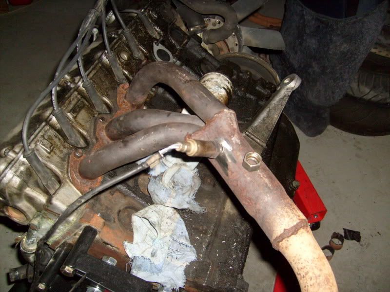

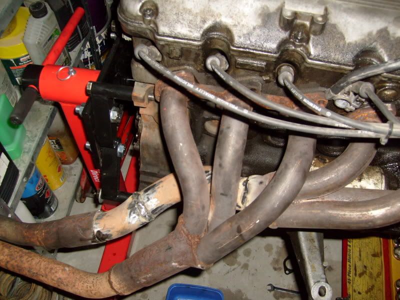

A small amount of progress....the 5 hours i hoped for didn't come about.
I got the 2 that i usually manage to squeeze in.
I started the afternoon by trying and failing to match up the collectors on my old engine and then move the front collector from the engine in one corner of my shed to where my welder is at the opposite end of the shed at the limit of my only 15amp extension cord.
It didn't work out and i spat the dummy and used the hoist to move my engine and stand to the welder so i could get all the angles right and weld while the headers were mounted on the engine.
And it worked out!
Pipes come out in approx the same place and aren't touching anything.
The last thing i did was to remove, drill and grind the rear headers in readiness to weld my O2 flange (oil pipe nut) onto the collector.
I will only bolt up the headers till i get the car running as i think i will have some exhaust leaks to sort out before i finish off the exhaust.

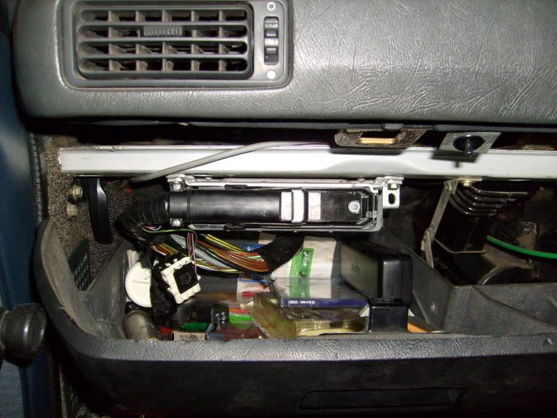

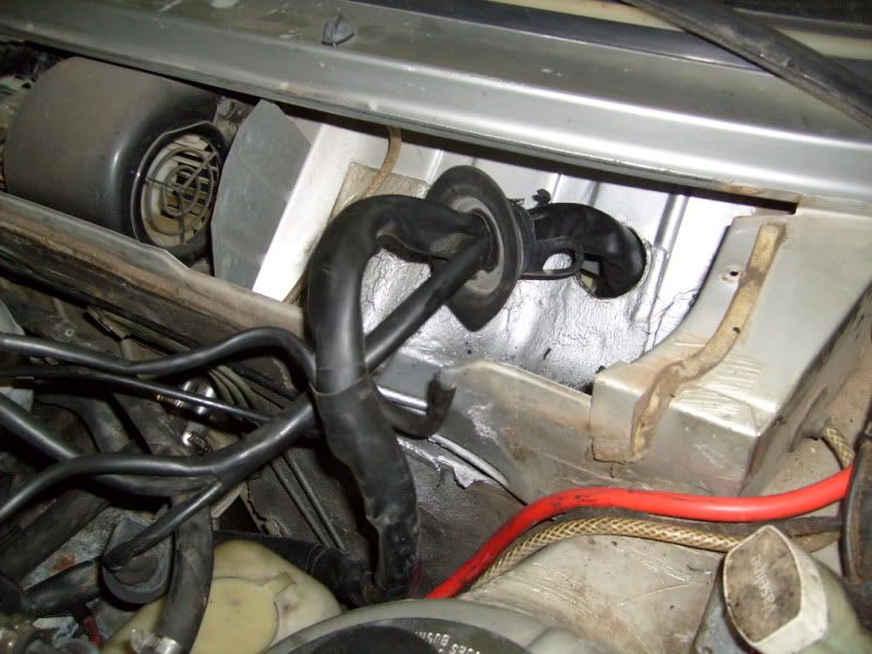

ECU is in! I had to remove the dash support bracket to get ECU in without cutting up my glovebox.
The chassis punch worked a treat, tho i think the 49mm hole it has made is too small for the rubber mount... :? Oh and i used a regular timber hole saw on the sound proofing in the glovebox before i used the chassis punch.

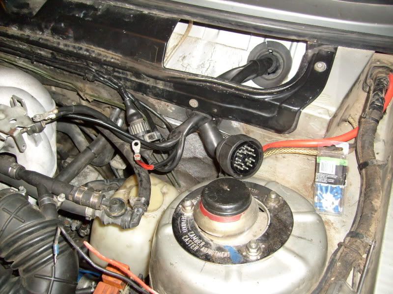

I came back to the rubber firewall plug which i then completely butchered to get it into my 49mm firewall hole, not happy with the way i finished it but its functional.
The rest of the afternoon was spent puzzling over the wiring loom and comparing notes on the internet, the last thing i did was tag up the e21 loom to figure out which wires were needed and which ones weren't, even cutting back the loom to see which black wire was starter and which one is tach, the thick one is starter and there are three other black ones to choose from in the morning.
I made the mistake of leaving the car side of my motronic connector in the 325i wreck when it left so i will have to cut up the engine side of the plug and cut the e21 loom long to bridge the gap.
