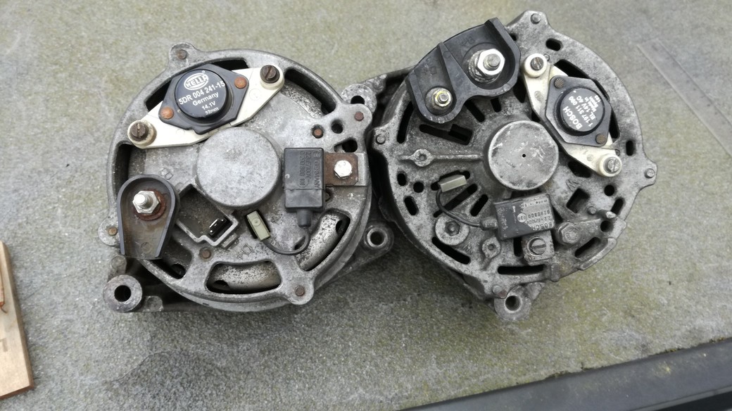

After some swear words i rebuilt the generator:
I am not sure where the wires have to plug in
I can´t get a new one so i am now searching a secondhand one!

wire goes on spade connector with red circle (marked D+), spade connector with green circle is for the capacitor (marked +), very nice work
see my left alternator/generator/dynamo:

I dont have this capacitor?!? Hm?!?
