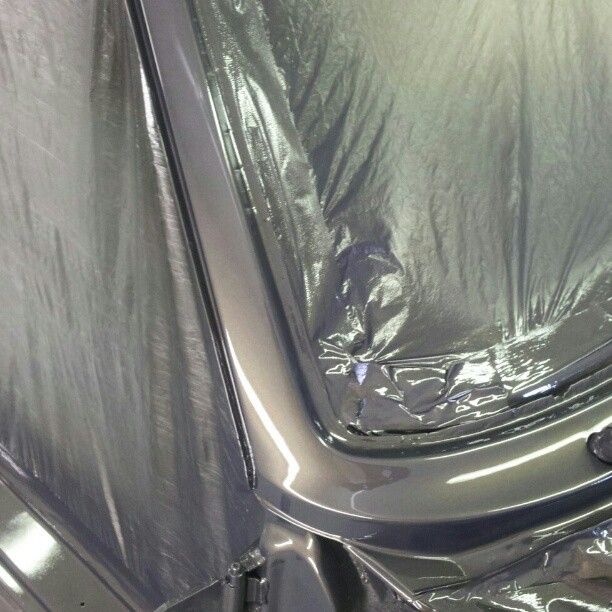

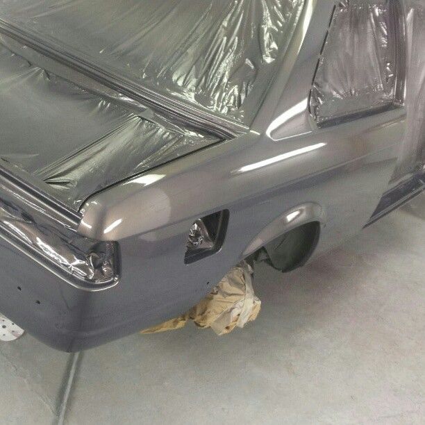

Hi guys just want to clear a few things up about The paint.
2K is not banned in the uk!
what they have tried to ban in solvent base coat, the reason is the solvents and the environment (basecoat is 50% thinner). Not for the health of the painter lol
This has been replace by waterbase basecoat (colour). this is a lot better now that it used to be, still not as good as solvent. But solvent base coat is still available and is what is being used on nas's car.
All professional laquer is still 2k ( low bake or new ultraviolet drying ) and no professional painter worth there salt would use 1k (cellouse).
Metalic's, pearls and the new xrillics are not available as solid 2k which is why CoB system was created.
All new cars are CoB.
CoB (clear over base ) is far easier to repair than solid 2k and will last for years (depending on laquer quality) I am using Lechler laquer on nas's wich is a high end product and is as hard as glass once fully cured and polishes extreamley well.
Malc

Where's the "Orange Peel" :loll
Nice job, what Clearcoat was used? :thumbsup

Nice colour

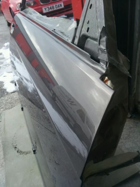

Very sexy, are these pics after wet sanding etc, looks very smooooth.
:) cheers old boy.
The door is sanded but not machine polished.. I'm off to see it on the weekend. Can't wait.
