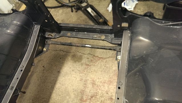

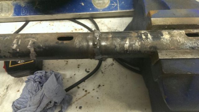

so i went ahead and made my own front chassis reinforcement wunderbar thing, i had this transmission tunnel brace left over from an e36 i fragged for an engine swap and realised it was probably a good idea to chop it and use it as welding practice.
dont laugh at my welding its my fourth ever time - but im happy with it, i was a bit eager with the flap disk but meh im not too arsed about that.

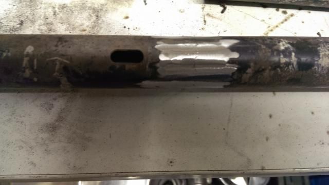

this is how it looked when i ground down the weld (i had to put the welder on fairly high to get penetration as the bar is a fairly thick grade)

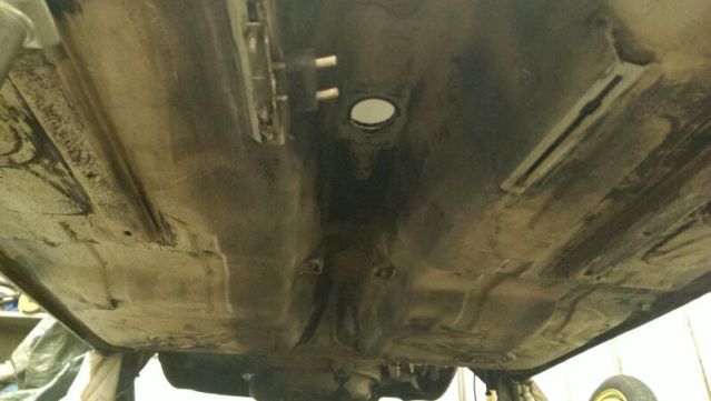

i forgot to add a pic of the underneath - i missed bits but i blame the lance of the steamer being too long and an inability to get the car high enough. im planning on getting a smaller steamer but i think i might hold off that cos with a good soak of TFR / cillit BANG and some elbow grease i reckon the the remaining crap will come off
in position..

Nice! That bar can be a good upgrade for any E21 I guess, might even be able to use the holes from the arb. Nice idea for a groupbuy perhaps?
Lol i aint got time to start making 50 of them! but you can get these easy from a scrap yard. Simple case of measure twice cut once and weld it back together.. theres two holes either side (right size holes!) and the bar is v.strong. im not even sure its going to clear my front pully but thats easy to solve with a spacer...

looks good mate, what diameter is the bar?
Practice makes perfect, not everyones welding is perfect all the time,
You dont think i post the bad ones do you??
I started when i was around 14 with a 240amp oil cooled stick plant making gates and railings on the farm from old scaffolding tubes!!
flattened the end with a sledge hammer, fill any big gaps with a 6" nail and away you go! you know you had a good one when the slag curled up off the weld, wire brush and your done.

If you are making any framing up, tack it all up both sides, alternate sides ends when welding.
if its not jigged or tacked up, as the welds cool they shrink.
some times you can actually feel the part moving in you hand as you weld.

The bar i used is about an inch i think its 2mm gauge, i have a couple of little holes to fix on the inside side of the sill where the rear beam mounts, but the biggest head scratcher is working out a nice way to reinforce the area where the diff mount is. I havent really ever done a job like that before really - so i have been looking at how others have reinforced sections - got a few ideas.
