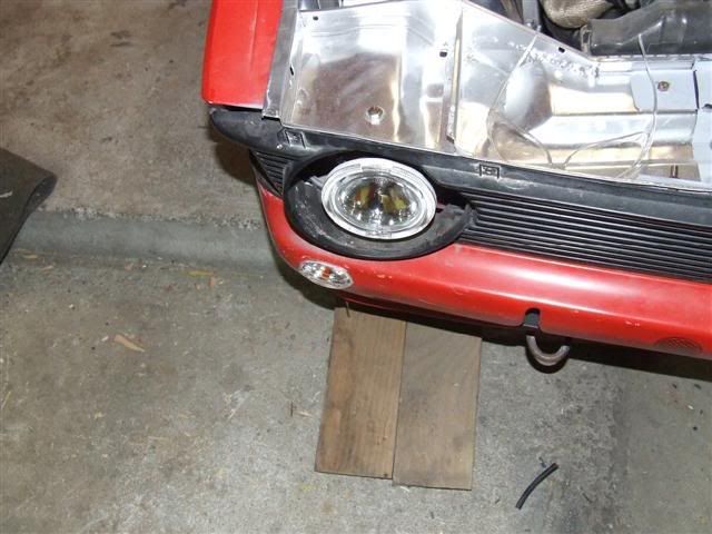

i had a long hard think about my front indicator setup, and have decided to blank off the original indicators and have added some small oval 'clear' indicators into the front 'bumper'. Also, i was planning on running with no bonnet, but due to the clamshell style of the e21 bonnet iv decided to get a bit religious and keep it but with a massive hole cut out of it (or, make it 'holy' lol). it sounds rediculous, and kind of is, but i dont think its too pimp-my-ride-ish. photos to be added next week...

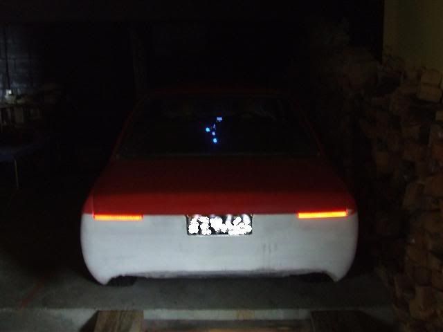

lastly, im rapt with my halo-style headlights. iv wired them to the ignition so that they run all the time, as with my LED tail lamps.

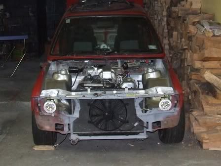

after four and a half years in the build, i finally drove the 340i. the road was a bit damp so it was spinning up pretty easy in most gears.
it was great.... and slightly emotional
