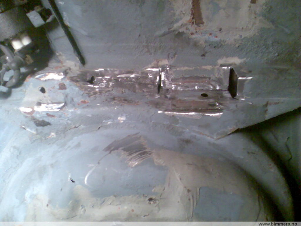

Have start fitting the diff now. Gearbox tunnel finished.
The subframe is made and this show how mutch I got to cut to make it fit.
The last modifications I made to e30 diff on e21 where fine,but this time i try something new.
I am going to use the original e30 fitting on the diff cover,and make new brackets on the car.
The last car i made the diff fit the car-this time i build the car to the diff.

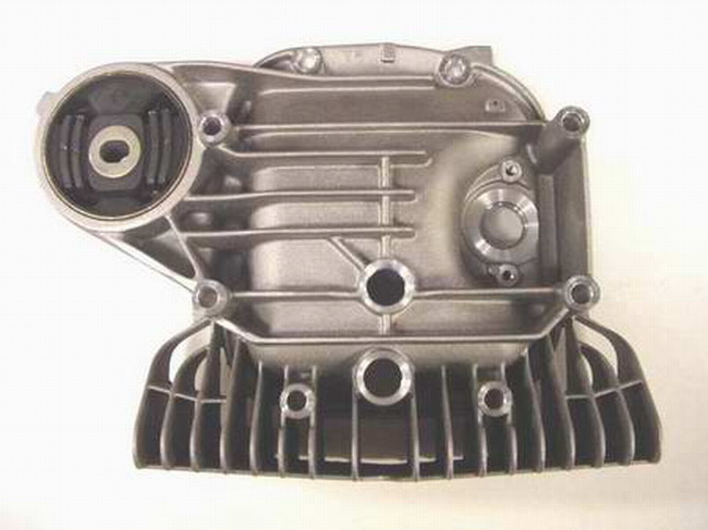

By doing this it will also be easier to find a better diff cover and better mounting-like polyurithane.
Like this for better cooling. Same design as the e21 alpina.
I am still going to make another subframe,i will take pics on the building for these who`s interested.
