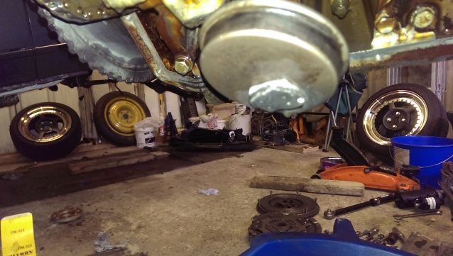

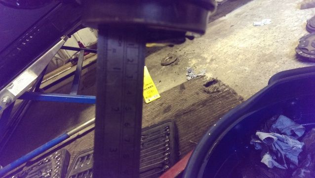

When I had the sump modified it turns out the pickup pipe was the wrong length, its very close to the bottom of the pan, although it isn't touching it so some oil was getting round where was only a few mm of clearance when I needed a good 10mm. when I took the sump off I found tiny flecks of metal in the sump so I think I may have destroyed a bearing, if the US Spec cams are scored then I will be so :wtf, I will have to take them out to check them properly, im actually a bit scared to look lol.
You know for the last few days I haven't been myself, I cant seem to get rid of this disheartened feeling, I only get that when a mistake is made that I could have avoided. Before I put the engine in i should have measured the clearance. then I could have had it fixed before it came a problem.
Rest assured I have learnt a valuable and expensive lesson, always double check stuff you have had fabricated when it comes back. What I think happened is that the fabricator must of not lined up the spare oil pump I gave him very well or maybe his jig moved when he was welding?

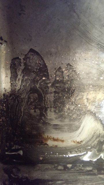

This is the debris i found in the sump, there wasn't any bigger bits then this i think this is bearing material from the colour of the flecks.
modified pickup

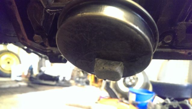

I stuck a 10mm thick block of old claybar i had on the bottom

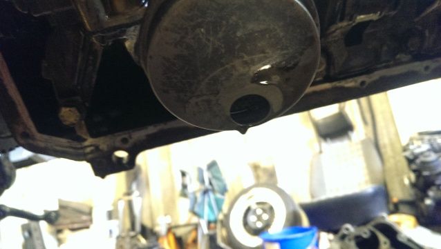

here's how it looked when i stuck the sump back on
