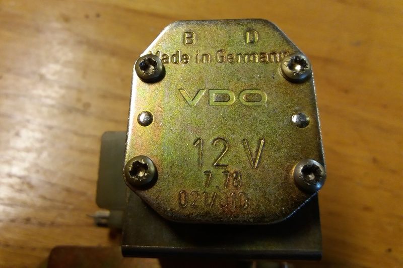

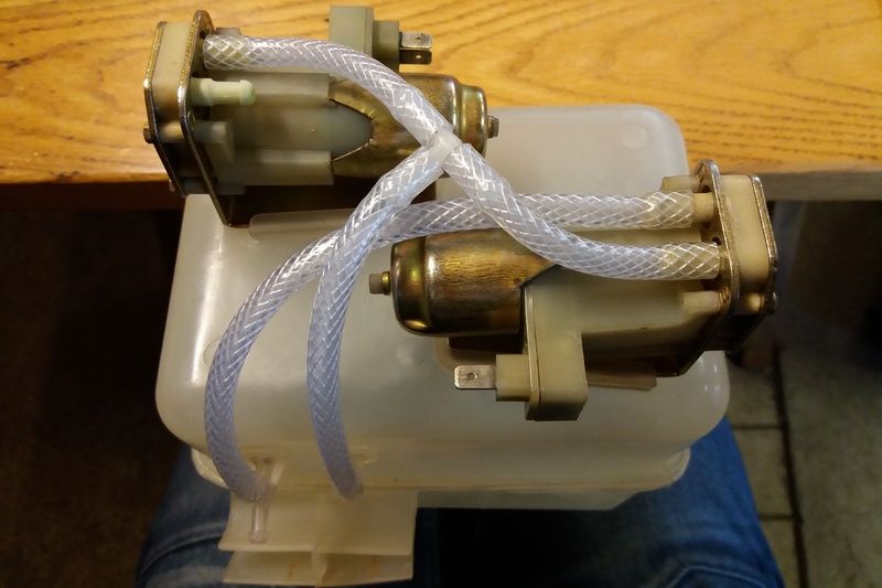

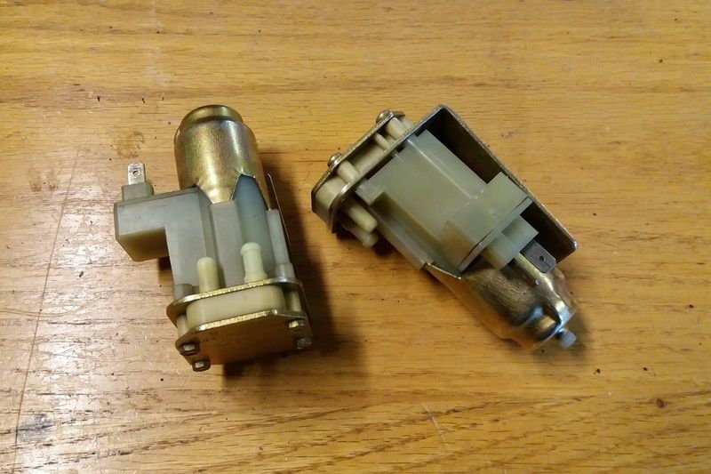

Anyway, without further ado, here we are again. I assembled the screenwashpumps. All nice an yellow again.
Like the car these pumps are dated 1978!

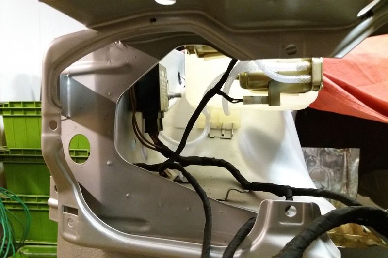

Back on the reservoir.

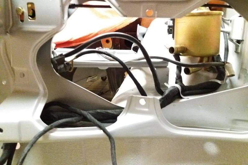

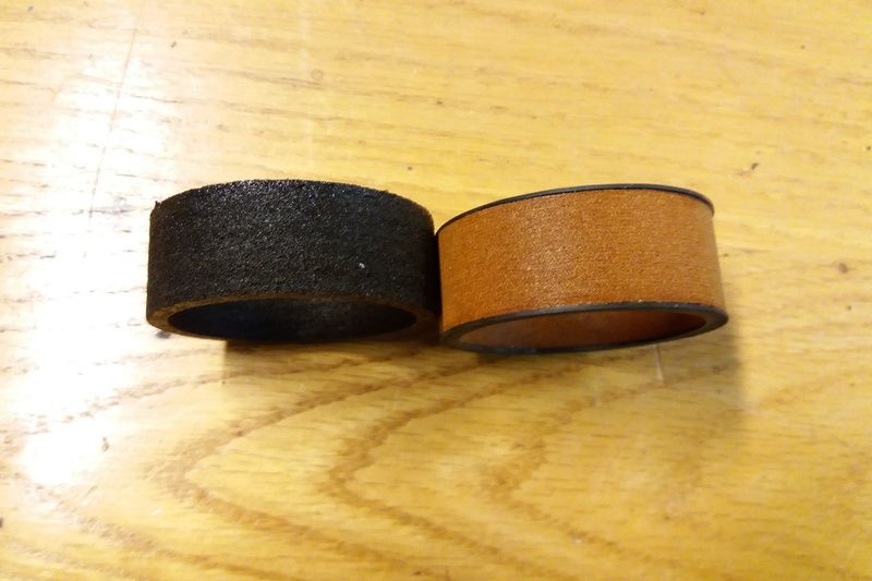

New filter in the reservoir of the powersteering. I wonder if the old one is factory original. It sure is dirty.

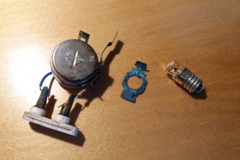

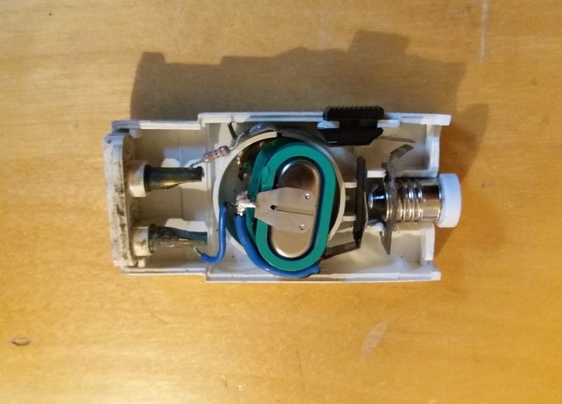

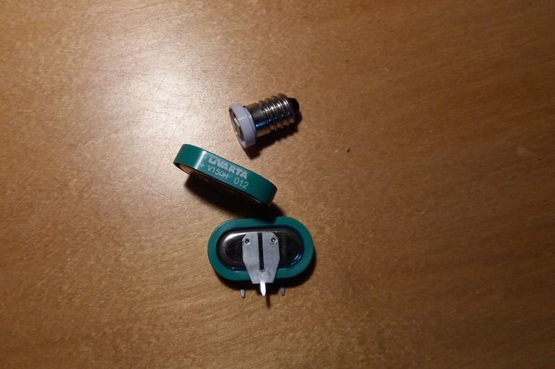

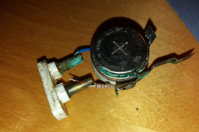

And I took apart the little flashlight. All corroded inside.
So, cleaned, new batteries and a LED light with E10 socket.
Soldered together.
It charges and lights, so a successful operation.

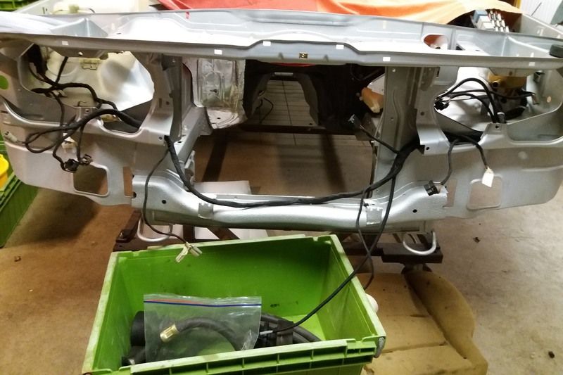

March 2017 I worked on some detailcrap.
Like new polyester tape on the wire harnass.

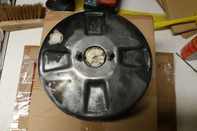

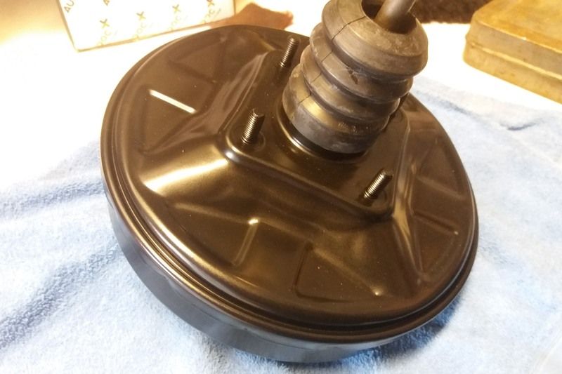

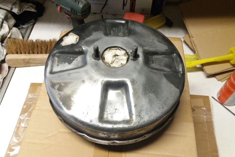

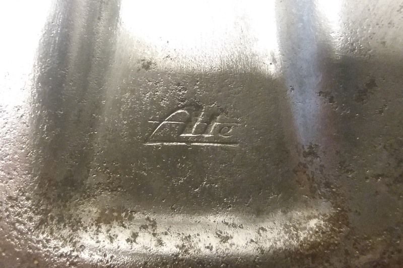

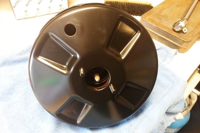

And then back tot he brakebooster. The old one was alle corroded on the inside and that’s why I tossed it. New one looked very clean and healthy on the inside. But the outside….
Needless to say that it needed some love and attention. Didn’t like to sandblast it, because that shit gets in between every moving and non moving part. So sanding and Rustico gel.
I knew it was an Ate, but didn/t kno wit was stamped in the surface.

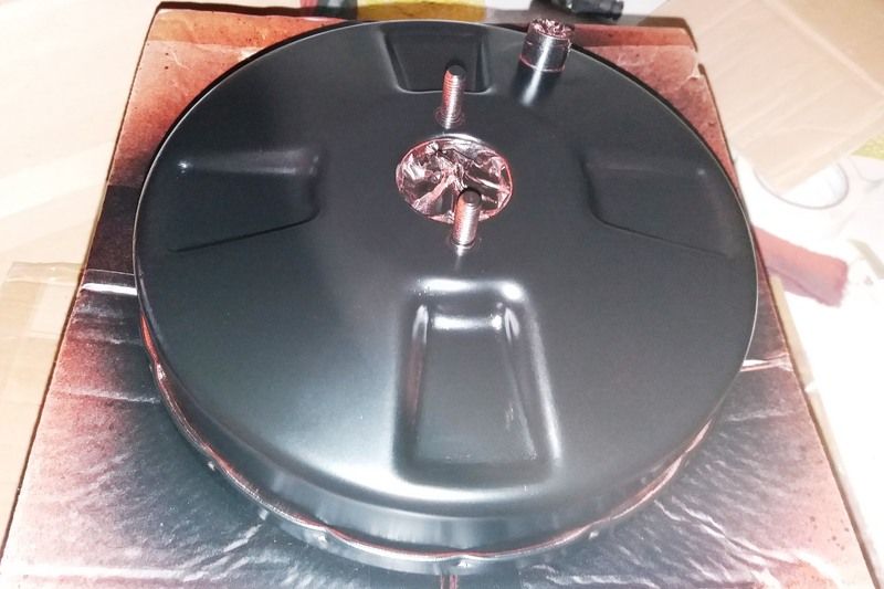

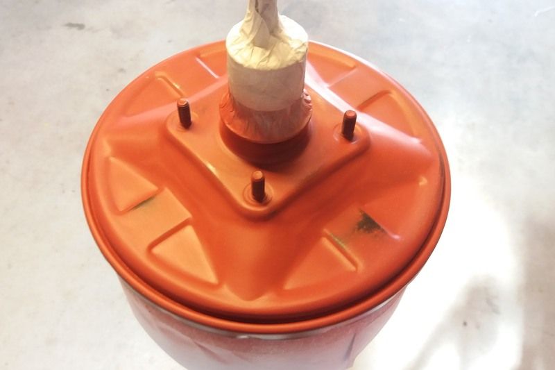

So first a round of rust preventing primer
And a few layers of semi gloss black.
