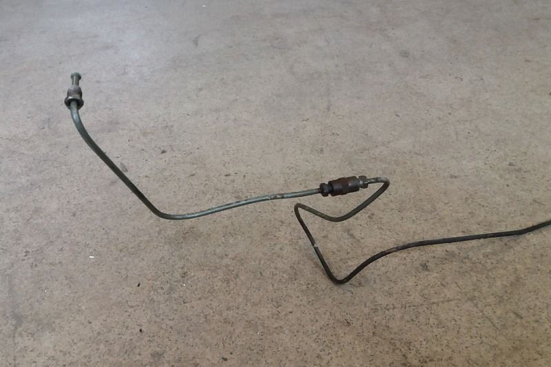

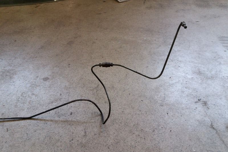

The new brake lines, 4,75mm in diameter, was placed underneath the car. I could not understand why the one to the rear of the car was to short. Since it was a 100% copy of the original… It turned out to be some 30cm or one foot to short.
So I got the original out again and fount in the crate a short piece, with a connection. That was the missing piece. But why??

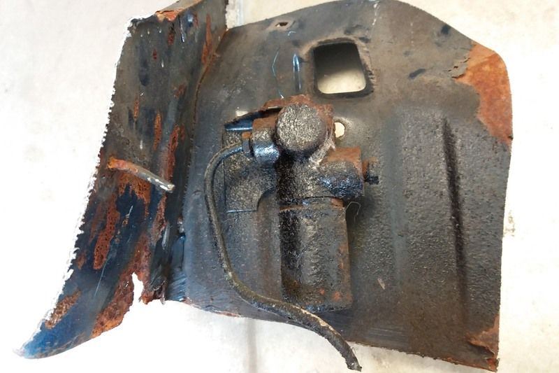

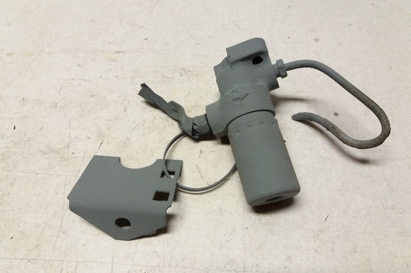

Looking at pics of other cars learned me that there was some kind of thing were my line ended. Research showed that BMW, about one year after my car was build, had started to put in a brakepressure devider. A stronger brakeaction had lead to a overtaking rear of the car. So the came up with this solution. Since I fitted adjusted e30 brackets, I have more stopping power there. Reason to find that thing.
Here is a piece from a donor.

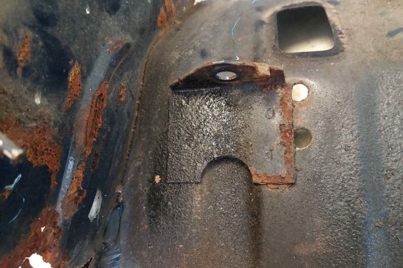

The distributor is bolted onto a bracket that is spotwelded onto the innerwing. Well, there will no more welding on my car, but first I’ve taken it all apart.

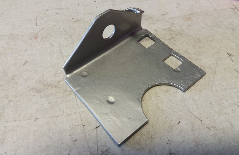

I sandblasted it, drilled two holesthat fit two holes in the inner wing (don’t know why they are there)

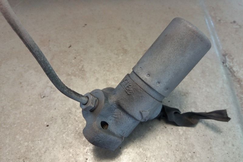

Devider sanded
And zincsprayed
And painted in the exact Até colourscheme

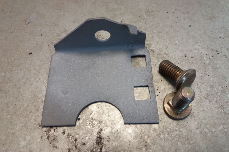

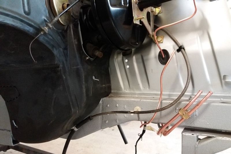

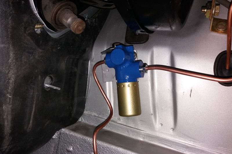

And the bracket polaris
Put in to place

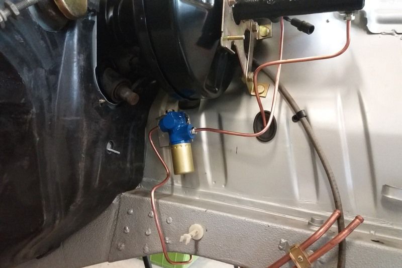

The last piece of brake line fitted onto the MBC!
