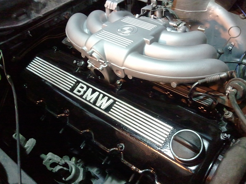

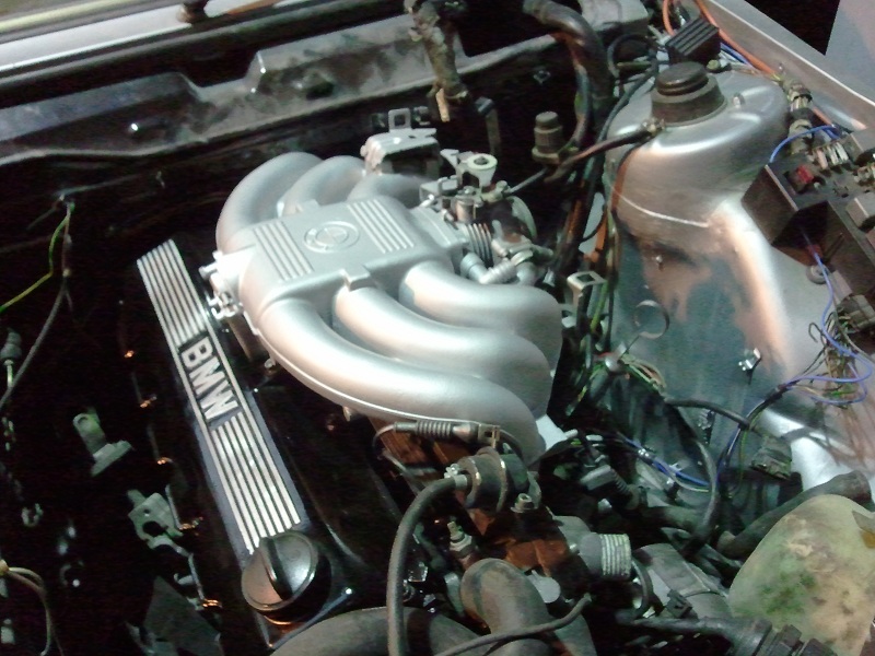

There's been a bit more progress, sorted most of the wiring except the coil wires and spade terminals on oil switch starter and alternator. Bought a battery and got the battery stuff ready to go, just need to decide the final position and weld a bracket into the boot. All the battery cabling under the bonnet is sorted. Fuel pump wiring and hoses done, and I've started looking at the AFM mounting situation. Gave the top of the engine a bit of enamel as shown in the pics.
