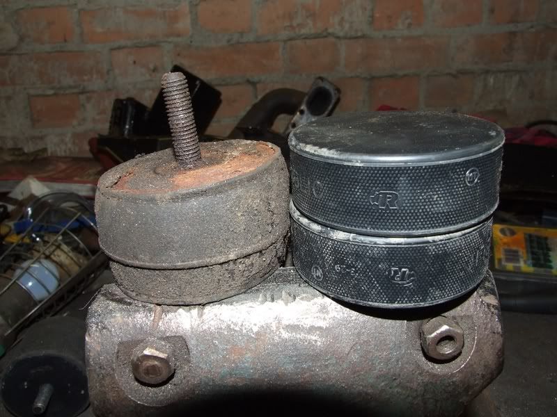

My new engine mounts arrived in the post
£9 for four. I could probably just drill them and fit them, but I'm probably going to get the pucks skimmed to the level of the E21 M20 mounts I used to create my subframe mounts. I need to drill them and get some M10 threaded rod (easily got on ebay) and they're good to go.

RE engine mountings - I have a load of hockey pucks which I'm sure to find a use for somewhere on the slug .
